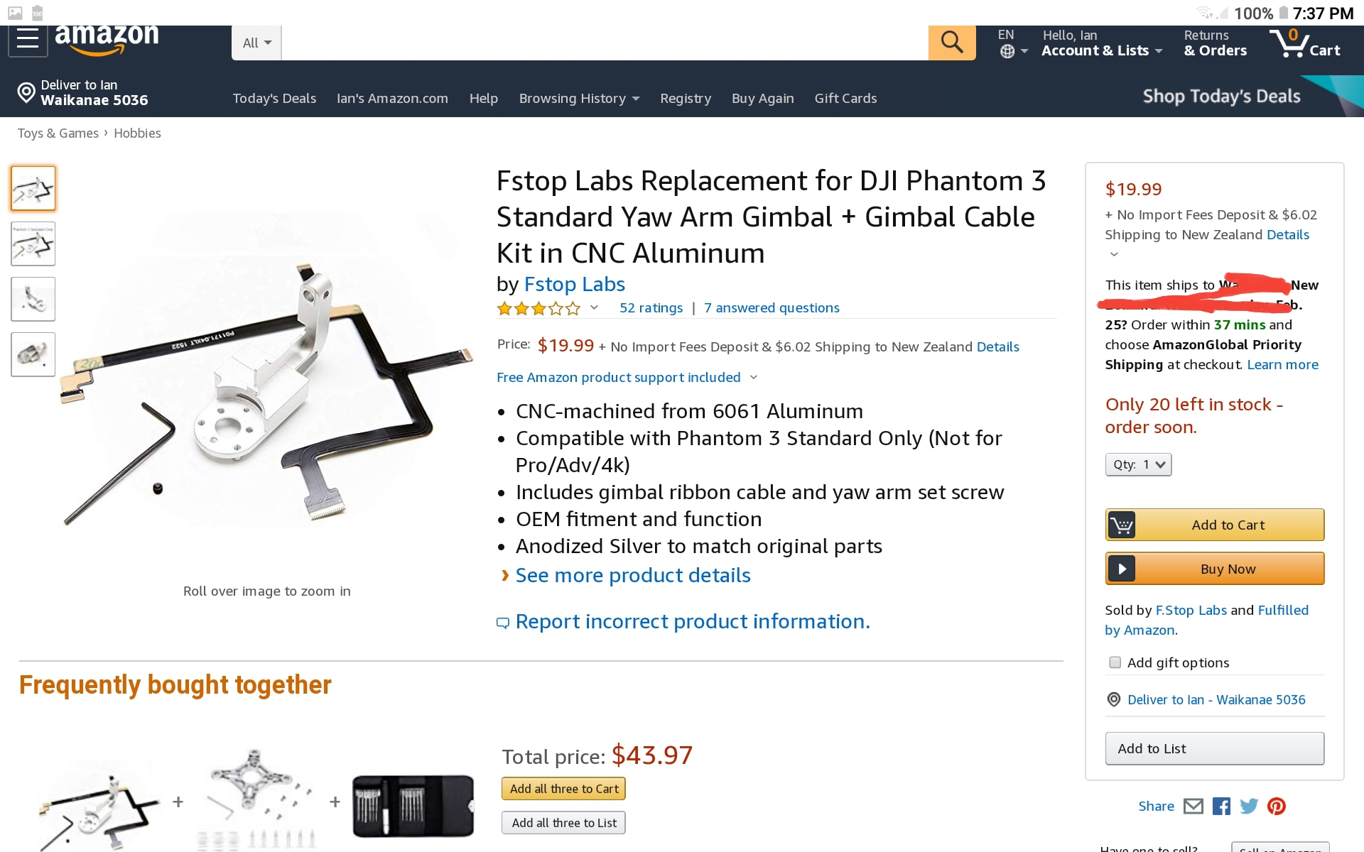

Google search brought some up for me from Amazon ,,,yes heaps of cheap ones about ,,it might have had power with test but needs to match the female side,,some cheap sets have a different spacing between conductor's so it might not contact the board 100% if at all,,if cant find one from authorized seller ,,do a search here at phantom help and you should find some

Google search brought some up for me from Amazon ,,,yes heaps of cheap ones about ,,it might have had power with test but needs to match the female side,,some cheap sets have a different spacing between conductor's so it might not contact the board 100% if at all,,if cant find one from authorized seller ,,do a search here at phantom help and you should find some View attachment 117220
Hi, thanks for your reply, however I'm not sure it helps. Unfortunately there are heaps of sellers, but I need someone that comes recommended. That is that they have purchased personally from or know someone that had purchased from. Otherwise, I'm just crossing my fingers that I get that 1 in 10 non genuine ribbons that may work.
BTW, just out curiosity from the reviews of the seller you posted a picture from, it looks like most are saying the ribbons don't work. But thanks anyway. BTW, I noticed your from NZ. Do j you guys use Amazon much? Honestly I don't know to many people that use Amazon in Australia even though we now have a local Amazon site.
