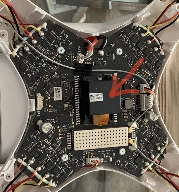

Did you take off the black cover that is held on by 2 tabs? See photo.
I initially tapped the black cover and it did not work. Had to take the cover off, then it worked.
