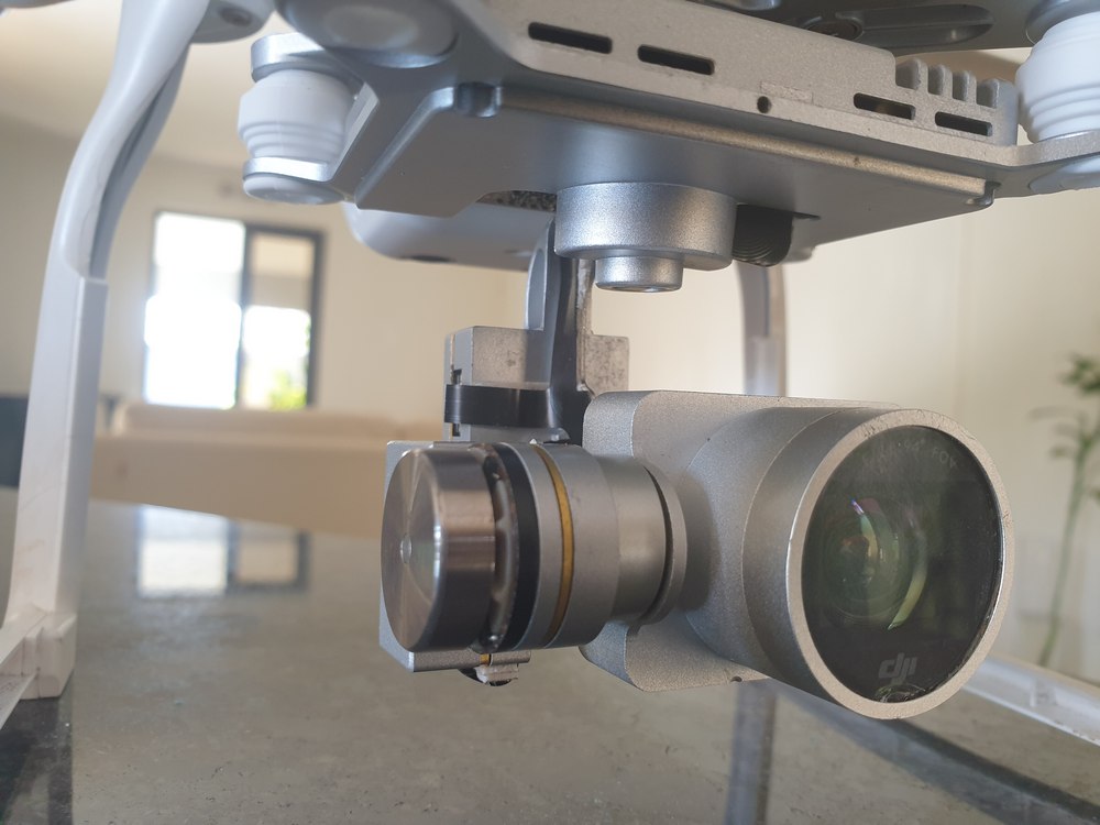

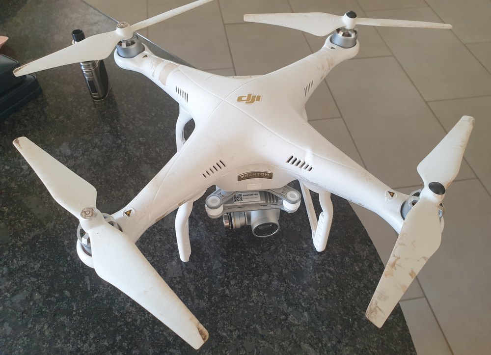

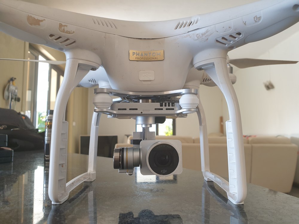

I've assembled everything back. Here are pictures.

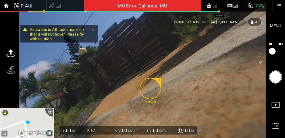

The error message I get is:

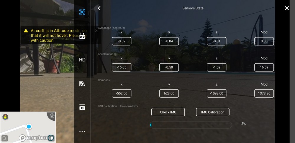

IMU Calibration will just stopped after some time :

View attachment 123011 View attachment 123012 View attachment 123013

Perhaps the accelerometer is stuck. Tapping on the IMU has worked for many here on the forum. Maybe you'll get lucky as well.
FYI - I don't see any anti-drop pins installed. Also, your shell is not fully clipped into place. Just a couple of things that stood out to me from your photos, though you may not yet be done with your rebuild. Also, is your UV lens cracked?

1. In the meanwhile I was able to sort out the IMU issue by tapping on it.
2. Yes it is not fully rebuilt. My rotors will start now. "Also, is your UV lens cracked?" > My camera is OK

BTW two of your propellers are not in the right position (the first picture). But perhaps it's for the picture purpose only because you can't fly like this.
