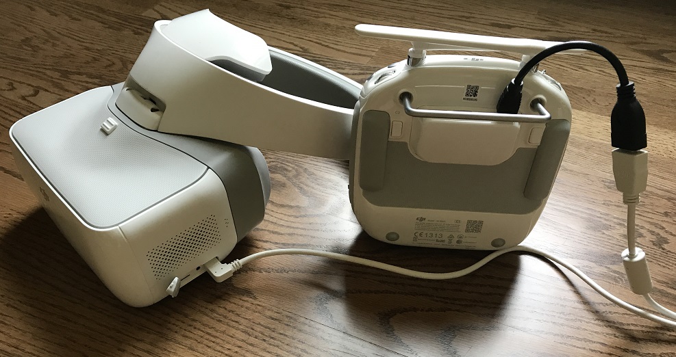

What is the script for flying p3p and dji goggles what kit is needed and i am aware that the p3p is still controlled by the controller and hdmi need to be added to controller what cables are needed and converters ?
You need to install the HDMI output module on the P3P remote controller like this. Then, use an adapter like this one to attach the cable that comes with the DJI Goggles to the HDMI output module.
many thanks msinger i have the Hdmi output module fitted already, and youre post confirmed what i would need have you flown the combination and if so what did you think of it ? i am thinking about upgrading sort of waiting to see what the phantom 5 is going to be like when it comes out . do hope the p5 will be wireless goggles too .
Yes (that's my photo above).
I really like the view in the DJI Goggles. The major downsides are the weight and size of them.
