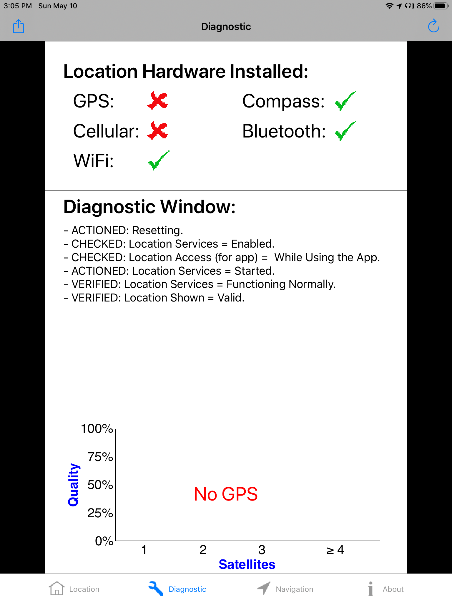

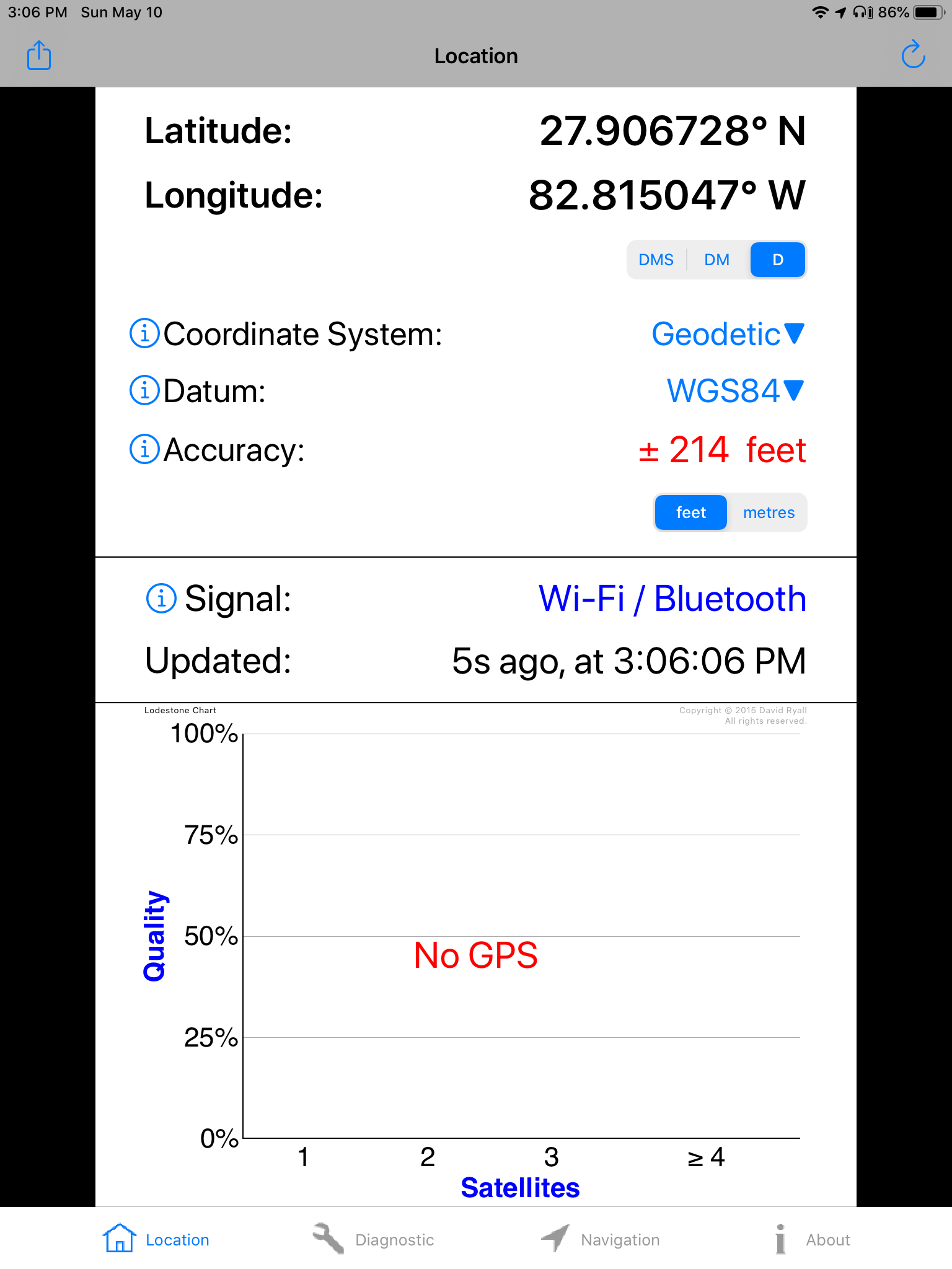

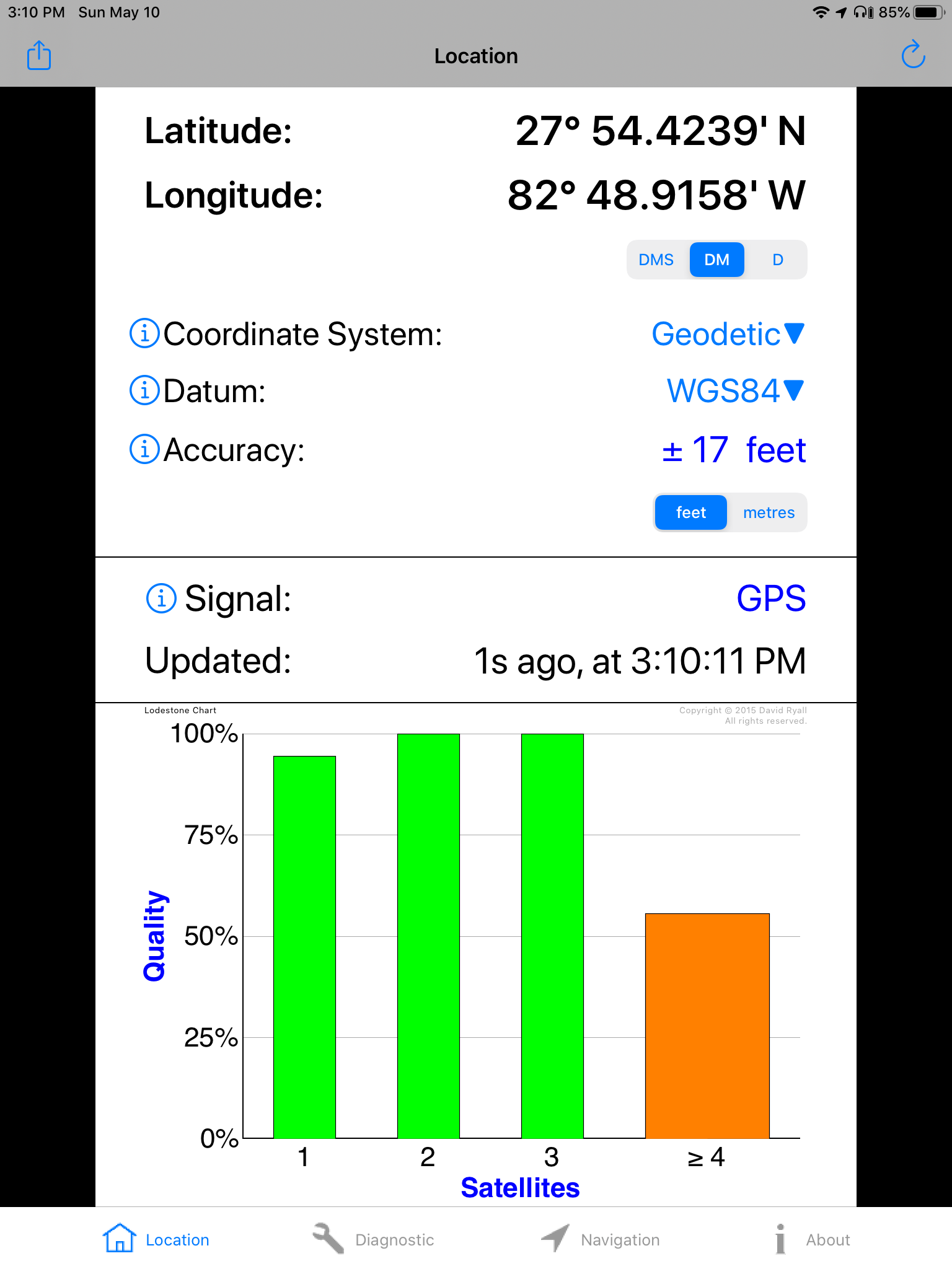

I installed a cheap app called GPSdiagnostics so that I could tell the satellites strength being received by my devices (iPad + mini4). Does not tell actual # of sats, just signal strength. 3 green over 75% good enough for follow me.
Good luck.
Note; my iPads not cell, Bluetooth to Garmin gps.

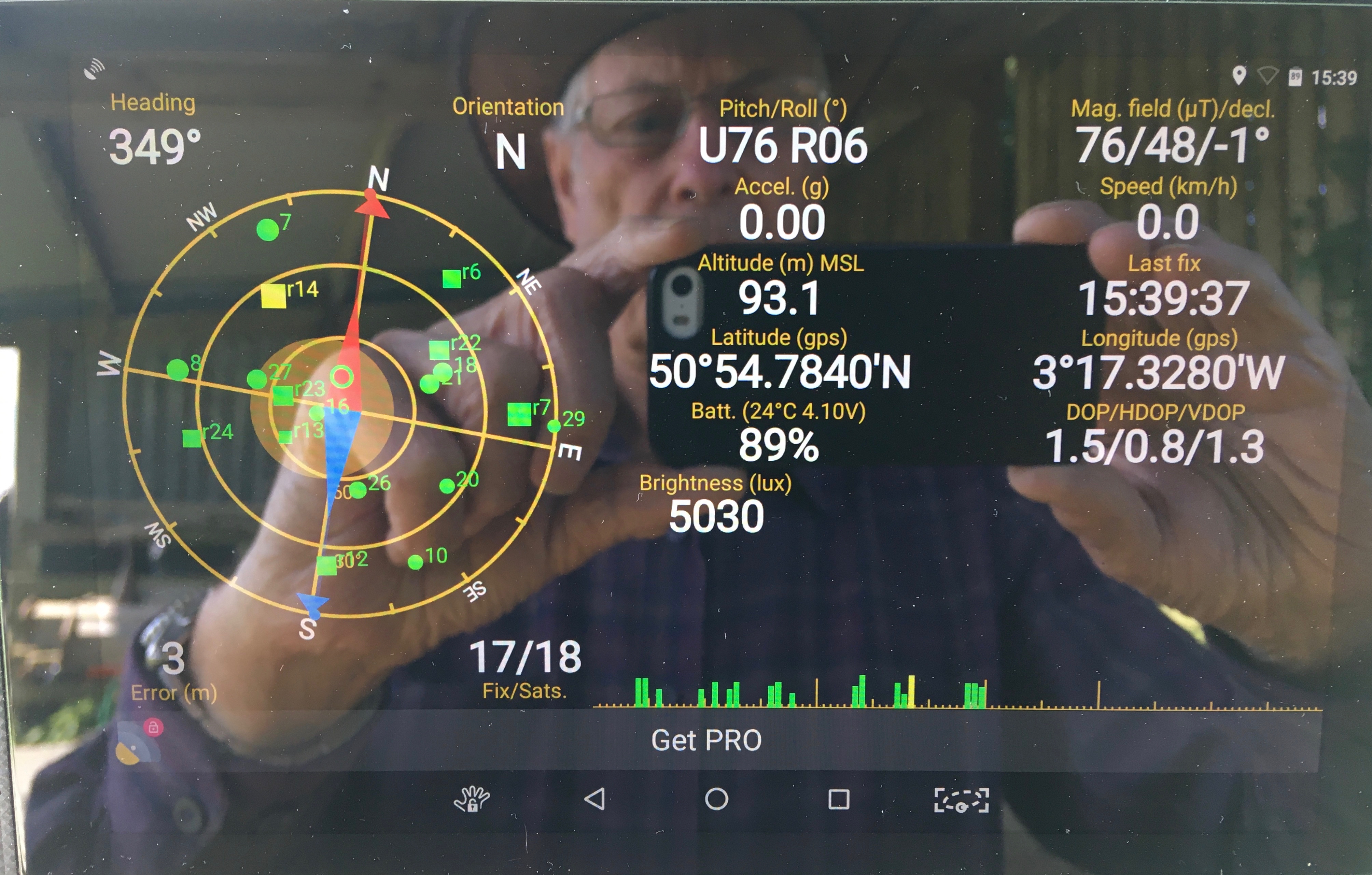

Here's one I use (called GPS Status) and the screenshot is from when I was flying with the Nvidia Shield
It's showing which sats are being received by teh tablet and individual signal strengths.
