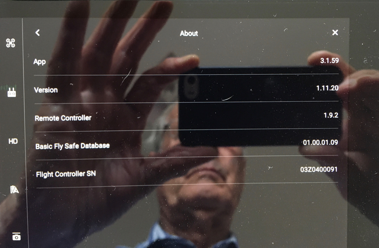

Would re installing the software make any difference? I think I'm on the latest for this model...........

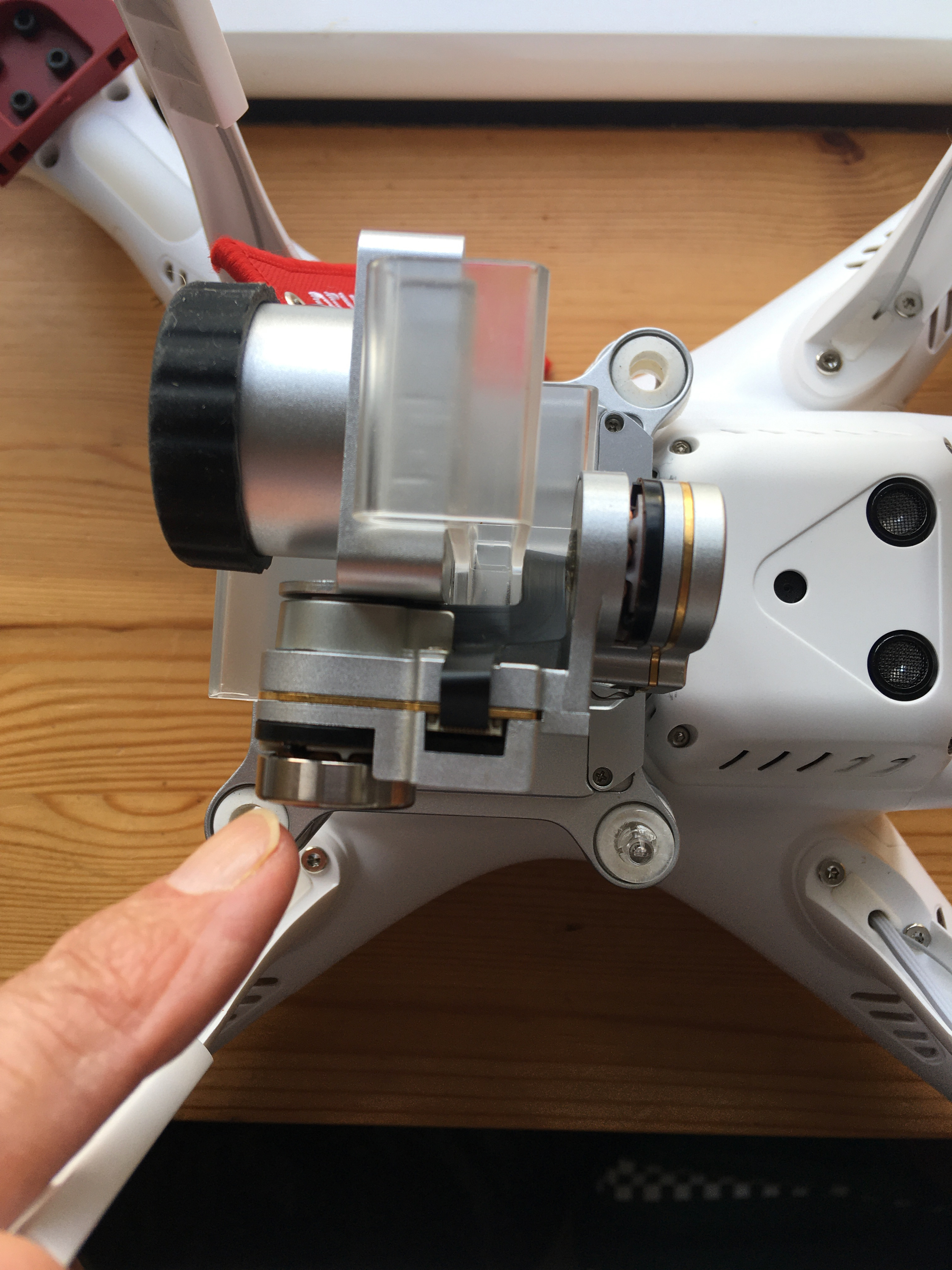

No error or warning message. Only noticed it when I went to put the gimbal lock on after flying!
I haven't added anything to the lens? When not flying I put a rubber protector on it, no filter??
