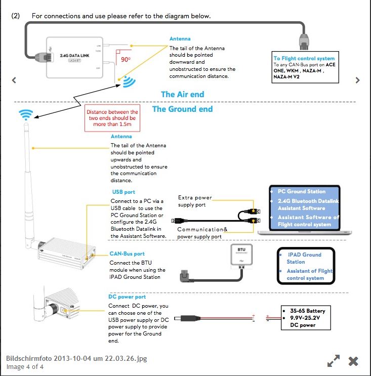

Okay... Does this mean you can use a PC (laptop) instead of the iPad? Do you still need the BTU if you're directly connected to the laptop via USB cable? This is confusing...

I still think this is only for the P2, not the P2V and whoever does the Facebook for DJI has got it wrong. The graphic doesn't mention P2V, nor the text, it's only this reply. P2V already has a data link via the camera, why would it need another? However, things may have changed I suppose and they couldn't do it via the app? Either way I don't want to shell out on parts that I don't need, or miss out on something I do - although I will miss out because I'm not buying an iPad or having to lug my laptop with me just to do waypoints if this turns out to be the case! I'm trying to get a definitive answer out of DJI via my UK dealer... he's going to ask the question direct to his account manager and technical contact in Shenzhen. Trouble is I think it's already sleepy time over there, so there might be a delay.
Right, I just got a reply to a PM I sent one of the DJI support guys on RCGroups. He's confirmed that the announcement is right in respect to the Phantom 2 but the response that said you'd need a BTU for your P2 or your Vision was not. Apparently the Vision doesn't have the appropriate hardware socket to accept the BTU in any case. He's letting DJI know to see if they can clarify the Facebook answer that triggered all this just in case there's something they haven't told everybody!!

P2 users need additional hardware for this upcoming release (and an iPad). The P2V waypoints flying has not been given a date or anything, it's completely unrelated to this announcement. I think someone has a slip of the keyboard in marketing or they think P2V is just a different version of P2. I doubt they have technical people updating their Facebook page on what is a Saturday in China which is why I believed it wasn't right info. Hopefully a clarification direct from DJI soon...

To clarify: The GS app runs on an iDevice (iPad for example). The app allows you to set waypoints, monitor & display telemetry & NAV, and issue commands to the autopilot. For aircraft without a datalink it's necessary to add it to both ends (add 2.4GHz telemetry modules), plus a means to communicate w/the iDevice (add BTU). Vision already has 2.4GHz telemetry, NAV, & a (thus far un-implemented) control link between iDevice & Vision over IP thru the Range Extender. So I doubt Vision owners will need to purchase any additional hardware, just download & install GS for Vision whenever it's released in the App Store or Google Play. Keep your peepers open & we'll know soon enough.
