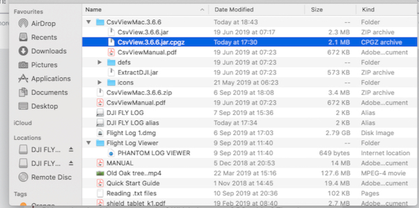

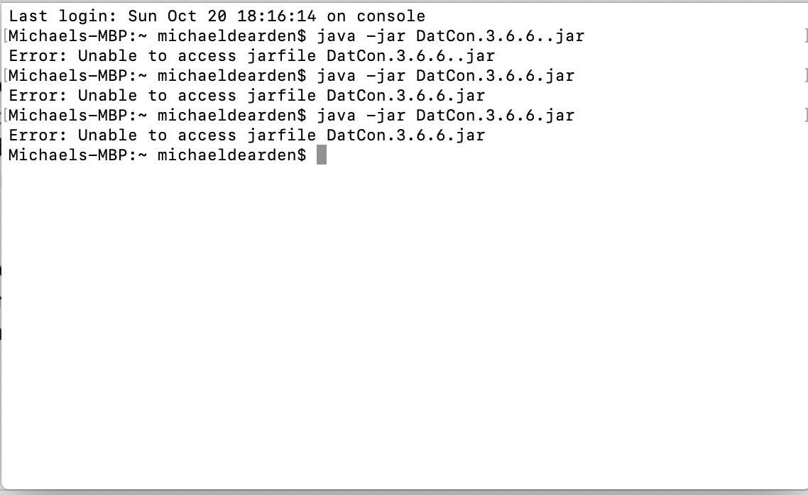

I'm running a Mac. Using Terminal I get:
just error codes.

Ah, I don't have a DatCon, just CsvView??
just error codes.
I managed to run these files before but don't remember going through this "command" business FD?

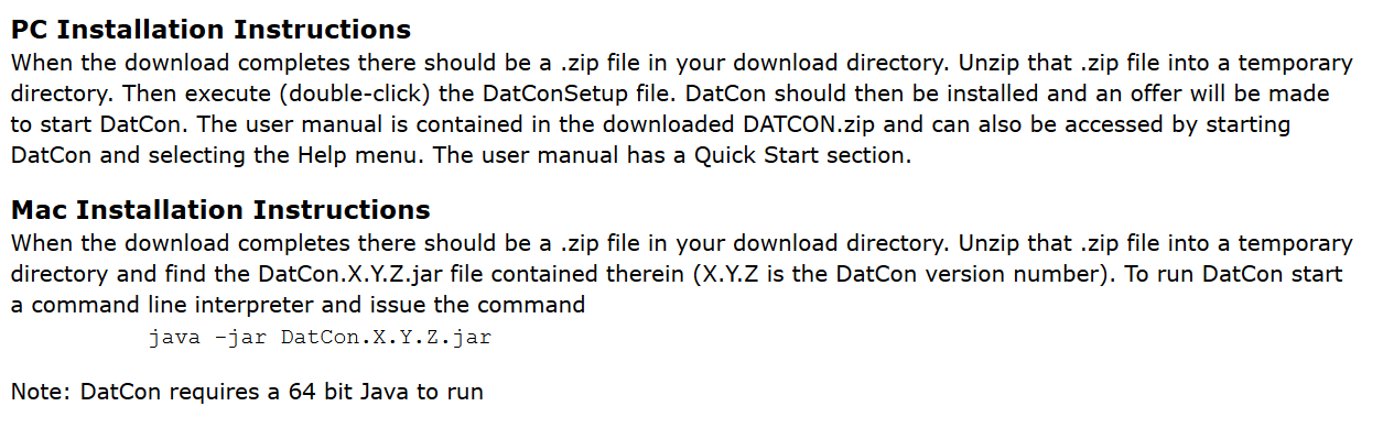

Looks to me like Terminal is not in the installation directory. Try changing directory to the installation directory and then enter java -jar DatCon.3.6.6.jar.

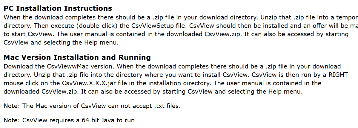

I have download the CsvView.zip, un zipped it and got CsvViewMac3.6.6.jar and that's it!
I understood that this was the "reader" for the .DAT files but when I click on it it just makes a duplicate of itself
Thc Mac intructions on the download page say to right click on the jar file... did you try that?

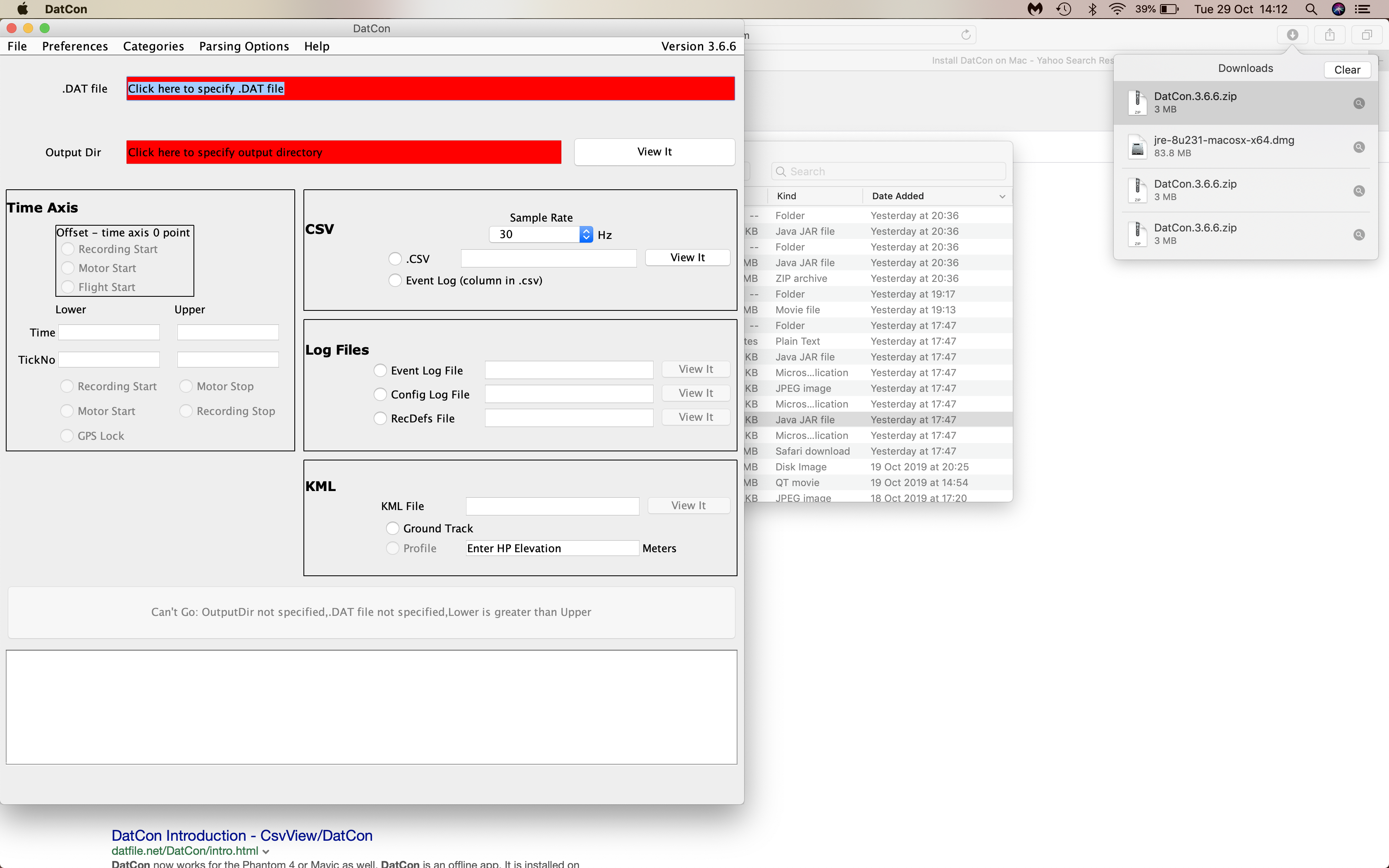

OK! Getting somewhere now I think.
I have re installed DatCon and Java.
I opened the DatCon.3.6.6. with Jar Launcher and I get this:
which I believe is the program I need to open the .DAT file???
Running the above program with a .DAT file inserted in the top line it converts it to a .csv file however, when I then run the CsvView program I just get an error message:

Try submitting the .DAT to CsvView directly. I.e. skip the DatCon step. CsvView will run DatCon internally.
