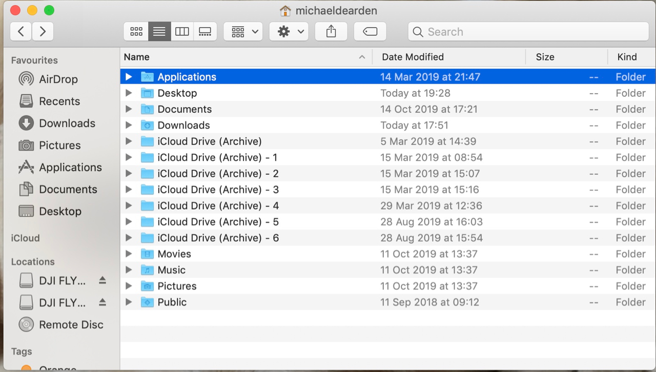

Right, this is my "home" screen - where would I find this file in amongst this lot?

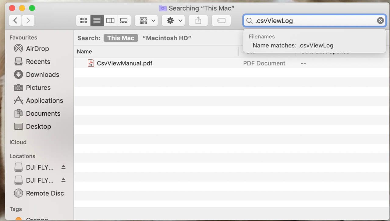

Hey Bud, I did a search for that file name on the hard drive and it doesn't exist. When would have been generated, from where?
It does exhist. Look for this file. It is case sensitive in search and don't forget the dot before. .csvViewLog
I don't know any more answers for you. As I said, it is not that important. Don't dwell on it.
This is the search I did of the HD.............
I have found a Fly302.config.txt file?

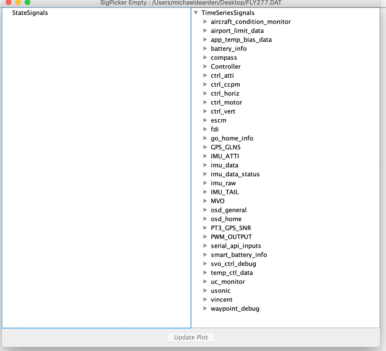

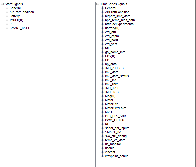

@cheddarman I am assuming from your screen shot that the MAC version is a bit different than the PC version OR this could be part of the Internal Error that Bud was looking for.
