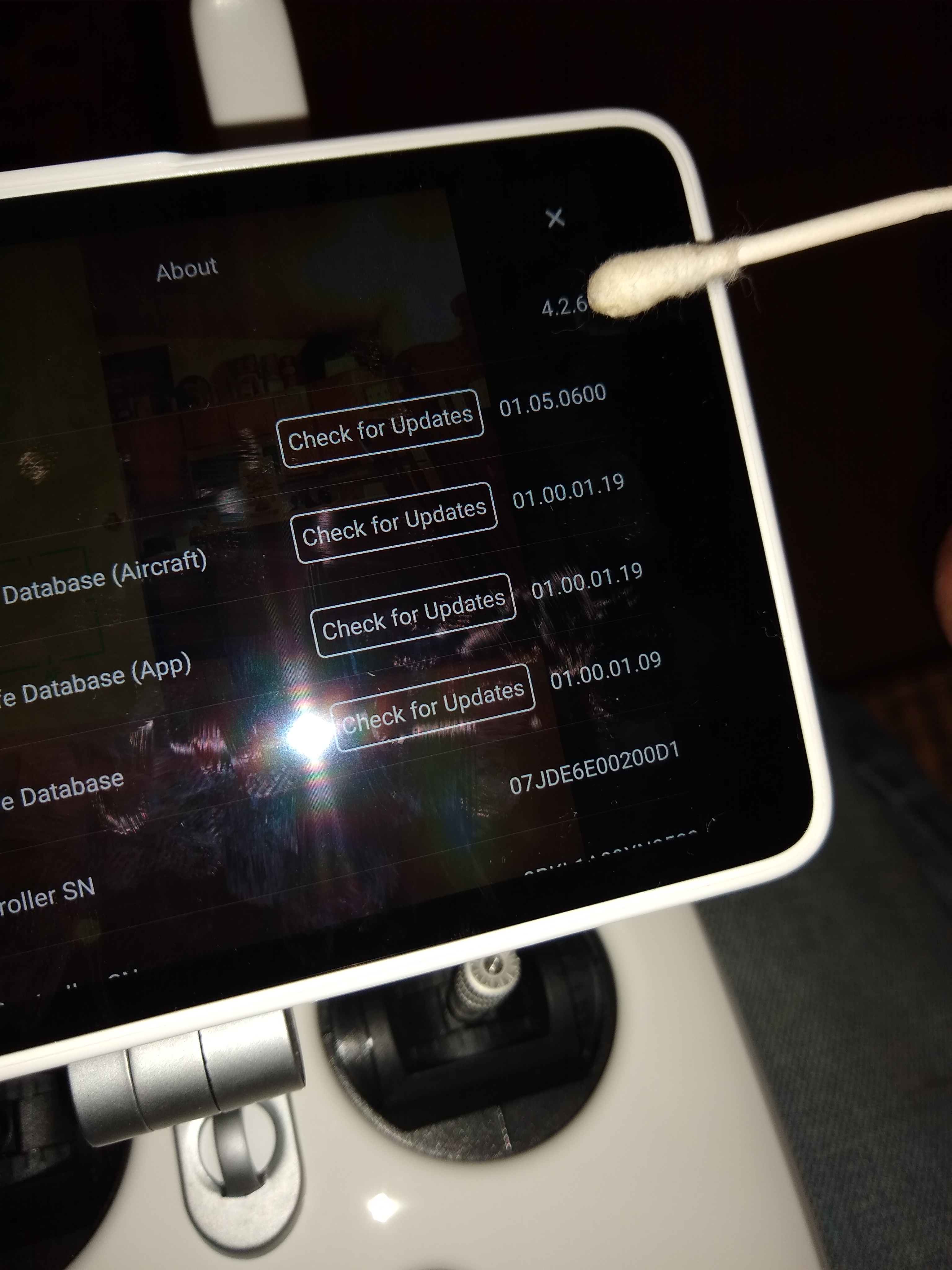

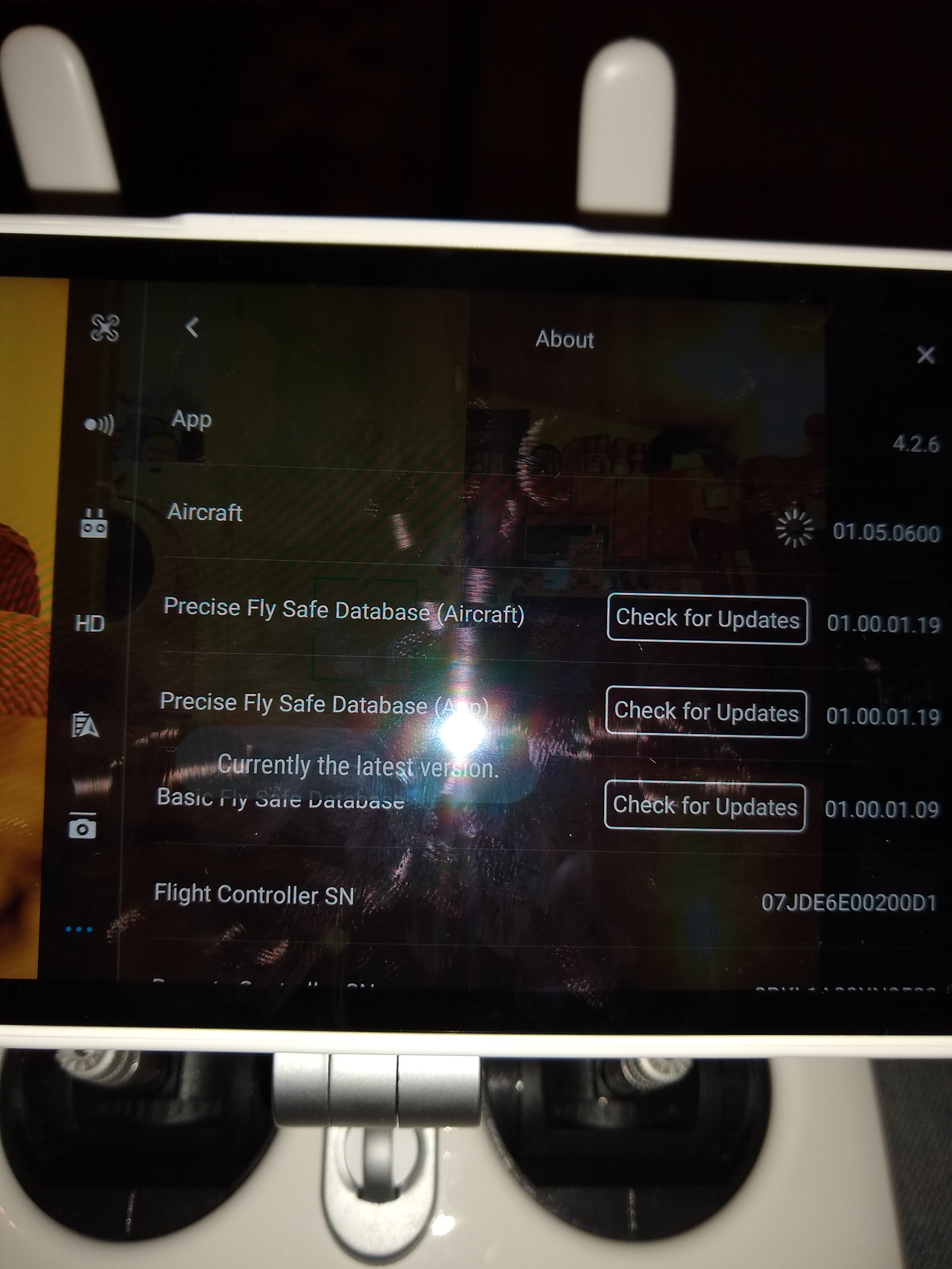

Does anybody know how to update dji go4 app on p4p+ controller? My maps are not showing and I'm on an old version but when I try to update it says I'm current, and as far as support through dji goes FORGET ABOUT IT!!

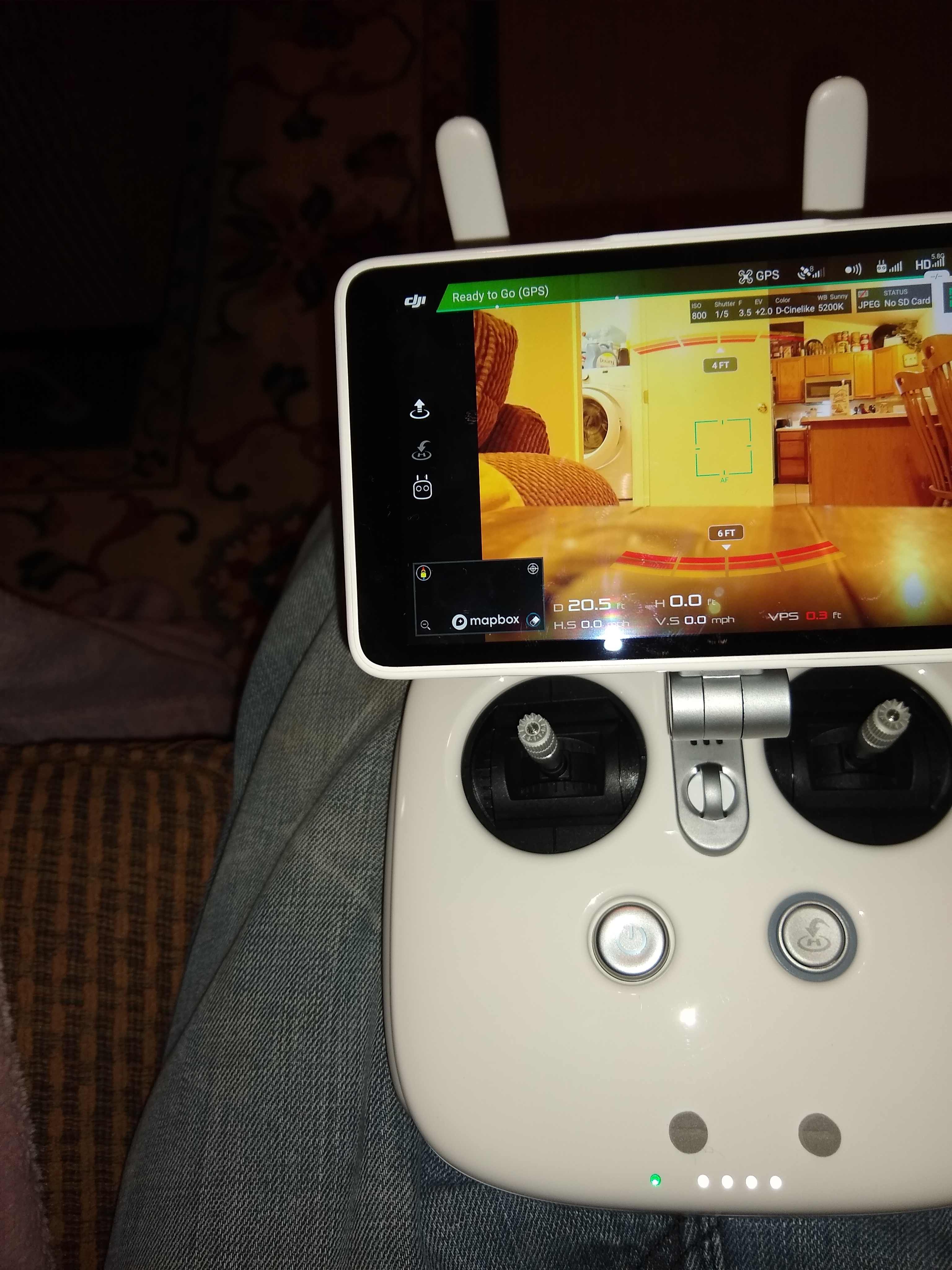

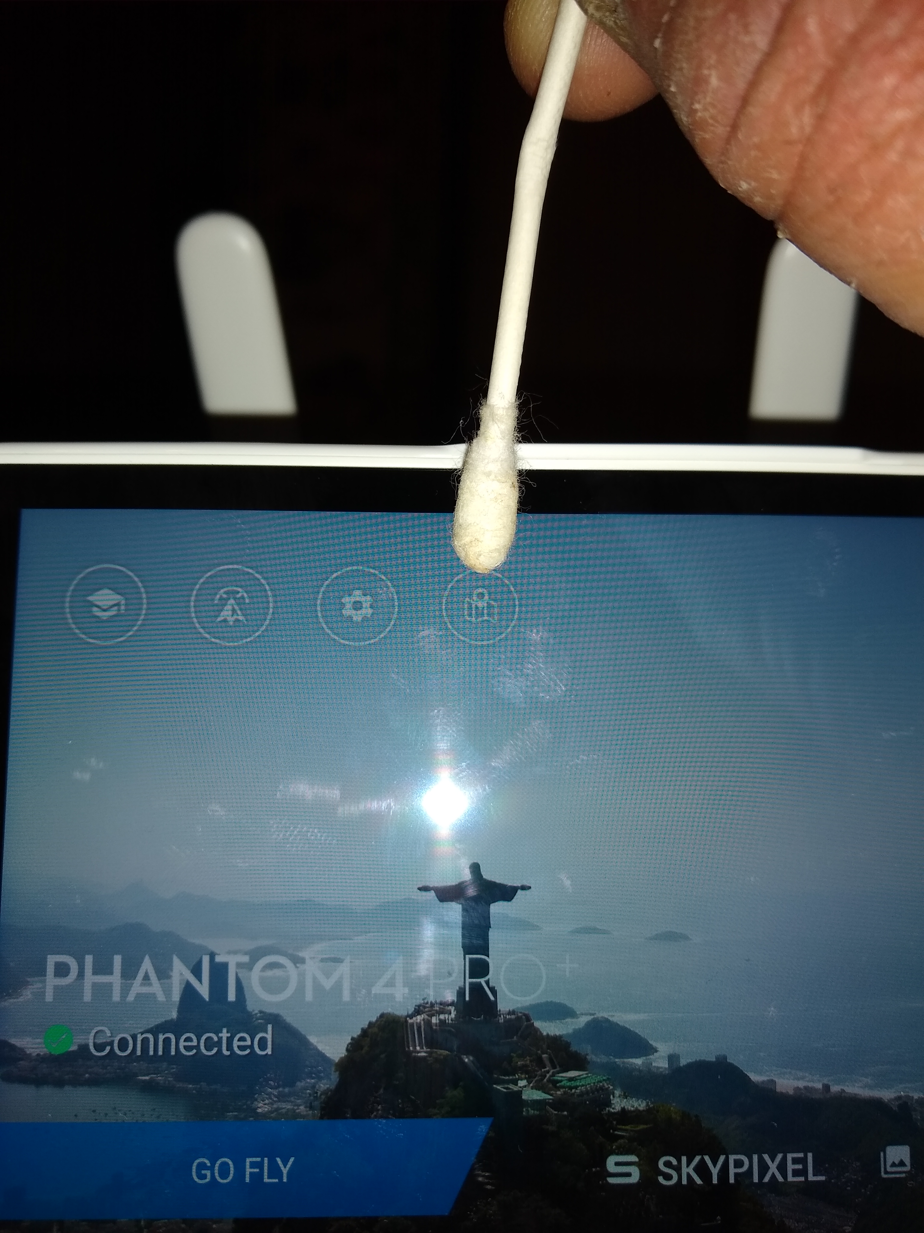

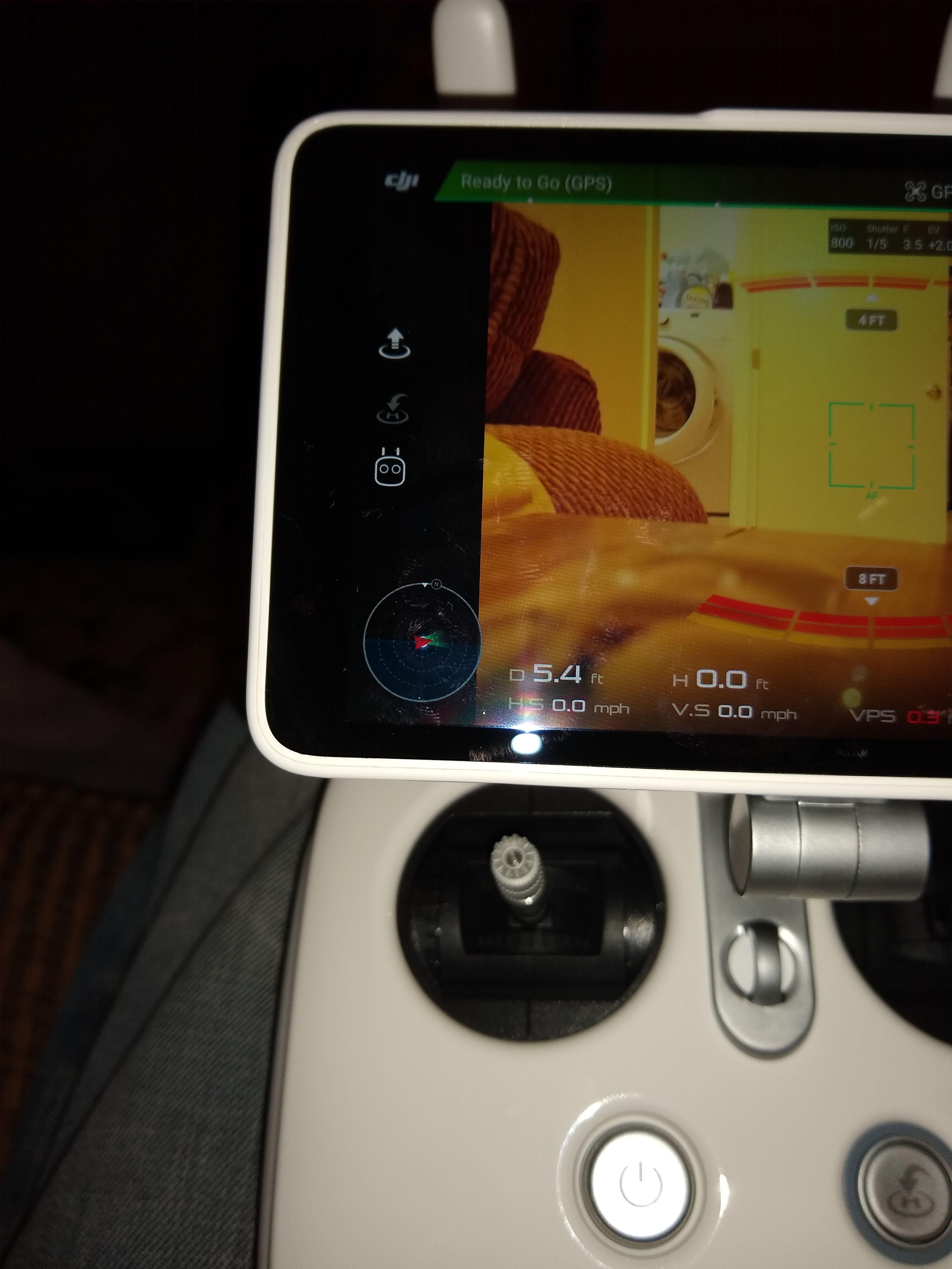

Ok well, when I'm flying no map of any kind will show up, the little compass with the N heading labeled shows up but that's it..I've tried all kinds of things to fix it and DJI SUPPORT kinda tried (not really). Even at the main menu when you can either watch the tutorial videos and fly the simulator there are 4 icons to choose from and when I choose the folded map with a navigational beacon thing on it, nothing happens.. let me set my stuff up and I'll shoot a lil video or some pics gimmi a few mins...I'm stumped man

It's basically brand new, I just got it, but I'm familiar with the phantom and mavic devices, I have owned a few and have never had this problem..everything is actually up to date and good but I'm running dji go 4 v.4.2.6 and I'm pretty sure that's why but it won't let me update
This is the blank mapbox that's been like that since I activated it.

Tap map screen and turn on location to enable GPS. If close to WiFi, maps will load.

Just loaded maps on mine at home, after turning on location, so not sure what's up. Make sure you don't have China listed as home. Some come that way and must be turned off in General Settings.
Have you connected your controller to your home wifi and downloaded maps?
Or if you are using your phone as the hotspot, you must make sure the controller is connected to the phones wifi hotspot output
