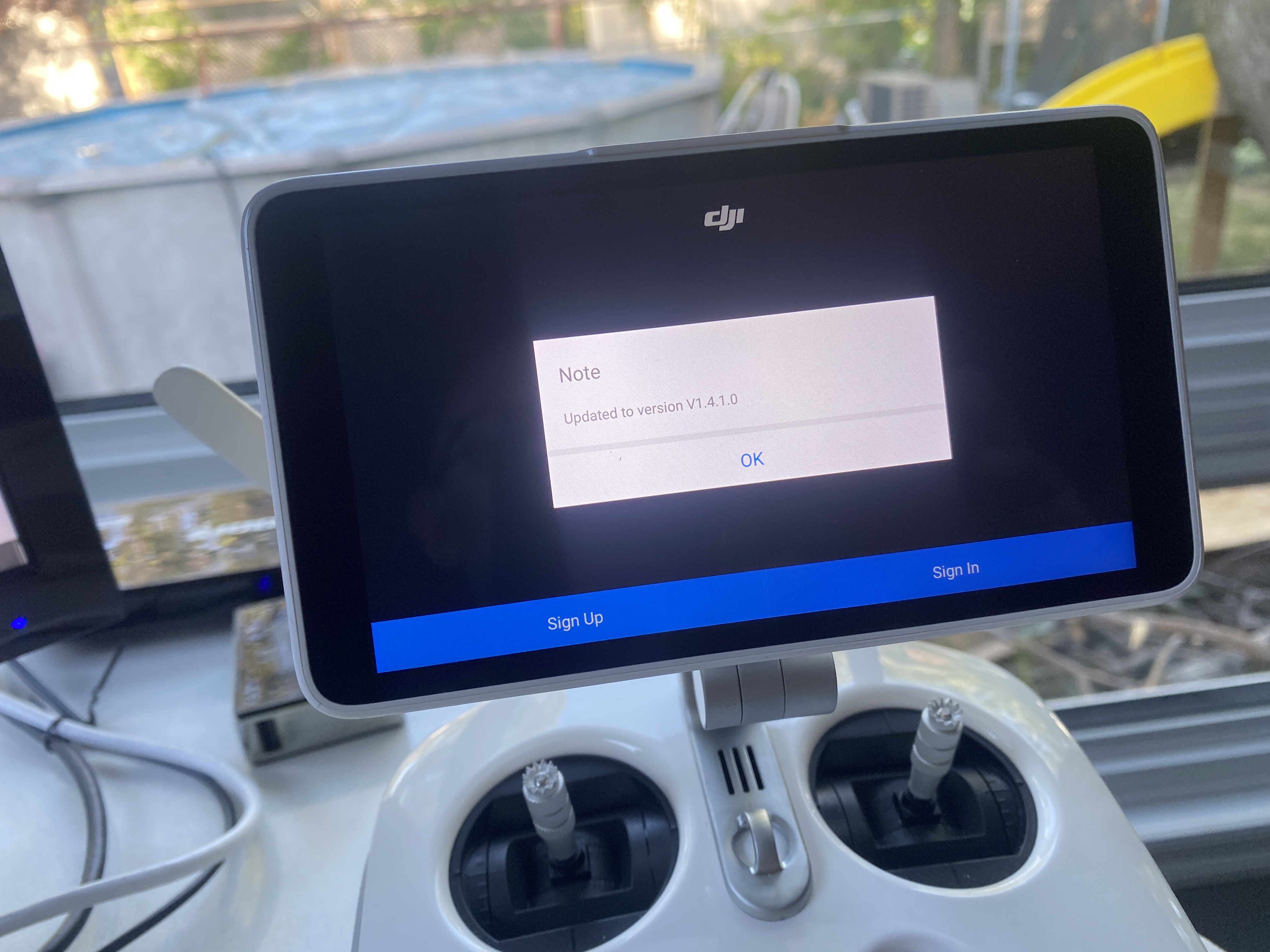

I found a fix that worked for me posted by Jeffdevs titled: "FIX for p4p+ no maps"
It used a download file to fix the issue of the frozen app.
You guys are all great on this site and I really appreciate your assistance.

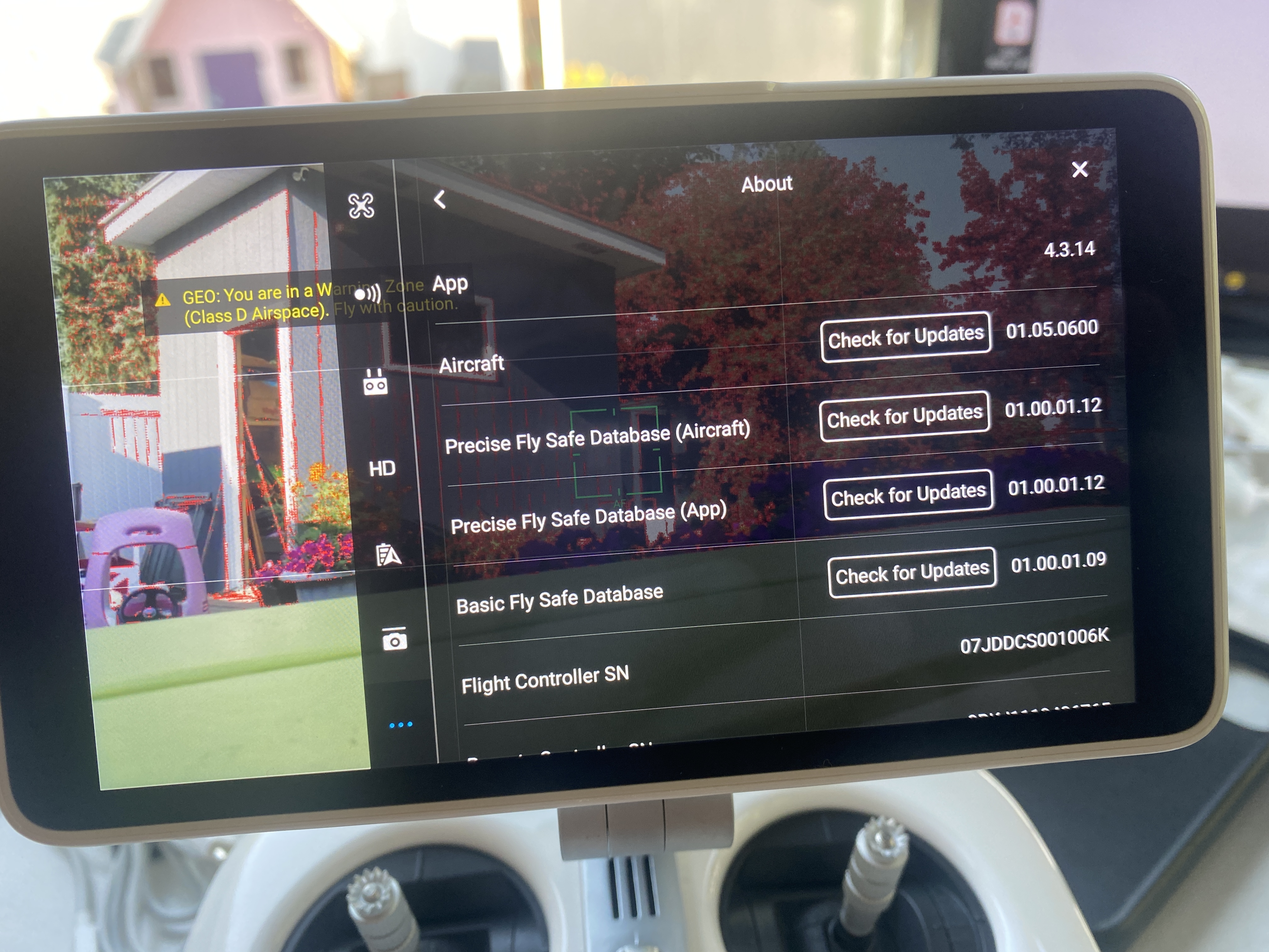

I wonder if you got your maps working. In the case you did not, I went through the no maps problem. I got them working and the setup seems to be solid. Part of the steps was installing v4.3.37 Go4. That got my maps back but Go4 kept crashing.
The combination that is solid for me is:
Controller V1.4.1.0 (I had tried 1.4.3.0 and I had trouble when trying to install 3rd party apps)
Go4 4.3.14
I got my V1.4.1.0 from Dank Drone Downloader - Web App
I got my Go 4 from HiDrive with a password of help100
I cannot take any credit for any of this, I only finally found an instruction set that worked for me. The only thing I varied from in the instructions is updating my AC firmware.
I originally found the instructions (after two evenings used up trying to solve this) at: Pro+ Controller Firmware
I hope this saves you some grief and valuable time.
