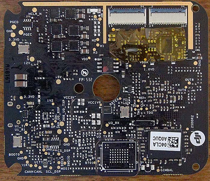

I have no idea if any components need to be replaced since I'm not familiar with the process of flashing. I would refer to you on that. I tried to remove the DiVinci chip on a junk board and it wouldn't budge with heat or force without damage to surrounding components and the board itself.

Hi, yes I think you got all wiring connections right, you also can connect only RX and TX from P3P board with FT232RL board, and connect P3P board directly to drone and power drone on(just disconnect flex ribbon cable), I found both methods working for me.

Like connecting the
RX on the gimbal board to the tx on ftdi
And tx to rx?
Hey all, just want to say big THANK YOU to "SunsetCatcher" and other people who found this fix! I just successfully fixed two P3P boards with this fix, the only problem for me was wrong command prompt directory...? and when finally learned where my IMG files are extracted and how to point the command line to that place everything was done in first time and 100% successfully now I have live video back. Thanks again to all!!!!

Hey everyone. I have a board that is experiencing what I believe to be the issues discussed in this thread. I have followed the manual provided by SunsetCatcher, but end up with this code.
Waiting for SFT on the DM36x...
Target: Starting UART Boot...
Target: BOOTUBL
BOOTUBL commmand received. Returning CMD and command...
CMD value sent. Waiting for DONE...
Target: DONE
DONE received. Command was accepted.
Sending the UBL image
File ubl1.img is not present.
Interfacing to the DM36x via UART failed.
Any help would be greatly appreciated. I am overwhelmed with all the information in the threads and don't know how to proceed.

I had the same problem at one time. To fix this, you need to put all the files in the same folder C:\ph3pns
or try direct to the root folder C:\ make sure you are running cmd as admin
Oh, this thread is awesome. A huge thank you to SunsetCatcher!!!! My P3P had the No video transmission error, but the camera worked fine recording still and video to the card. I bought a new Wifi board and replaced it, but I still had the issue (no video downlink). I finally found this thread and went through all the steps in SunsetCatcher's manual and BOOM! I have video again.
For those that will attempt this fix... a few points of advice. This is very technical. You will need a half dozen micro solders under magnification. Also, the USB serial interface I used for the PC had 5v VCC and everything seemed OK, but it did not have enough amps (500ma) to fully power the board. I opted for an external power supply at 5.0vdc to the 5v pad on the board. Also, make sure your serial interface is set to 115200 baud, 8,1 -- I didn't see that mentioned earlier. Once I had good power and good serial settings the software worked like a charm. I put the files into a directory in the c:\ root, changed to that directory, and then executed the exe file command line.

Thanks for all who posted. I just about gave up but worked through the steps and successfully fixed the the "No video transmission error" on my P3P. If there would be one thing I would mention is make sure you are in the root C: directory. Do this by typing command cd\ . I also ran command prompt as administrator.
