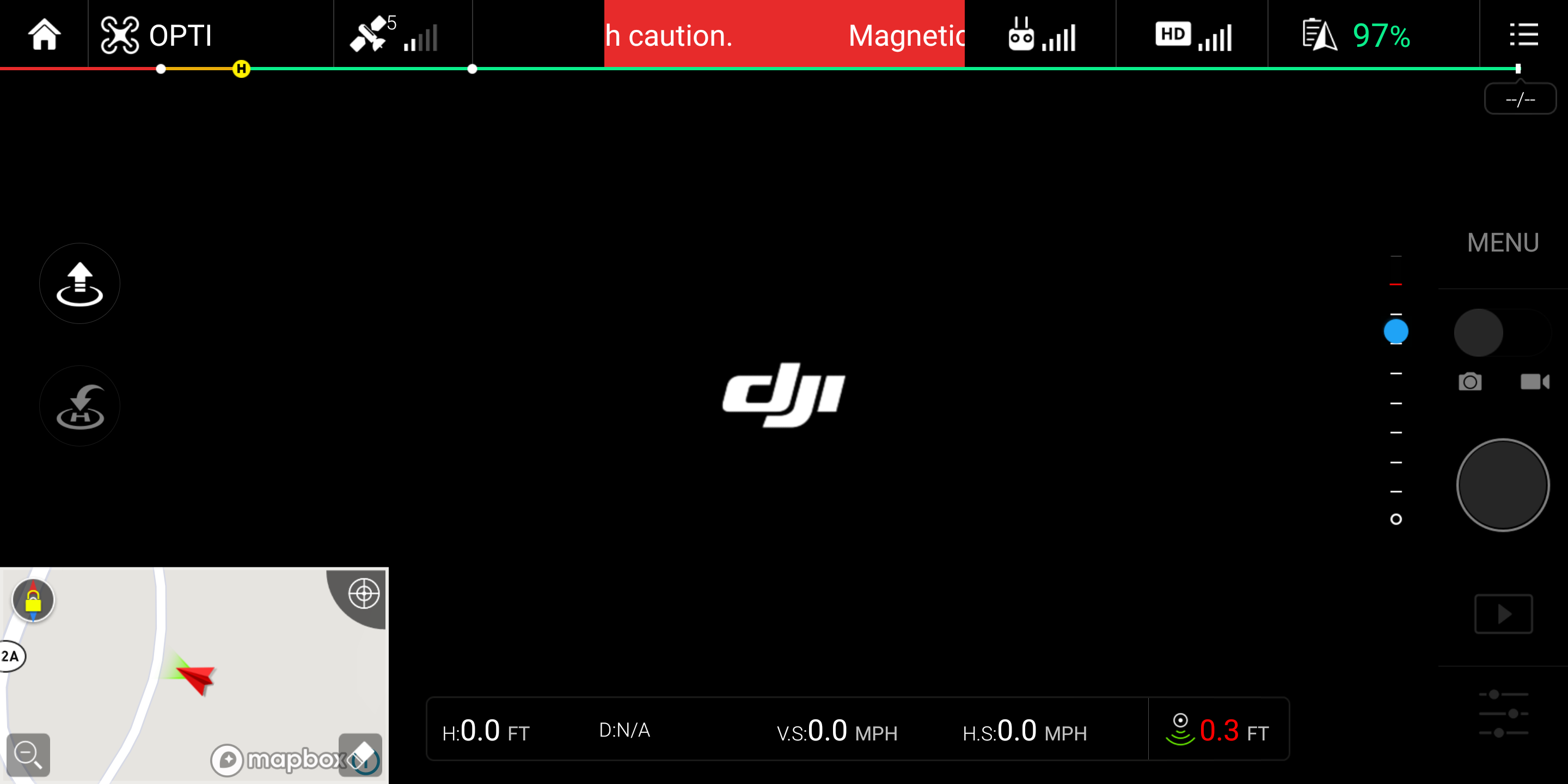

No image transmission signal - P3P
the same like here

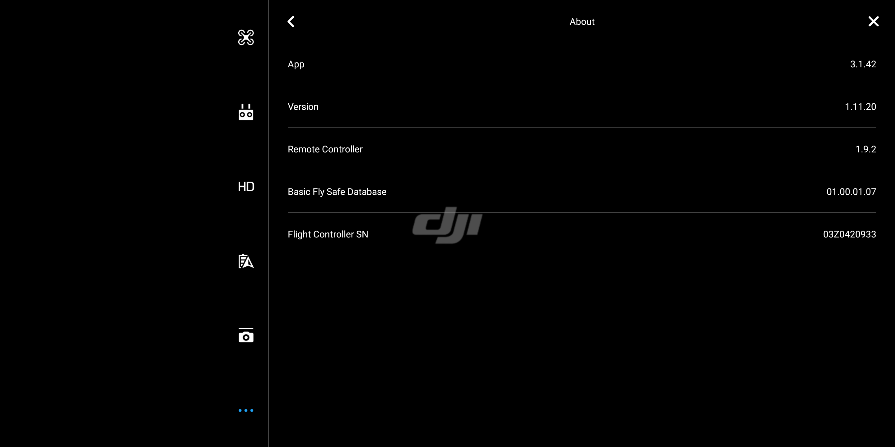

Ok, I've got the no image transmission issue as well now, it happened after a firmware update a few months ago, but i put it in storage right after as i was frustrated.
I'm able to fly the copter, the gimbal moves, I'm able to adjust the gimbal manually up and down, but I don't get any video recording/images recorded to the SD card. I've got the logs and the hidden logs which I'll post below. If someone can take a look and point me in the right direction, I'd be grateful.
The copter is in perfect condition, no crashes or rough landings. The issues started immediately after the firmware.
Thanks.

OI'm able to fly the copter, the gimbal moves, I'm able to adjust the gimbal manually up and down, but I don't get any video recording/images recorded to the SD card. I've got the logs and the hidden logs which I'll post below.
The logs show successful update, and all AC modules are responding to version query afterwards.
Maybe your RC firmware isn't matching AC?
EDIT: No, from the screenshot it is matching.
So there's nothing wrong from the data you've provided. Go the standard diagnosis way:

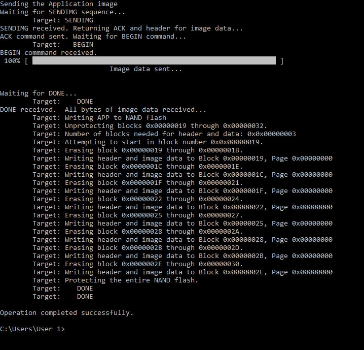

First time, cannot see the board because of boot0 / boot1 not connect properly to 3.3v. Redo the connection and no issues.
Thank you.
Operation completed successfully!
Another success! I have FPV video again!

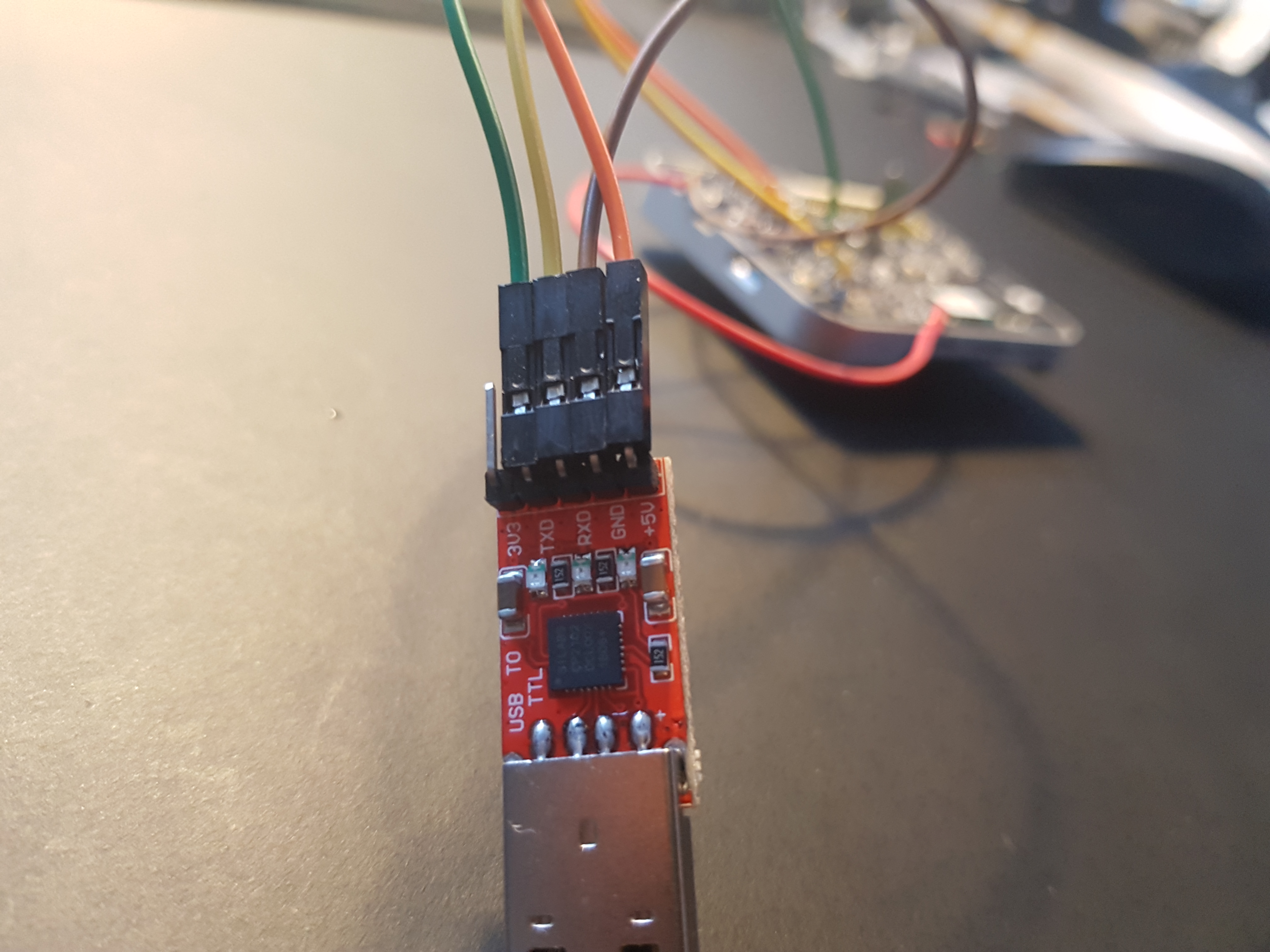

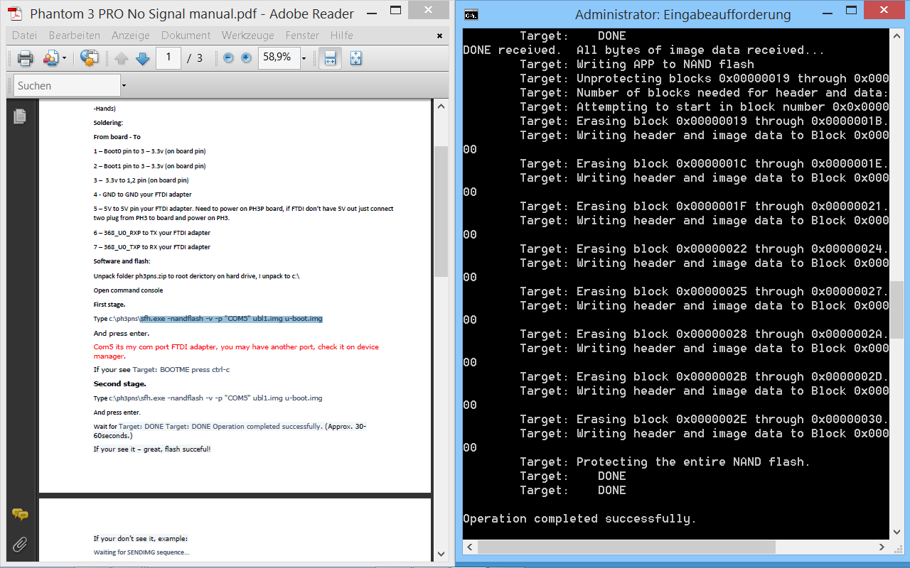

I found this thread when searching to see if there was a fix for no FPV video on my android. The P3P flew fine and did record video and take photos, but no FPV. Crazy to think what DJI charges and all the hassles for a realitivily simple nand reflash software error. I happen to have a good soldering setup and rework station so not to difficult. Buying a decent temp adjustable soldering iron and a FTDI from Amazon would be way way cheaper. Took me about an hour taking my time. Make sure you take the 2 boot files completely out of the unzipped folder and put them on the root of your C: drive before running the flash utility in your windows command prompt.
A big thanks to SunsetCatcher for your posts and files. Also to Quaddamage and all the others who posted info and results of their efforts.

I have successfully used the UART method for a P3P gimbal. I have a inspire 1 with the same issue. x3 works fine x5 fully functions except video stream. Is the same video processor used?
I think there were users mrburns and starcatcher that had it worked out. Anybody have thoughts on this subject?
Inspire 1 also uses DM3xx processor, though I'm not sure if the exact same model.

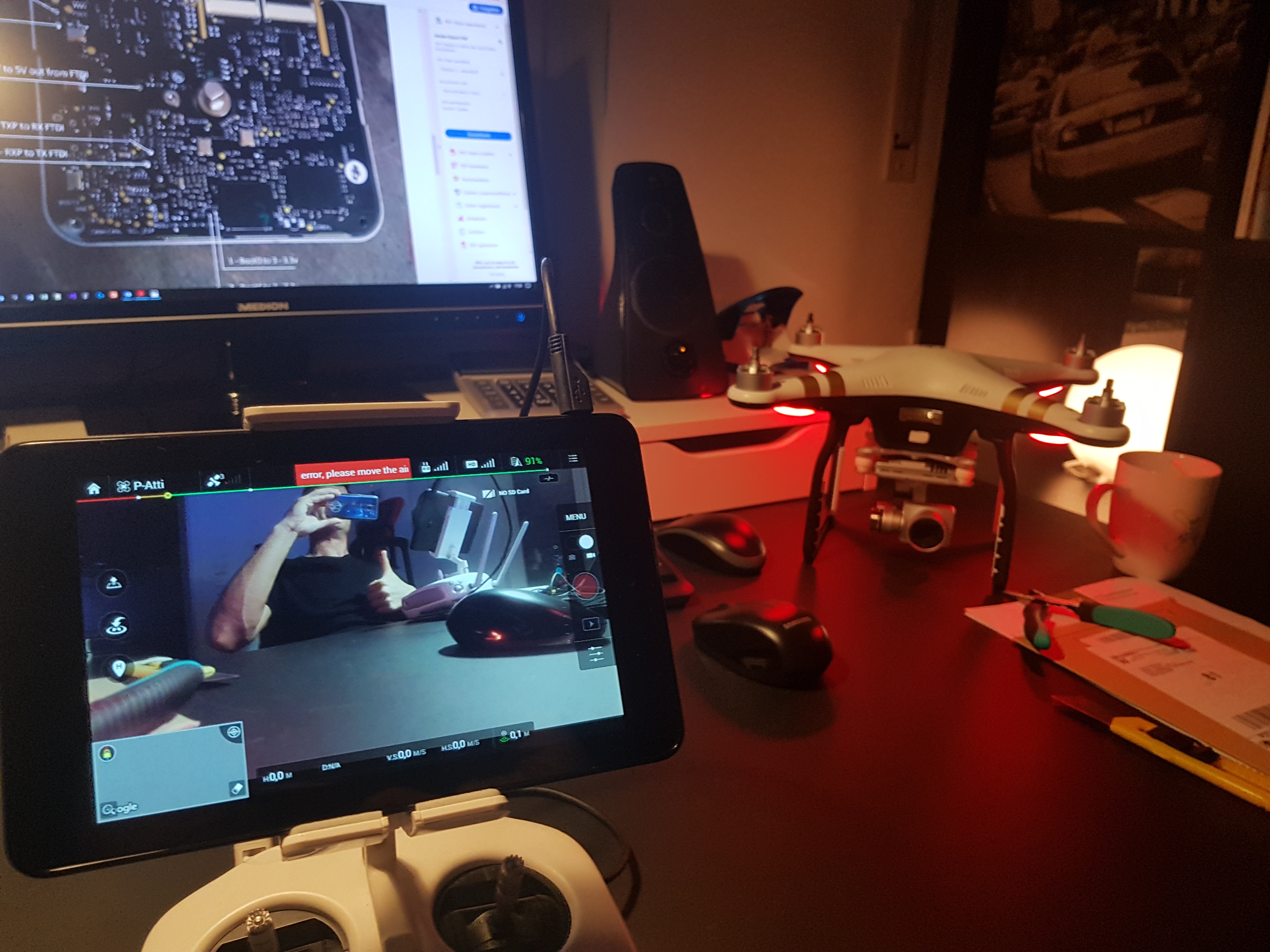

Hello, I also ran into this 08/15 problem with no live feed after firmware update. Everything other works fine. I can fly and I can take pictures and videos. All telemetric data are visible.
I tried every suggested fix I could find on the internet. I changed all cables. I tried to update and downgrade the copter many times. I tried serveral older versions of DJI GO app. I changed the OFDM Receiver Module (Part 35). All with no success.
Then I decided to send the copter to dji. But a few minutes later I found this thread with this amazing solution from SunsetCatcher. I read all the posts here and was happy to see that some people got there live feed back. I also would give them a try.
What should I say. I pulled it off!!!
Many thanks to SunsetCatcher and Quaddamage for this great work. And thanks to all other guys who posted there results.
