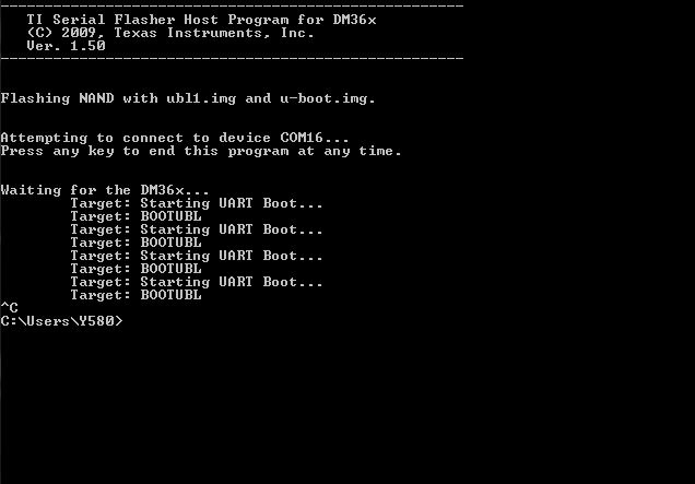

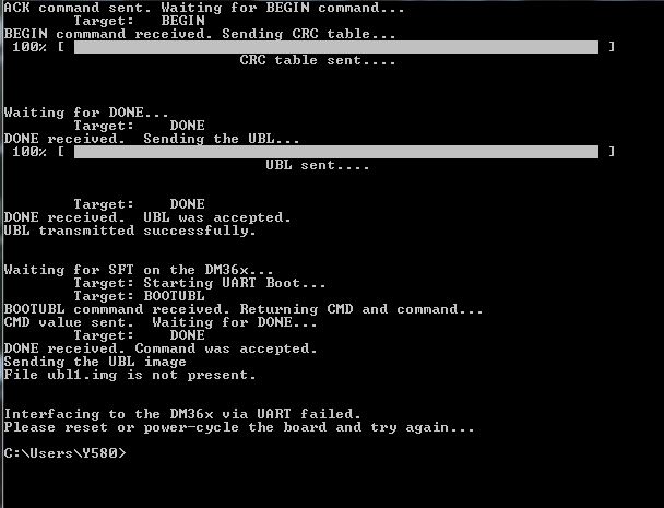

Hello There
I have the message ubl1.img not found ???
I tried two laptop it's weird

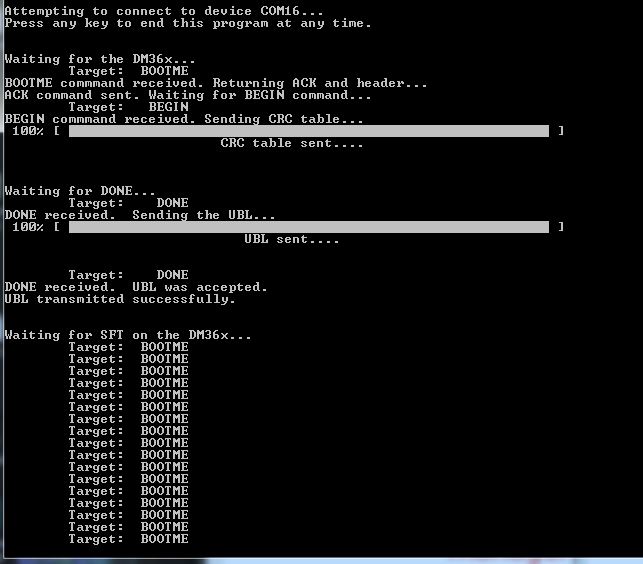

Sometime I got this too >>
Target: Starting UART Boot...
Target: BOOTUBL
any ID??
Thanks
