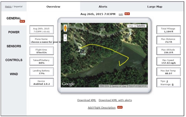

Well, I was at my parents neighbors flying this evening. Took a few flights with no issues. Landed, changed batteries, and went to do a look over the small pond they have next to their house. I was watching the video and ascended and stopped, planning to turn around. Then all I hear is the thing go nuts. I am not sure what happened. As you can see in the video, all I did was increase altitude before hand. I suppose I could have lost a prop, but I had been flying and doing maneuvers much harder on it than what this was.
I will do a dive for it tomorrow and hopefully be able to find it. It isn't too deep I don't think (10ft or so), This is literally the first issue I have ever had. I will be sending this to DJI. Don't think I did anything wrong, so we'll see what they have to say.
Upload your flight log here HealthyDrones.com - Health Check for your DJI Phantom, log converter and more . Great little diagnostic site.

Battery flying out is the first thing that comes to mind.
Nozzie wonder what is up with the speed? 157.82 MPH
Sure hate to hear about your loss!View attachment 29391
I am guessing it is from the downward crash speed.

I had one crash in the water and someone was nice enough to look through my flight logs and tell me exactly what happened, I lost my previous info but he is the one who runs the flight log site I told you about in my post. In the Android code if your battery becomes unseated there was a bug in the code that tells you if the aircraft loses signal with the controller, so I could see everything but the code that was left out was supposed to tell me if the controller lost signal with the aircraft and it didn't, so it showed I had 51% battery life and then all of a sudden landed in the water at a moments notice. See my video here

Here is the issue:
“There's actually a message in the Android app codebase:
res/values/public.xml: <public type="string" name="warning_battery_error" id="0x7f080062" />
res/values/strings.xml: <string name="warning_battery_error">Battery Communication Error. Fly Carefully</string>
But this message isn't referenced anywhere in the code itself - they forgot to implement the tiny bit of code where they show the error message. If they'd implemented this correctly in the app, you would have seen a warning.”
