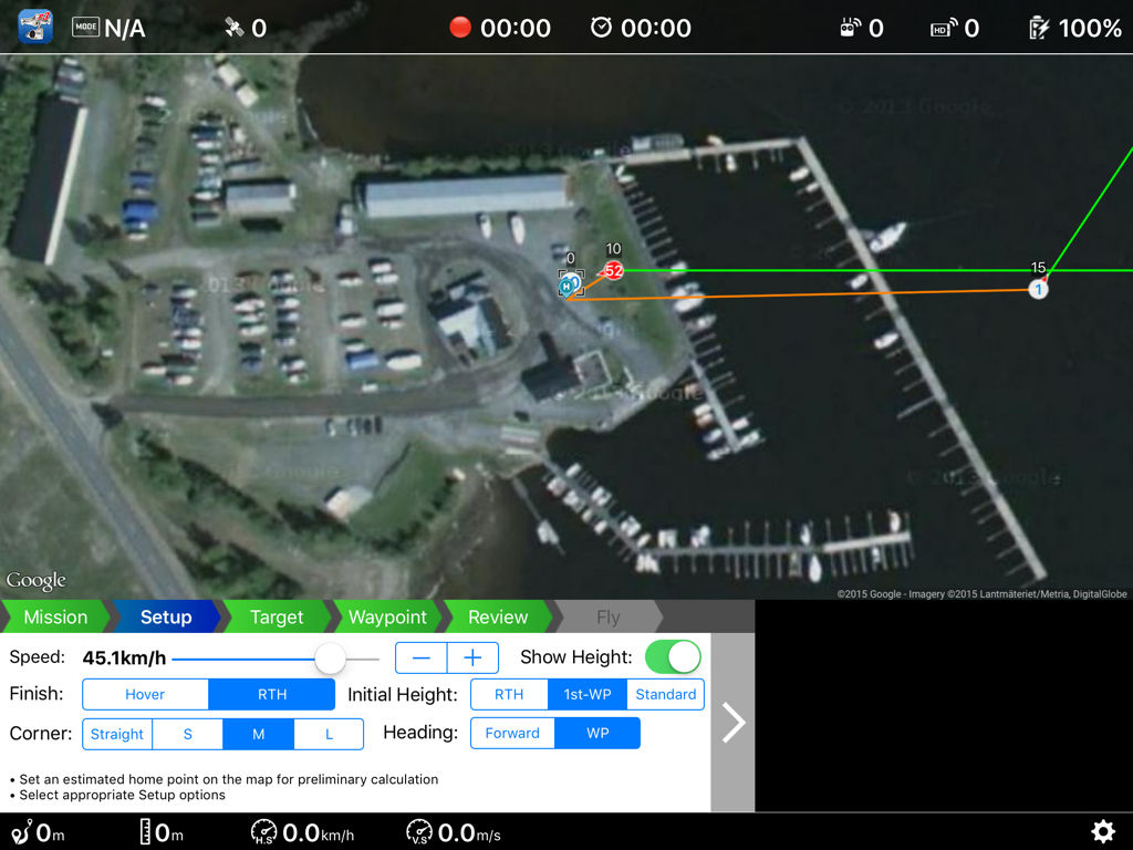

I have my corners set to L but the flight is acting like straight. Am I doing something wrong? What do you need me to upload?
The P3 flys to the waypoint at the selected speed then brakes into the waypoint makes a hard turn and speeds up again to the next waypoint. My P3 is a version 1 with the old motors and mainboard.
Also my last flight log entry is all zeros and I'm on the latest beta build. I'm using an iPad mini 4 if that makes a difference.
If you set the Speed higher than 6m/s or so (can't remember the exact value & will check later), it's likely to slower you down to 2m/s and turn a fairly sharp corner, then speed up again to the next waypoint, regardless the corner size.

So I need to be at ~13 mph or below? What speed was the op video? Your corners in the video and flight log were very rounded.

The OP speed is around 23 km/h (can't remember exact value). You may check from the setup video.

The poster i quoted above also reports the same with a speed of 32 km/h with large corners.
I will try with lower speed and large corners but i think its a bit uncalled for to state that DJI flight controller cant handle high speed corners. Surely both Airnest and Litchi uses the same and the corners are more fluid in those apps.
Sorry i havent purchased flight log only fpv goggles which claims i have to buy it again. :)
yeah, i saved it as a new file with lower speed already.
EDIT: Purchased flight log (seems to be free during beta) but what info/pic do you want?
I can see that in almost all wp:s the speed goes down to below 20 km/h and even below 10 km/h in some of them. Is this intended with medium corners?
Did you get a smoother footage after lower speed? DJI flight controller would indeed lower corner speed and ignore corner curve if speeding. We will add color in speed slider as an indicator in Setup step.
