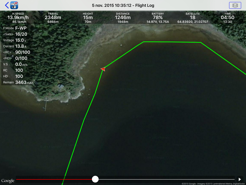

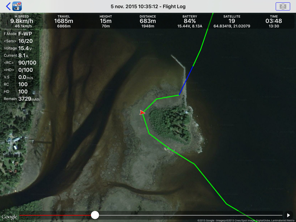

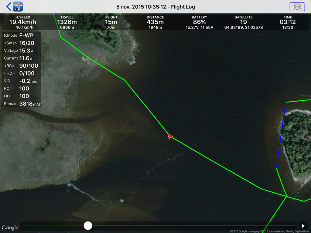

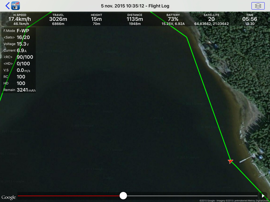

I agree this is noticeable on my mission as well. The P3P seems to slow down or pause at each waypoint then accelerate to the next. Can the transition through the waypoint be more fluid? My corner was set to L. Speed 20 mph. I also saw legs on a few turns.
We suggest to set the Speed lower than 28 km/h as stated in the document. DJI flight controller seems not handling high speed corner turn very well. If you need to speed up from one target to another, you may use RC pitch forward when flying straight. Can you open the Flight Log to share a screenshot?
You can save the mission as another file name with slower speed, and give it a try again.
The poster i quoted above also reports the same with a speed of 32 km/h with large corners.
I will try with lower speed and large corners but i think its a bit uncalled for to state that DJI flight controller cant handle high speed corners. Surely both Airnest and Litchi uses the same and the corners are more fluid in those apps.

yeah, i saved it as a new file with lower speed already.
EDIT: Purchased flight log (seems to be free during beta) but what info/pic do you want?
I can see that in almost all wp:s the speed goes down to below 20 km/h and even below 10 km/h in some of them. Is this intended with medium corners?

I want to see the flight path of a zoomed in target and corners. DJI flight controller may slow down at corners depending on many factors, such angle, radius, speed, distance between waypoints. I believe it's the same on DJI GO and other apps.

Here are some pics and the copter breaks to well below 20km/h even on very moderate turns. In one of the 45 degree turns tis below 10km/h.
Per your flight log screenshots, the Corner setting seems pretty straight.
You may take a look of the OP flight log with (L)arge corner with flight log replay.
