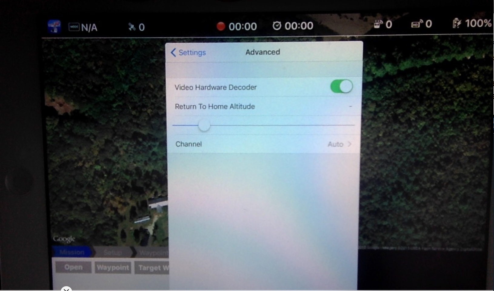

1. I am unable to set return home in the advanced settings. I switched to imperial and tried to change the value on the slider. No numbers appear. When I go back in even quitting the program, the value of the slider is all the way left and no number displayed.

1. I'm unaware of "set return home in the advanced settings" in FPV Camera app, or you are referring to DJI GO app? In Mission Planner, you may set Finish to RTH upon completion of mission (as shown below).
Can you post a screenshot to show "the value of the slider is all the way left and no number displayed"?

This page:
OIC, if the app is not connected to RC/P3, you are unable to set RTH altitude. RTH altitude is set and stored on the aircraft, instead of the app.
OK that makes sense. You may want to make a note of that on the page in the setup. Does this apply to different advanced settings as well?
