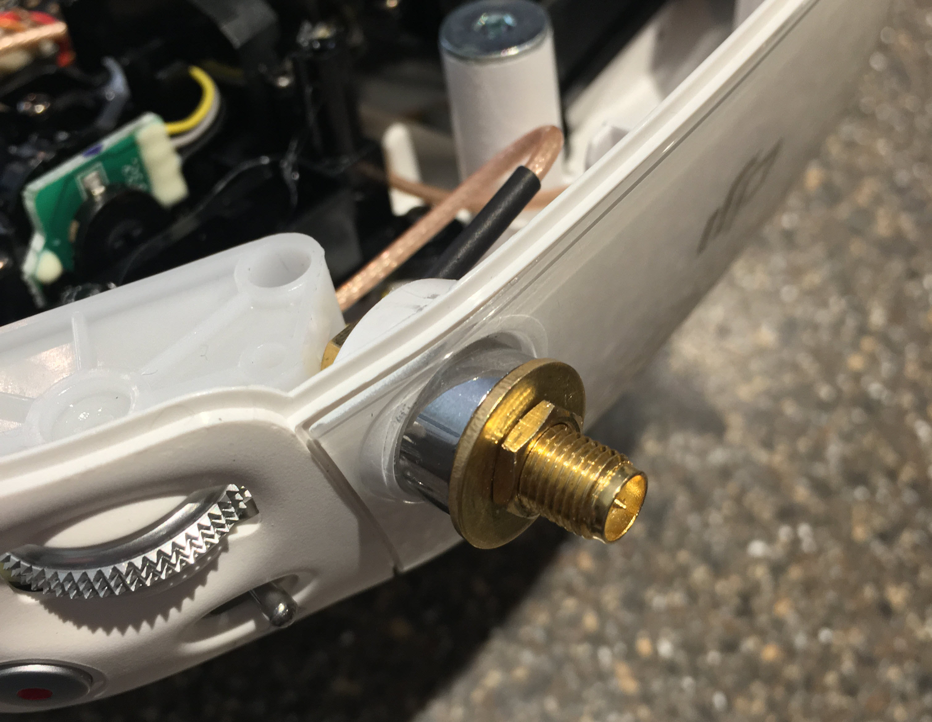

The connection of the wire to the connector is very fragile, so you need to be careful when installing them.
To provide a secure fit so they don't twist and damage the internal connection when screwing the antenna cables on and off, I added a larger washer so the nut seats evenly on the "chrome" ring.
This was after replacing the first set of cables which I damaged with the twisting. They don't have to be broken off to have a damaged wire. They still worked for close flights, but distance was limited regardless of which antenna was used.

I actually think this may have happened during the removal of an antenna cable. When I disconnected the cable running from the antenna to the controller that was ever so slight movement of the controller connection point. I suspect that during those small movements the internal cable was rubbing a piece of plastic causing the damage. I didn't perform the initial install as I shipped my controller to have it done so I doubt the install caused it but I guess its possible. I'm still amazed I was able to fly at all like that, the smallest touch possible completely separated the cable as you can see in one of the pics. Literally, you could have blinked and hit the cable with your eyelash and I'm sure it would have broken the connection completely.

This is exactly what I suspect happened to me! I like your style :) interestingly enough I took the same course of action as yourself and applied larger washers. Seems to be doing the trick so far. You can check out the pic from my setup tonight when I post pics of everything.

You are right about it being fragile. I had the same problem, no where near as bad as whichantenna's and had to replace my cable too. When I did, I bought some bigger washers (thanks to someone's idea/post on the forum, don't remember who posted it) and this seemed to fix my issue. I had done the clean install myself and think that the rubbing on the piece of plastic and it not being tightened that great due to the small washer is what did it for me.

I installed the clean install kit yesterday and you have to pay attention on that specific connection.
Make sure that you have the wire situated as shown on the Maxx installation video. Second, make sure that you secure the nut well enough that it does not turn when you install the antenna. If it spins the connector, then your wire inside of the controller is spinning too and that can rip the solder joints off and/or sever the connection. I had to open my controller a few times to get it right, but now that I understand what was happening I am sure I could complete the install in much less time than I did.

Can someone please post the size of those replacement washers? I just broke one of my connections, while taking the Maxx off to install my new amps. I knew this would eventually happen the day I did the initial installation.
