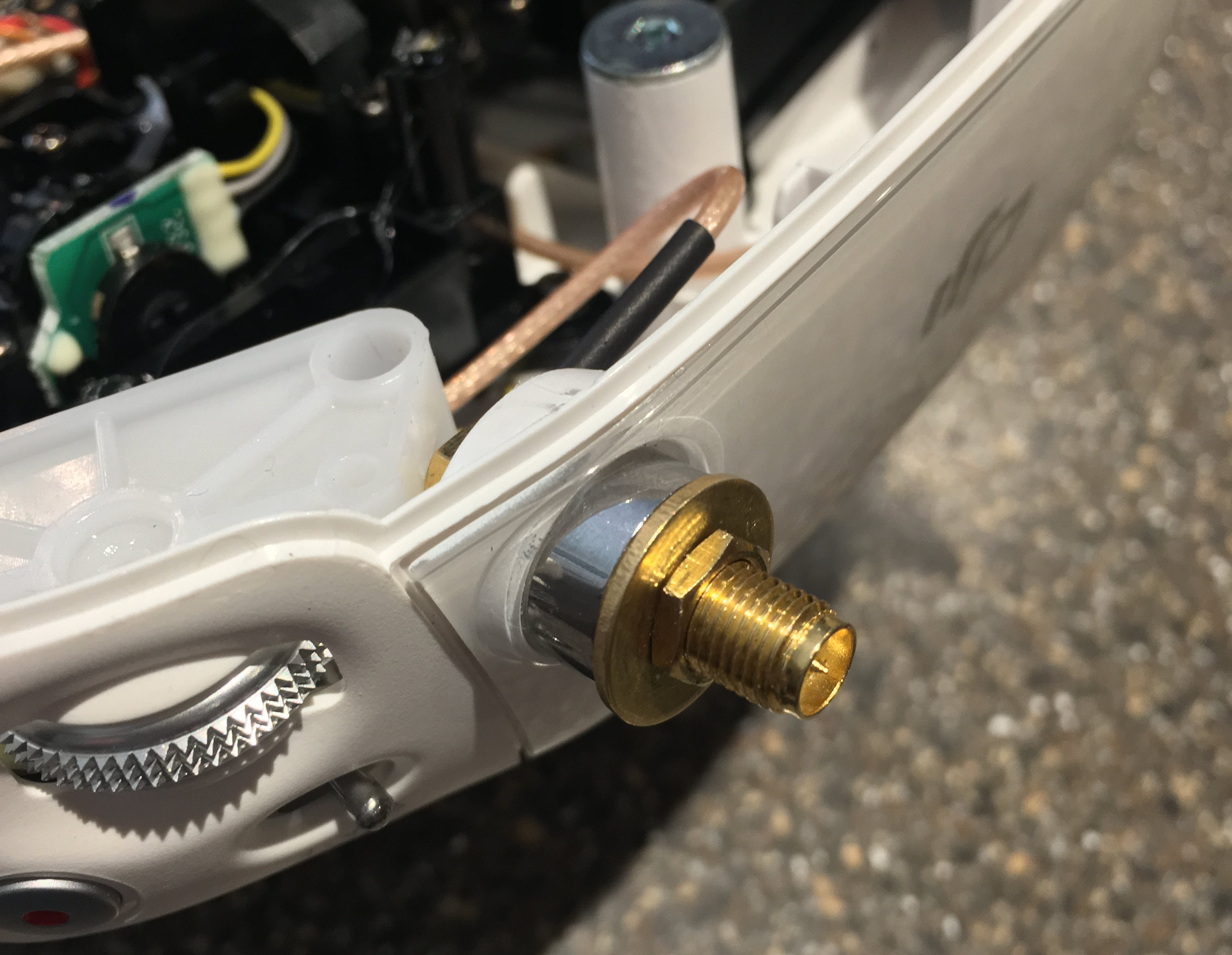

I didn't tighten mine down enough when I installed the first set, and they twisted when screwing the antenna connectors on and off. Tried having the one that was obviously bad repaired, but ended up replacing both. The MaxxRange is working fantastic now.
I added a larger washer on the outside that allowed me to better tighten up the connector against the "chrome" ring to prevent the twisting.
Nice work. The twisting I think is the cause of most of the problems.
