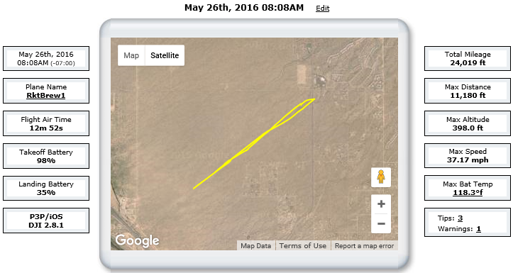

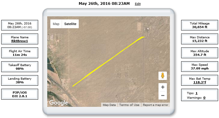

My first flights with the ItElite MaxxRange Antenna have been underwhelming. These are all from the same spot and in the same direction over open desert as my previous best 14,581 stock with windsurfer.
First try yesterday was very windy, couldn't get to 25 mph on the way out, but did 50 mph on the way back. Started losing signal and turned back at 11,994 ft. out and 222 ft. altitude.
Made two runs this morning before the winds picked up.
First run was to 11,180 ft. out and 398 ft. altitude. Lost signal and had to cancel RTH twice to get that far.
Then I moved to the other side of the dead-end "street" where I takeoff (~20 ft.) and seemed to keep a signal longer, but still not what I was hoping for.
Made it to a new personal best 15,232 ft. out at 355 ft. altitude.

I am flying up from the home point, so the aircraft is always above the RC. (Don't do the math for AGL, the terrain drops >300'!)
This is the same spot and direction that I did the 14k run with windsurfer before I moded the RC.
