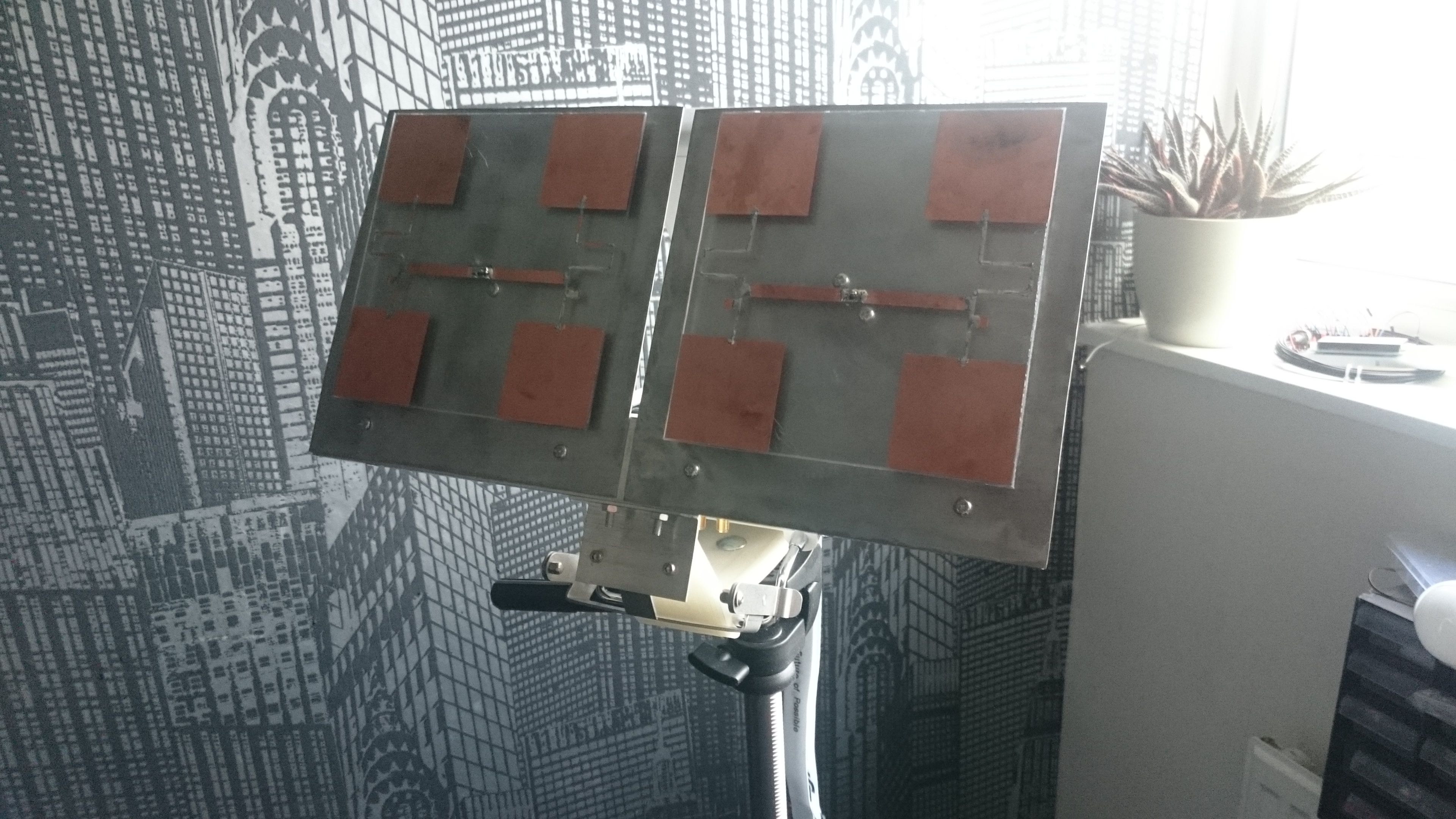

Finally the weekend, I should get a test in tomorrow with my diy terminator View attachment 55221
I've also went ahead and ordered 5.8ghz 2w amp, 20000mah anker power bank and a 5v to 12v step up module:)
Got me some creating to do for 3d printing some kinda holder for all this tech :cool:
Looks professional. Well done. You mite be the next long range guru. If you start selling your designee I would be interested. Thanks for showing. We have a 3 day weekend here. But weather is not helping.
Same here 3 days possible flying after two weeks no flight time awesome. Thanks for feedback lol I'm still very new to this but learn fast usually.
This is still prototype and will be etched on pcb etc. as soon as I get the results I hope for shame I have to wait till Wednesday for the amps tho bank holiday and all that.

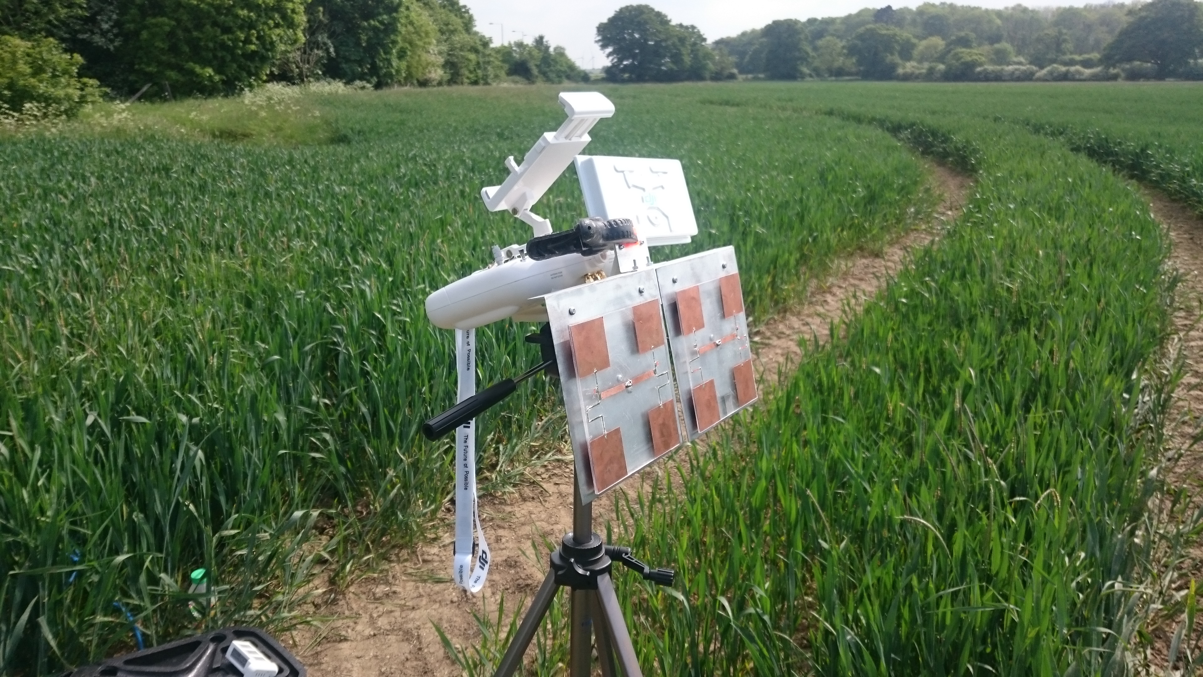

OK so battery 2 is on charge, I'm going to do a dbs run and then my diy 2.4 with the 5.8 from the dbs so this should be a good comparison.
I will be on a tripod same direction etc. So no differences other than antennas on the 2.4ghz side.

OK here we go, I'm impressed so far but I think it could be improved.
Flight 1 dbs mod as standard:
Top distance 7043ft then it rth I did have 2 bar left on 2.4 but was really starting to get choppy I made another attempt by cancelling rth but never really got further.
There are power lines close to this area and I'm sure I get some interference around that point.
Flight 2 dbs mod 5.8ghz with diy terminator 2.4ghz
I got top distance Of drum roll
10,437ft rth my best yet.
I don't know what the effect using just the 5.8 on the dbs but I definitely was able to cross the power line area and signal picked up at about 8000ft my videos signal dropped to 2 bar after being solid.
9000ft was getting really choppy in and out but overall was kinda doable as it wasn't completely losing connection
Overall I think successful as it's a prototype.
Maybe playing with the space between ground and live as my sticky pads seemed to be coming away from ground, could have effected things.

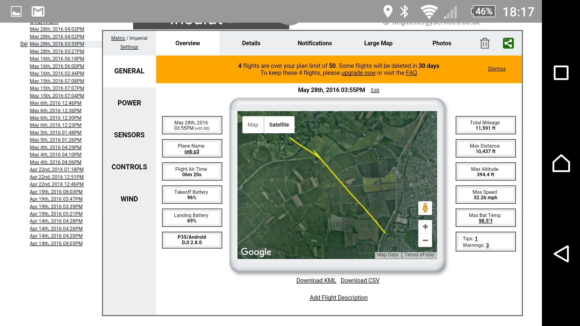

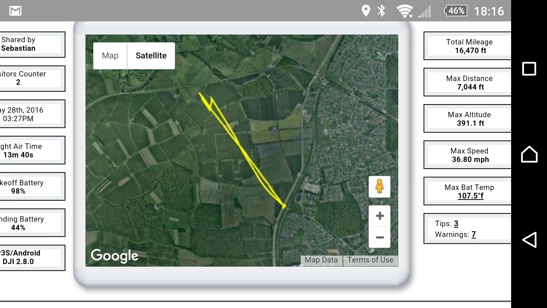

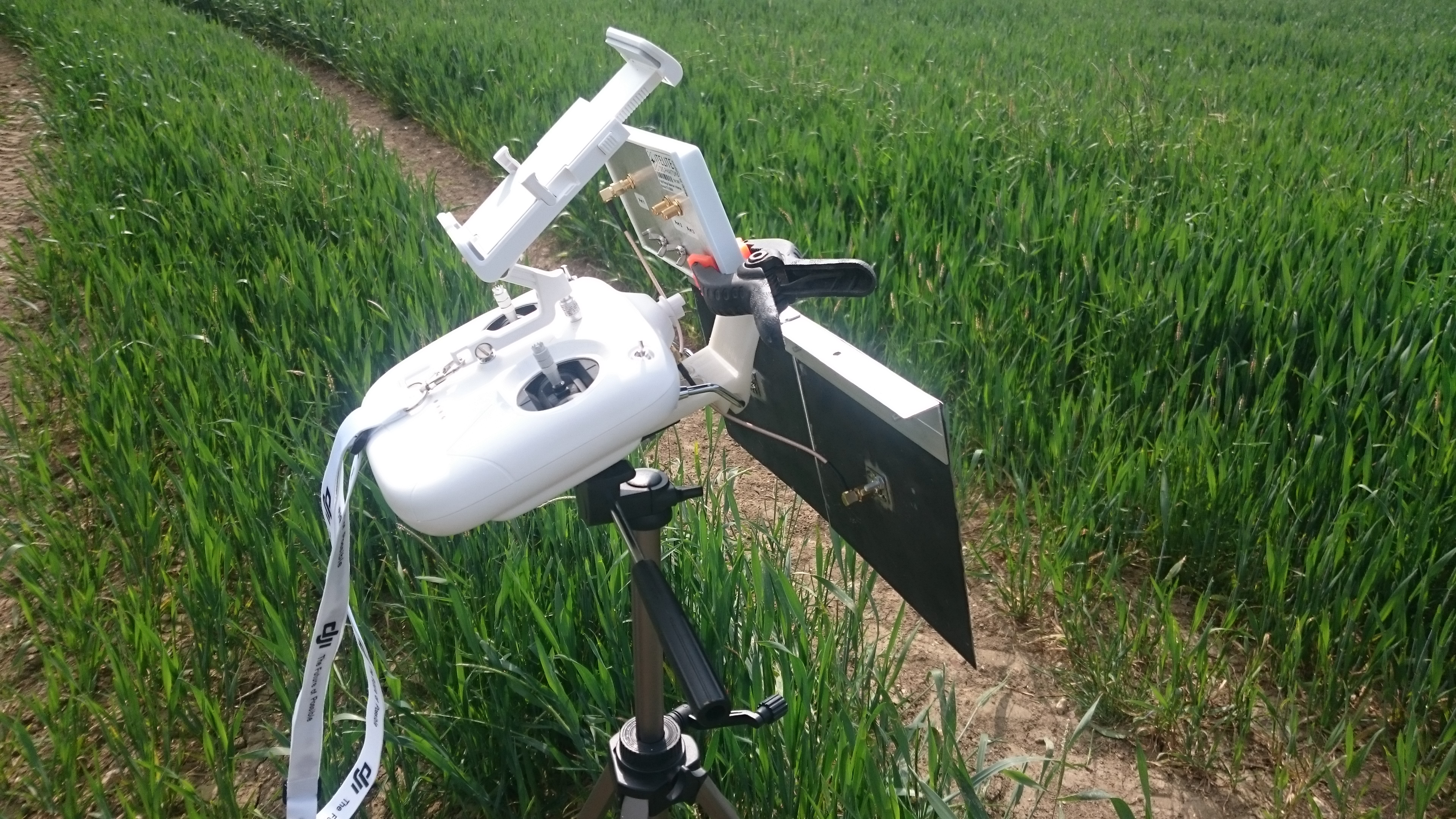

View attachment 55278 View attachment 55277 OK here we go, I'm impressed so far but I think it could be improved.
View attachment 55275 View attachment 55276
Seb maybe another way for the spacers is I seen on ebay Plastic bolts and nuts. That is the old way, we did it with computer boards. and If you look back where I shown some pictures of Cisco panel antenna they were using them.with the plastic bolts you can adjust your space also. Just an Idea.
And nice flight.
And nice flight.
This is definitely a good idea, gonna print me some bolts and adjust each flight thanks for the input:)
