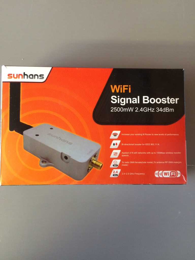

dB, I could just boost the 5.8 and leave the 2.4s unboosted? That's what you did with the term right?
I'm going to start out with it all
Unboosted ! But I imagine in the end you'll end up having to boost the 5.8 depending on what kind of distance you're looking to go!
Reactions: Lee SK
Remember, that has a N type connector, not the SMA that you typically see around here. The N is much better for long signal runs because you can use a 'real' coax instead of the lossy nonsense you see here. But it would be amazing overkill to just hook up to an RC. You certainly could make (or perhaps buy) an N-SMA adapter but every adapter, every cable, every everything adds up to signal loss at 2.4 GHz.
