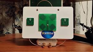

I would love to see the insides of the smaller 9db DBS/Itelite panel. Any takers? :)
Hey pro conductive copper tape and tested continuity it's possible this may not be good enough and I might have to thinly solder over the lot testing will tell.
This is definitely a prototype and if all goes well I will be etching pcb and possibly vacuum forming cover and airbrushing.
Hey Tony my guess it is just 2 patches but would be good to see

question Seb if you added 2 more pucks to that would you think it would help on the 2.4 ghz side?
in parallel or serial
I'm not entirely sure, I haven't seen inside one of the pucks but my guess is it would mess with the impedance which would probably give you worse signal than before, that's my understanding of it but there's still much to learn
The way I see it the signal is retrieved from the antenna and is still spiraling in a pattern through the cables to the Tx or Rx, so if you had to signals coming into one cable it would seem that once they collide that rhythm would be extremely disrupted
