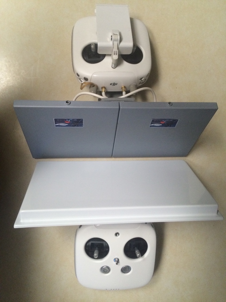

Maxx VS Terminator. Long distance antenna shootout!

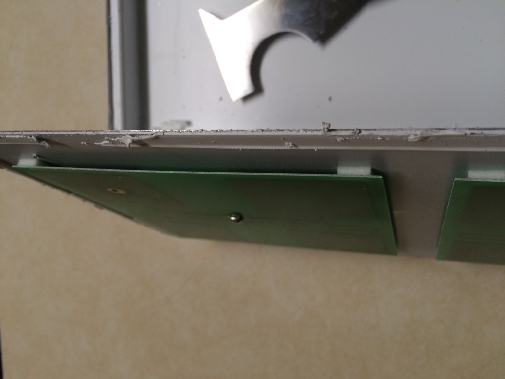

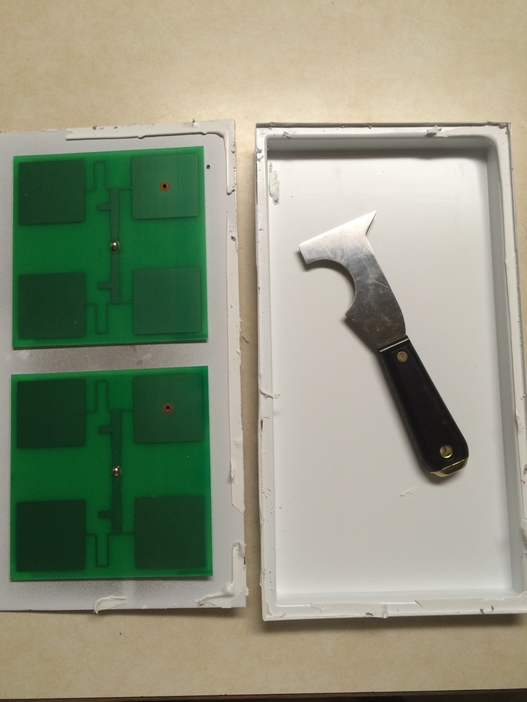

just can't tell from the pictures if there is any different in spacing on the maxx. Db did you see any foam between the back plate and the circuit board on th maxx?
Yep, some 1/2x3/4" double side foam tape on the four corners, and a couple of the corners were already unstuck/popped loose! This cover DOES NOT sandwhich
the boards in like the design of the Terminator, and one board looked slightly un-aligned with the other because of the tape failure, that would concern me that the mis-alignment could weaken the signal if I hadn't gone 9.3 miles w/ this panel last nite
the boards in like the design of the Terminator, and one board looked slightly un-aligned with the other because of the tape failure, that would concern me that the mis-alignment could weaken the signal if I hadn't gone 9.3 miles w/ this panel last niteView attachment 54259
I would make sure that the boards are attached. some silicone or hot glue.

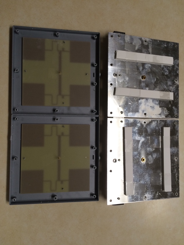

Although I didn't measure the internal boards, based on the fact that the outside panel dimensions are very close in size and the spacing between the PC boards on the insides are further apart on the maxxrange I would speculate that the terminator panel's PC boards are slightly larger. Although I'm not sure that matters, and I'm no expert, but they look like two completely different types of boardsView attachment 54256View attachment 54257View attachment 54258
Haha just what I expected these are basically identical, number of patches sizes should be as close as poss to each antenna the only difference I see is the microstrip which determines the matching of impedance.
The spacing between the patches and back reflector should also be the same.
Possibly the terminator overall is slightly more apart from each other which would give you a wider transmission angle but probably not noticeable.

Db make sure you get the pcb to adhere to those spacers and not adding extra distance between the patches and reflector ( ground) this must be precise and if it was out before you took it apart that would have effected signal.
The Panel antennas are cheap to make. This terminator is way over priced. There is not much to tune one of these. It is as I under stand it in the spacing ,of the back plate. Material in the build would be the next factor.

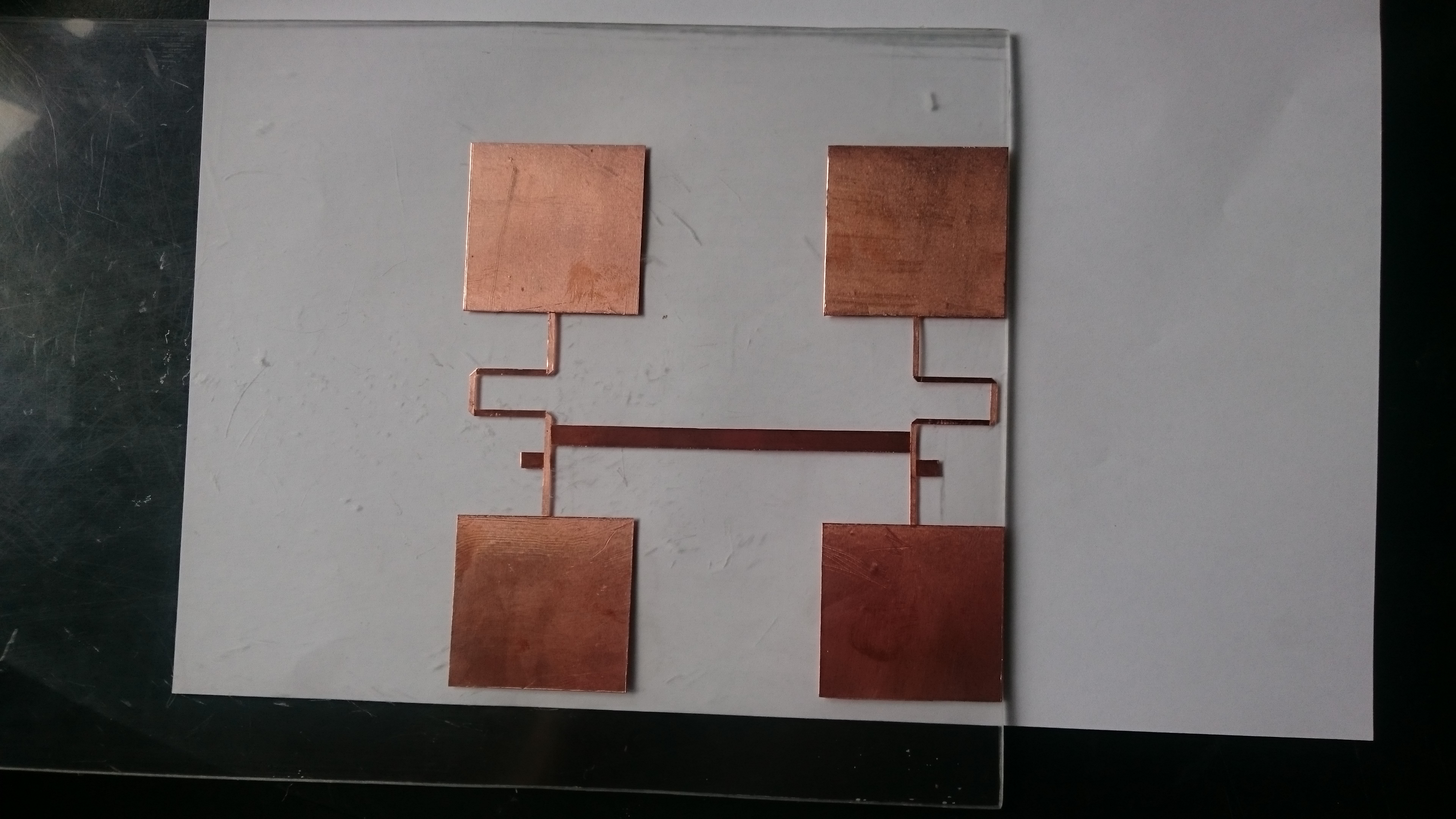

chéngwéi hǎo cáiliào (Chinese for I make good copy) so here's my process so far lol and I did it with the terminator theme on loop just to add to it.
This is prototype 1 lol I did think about adding in LEDs seem as I'm using clear poly but I'm sure this will interfere with signal, shame but maybe one to think about.

I stated earlier on in another post of mine, because my original impression of the terminator was the image from their website that showed it at least 8 inches apart, that I thought that was going to be the secret to the success of the terminator! When I questioned horizon why it was now play side-by-side their comment was "through testing we've noticed that placing them close together has eliminated certain crosstalk."
After testing the panel, I have no way to argue that they made the right decision, but I know they got decent distance unboosted with the panels separated as well. So it might be a simple matter of them wanting to package it up to a more usable product!

**** Seb looks good!!..did you use pcb or just copper sheet?
Hey pro conductive copper tape and tested continuity it's possible this may not be good enough and I might have to thinly solder over the lot testing will tell.
This is definitely a prototype and if all goes well I will be etching pcb and possibly vacuum forming cover and airbrushing.
Although this is just the beginning I've seen allot more powerful 19dBi ones so might move on to them after.
