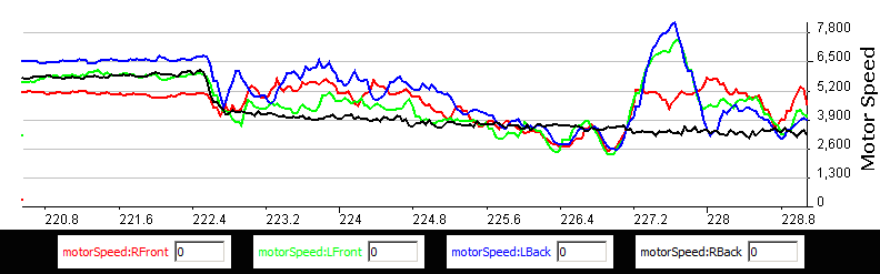

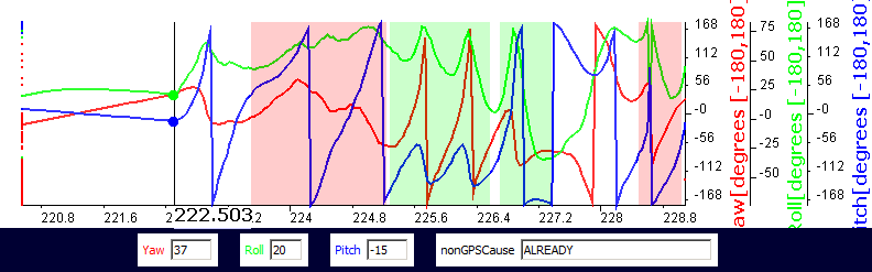

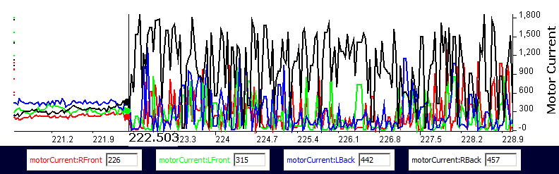

You're right, it's not a complete loss of power. I should know better by now. I was in a hurry and misread the data. Anyway, I took a closer look at FLY009 and it looks to me like there was a rightBack propulsion issue. At time 22 the P4P began to spin clockwise and tumble (starting with pitch up). Both of these are consistent with a rightBack propulsion issue. The nonGPSCause and gpsHealth errors were caused by the spinning and tumbling
In addition, the rightBack motor speed decreased and the rBack motor current increased
The increased current also caused a sag in the voltage, which in my haste, led me to believe there was a power interruption. :(
Does the right back spin as the others?

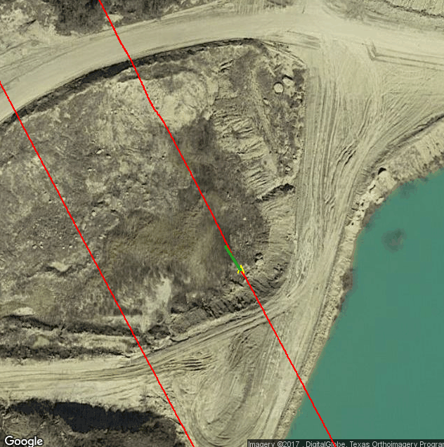

Yeah, I see that.
But, I suspect that these slow downs are part of the mission that it was runnning under. Perhaps you had it set to take a photo at those spots? It also slows down when the P4P changes direction.
Since you are already an accomplished CsvView bring up the GeoPlayer and a SigPlayer like above and you can see where it slows down. Just move the value tracker in the SigPlayer to those times where Vel:H slows down and you can see where the P4P was.

Yeah, I see that.
Hey that's cool trick, thanks for the tip. I reviewed the FLY008.DAT as well to compare, shows the same slow downs. Map Pilot automatically sets where/when to take photos during a Mission.

The motors were not shutting down as if the P4P had landed. Only the rightBack motor was running slower and that went on for at least 6 seconds. Also, if the P4P thought it had landed, or was landing, that would show up in the eventLog stream. It does not show up in the eventLog stream.
