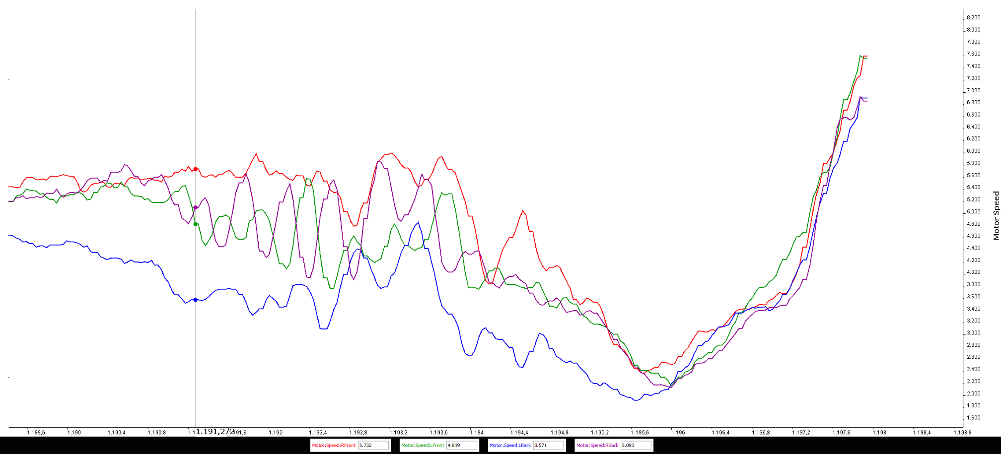

It starts a home flight when the battery is low, auto-landing, start landing, vibrate controller, ...
6 seconds later it still registers that the compass becomes disconnected.
The compass disconnects because my landing gear breaks upon ground impact.
That is the end of the crash and the battery can not be failing before that moment or being dislodged before, as in that case it would not be registering the failure of the compass in the flight log.
The battery max voltage can be a result of me trying to stop the dropping drone with a left stick up movement that I can also see when looking at stick movements on screen. But I was too late to stop the action and the drone from touching ground.
The battery level might have been too low already to do such a braking manoeuvre and could not deliver/sustain the needed current.
Motors speed graph from just before Return Home to Compass Disconnected
You're right. The abrupt power loss was caused by the impact with the ground. The impact is seen in the accelerometer data
Looks like the impact started at about 1197.865 secs, just 0.07 secs before the .DAT ends.
At 1197.242 full throttle was applied. The P4P had been increasing motor speeds by about 1500 RPM/sec. As a result of full throttle, the P4P then increased that rate to about 4500 RPM/sec.
Additionally, the descent rate starts to decrease.
Seems there was not enough altitude for the full throttle to arrest the descent before impact.
So the question remains why it came down so fast and even accelerating as I see in your last graph.
Good question. The P4P did seem to be in a bit of a hurry. I've noticed this with my P3 when RTH was caused by a low battery. The eventLog from the .txt log had this entry
