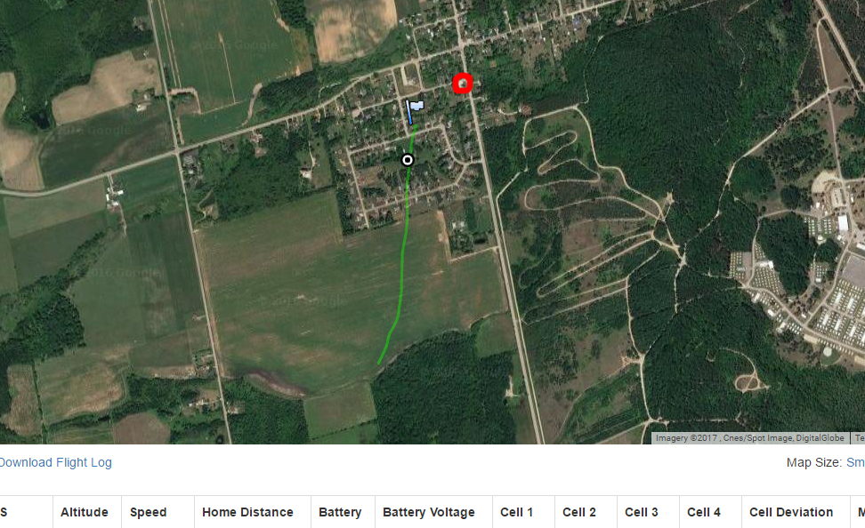

Thought i would do one last flight for the day when all was going great until I was disconnected. I waited about 10 minutes for it to RTH but nothing, off I go for a walk to the last known location shown on the DJI app with RC in hopes it reconnects. Now I get worried as it's not where it said it was and no reconnect so I walk the path it was going, not to mention the sun is almost down and I have no flashlight. About an hour later I go home and try to figure something out. After an hour and a half of trying to figure out how to find it I get a call from a friend asking "did you lose your drone?". -ME- LOL YES, where did you see it? "It's on the front lawn at the post office!". Off I go to the post office and there it is, light flashing away in the dark. So my question is why would this have happened? Why did my P3S think this was it's home point? I didn't set it to here after it recorded it's own home point. Link to my flight record will be attached along with a screenshot of where my P3S landed. First time adding a flight log here so hopefully it works lol. Phantom Log Viewer - PhantomHelp.com
Can you provide us with a legend for this? There are 3 marks on here (red circle, flag, bw circle). What does each mark indicate? Did you look at the end of the green line anyway?

Can you provide us with a legend for this? There are 3 marks on here (red circle, flag, bw circle). What does each mark indicate? Did you look at the end of the green line anyway? Are you 100% sure it's YOUR Phantom you have?

Drag the DAT file off of there. I don't know where all the experts are but one of them can glean tons of info. Hopefully one of them will show up soon. This is intriguing and yet I'm sure there's an amazingly simple explanation.

I know there are lots of very knowledgeable folks on here that can help I'm just patiently waiting for one to come on lol. I have the dat file and I'm just trying to convert it so it's readable.
Have you been able to locate/download the LATEST log file from the drone? (not from the tablet)
If so, put a link to it, and we can start investigating. As to whether or not it's your drone, I assume you have some markings on it (such as your FAA #) to positively/definitely confirm it is yours. The guys on this thread are right ... ALL drones look the same :)

It's always set to RTH and I confirm all settings after any firmware update and IMU calibrations just to make sure. I've never had a problem with RTH before and for it to land where it did and not at the recorded home point is baffling.[/url]
Did you press rth when you lost connection?. If yes, what method did you use? Did you use the physical rth button on the rc or the one in the GO app?
If you used the GO app button, is it possible you reset the home point by accident? If yes, and you used an iPad without cellular, you don't have GPS, in which case the drone would set the home point to its present location.
This scenario above is the only way I could imagine this happening.

If you used the GO app button, is it possible you reset the home point by accident? If yes, and you used an iPad without cellular, you don't have GPS, in which case the drone would set the home point to its present location. The home point was still my take off point, no change.

I did not just lose connection, I was completely disconnected. The log shows 100% then nothing, disconnected. In app setting was for it to RTH upon signal loss, not land or anything else. I did nothing to initiate RTH as I was disconnected and wouldn't be able to anyway, that's what failsafe RTH is for. There was no beeping as to it RTHing or landing as the remote does.
The app said "disconnected" not "no signal" which is like it maybe dropped the wifi connection.? Didn't take notice if that happened or not but would I not be able to fly it still as it doesn't need it to fly.?
You may have answered this already but ... did you have LOS (line of sight) throughout until the moment t disconnected?
I did up to about 15 seconds before it disconnected then I got off my roof and waited in my back yard at the home point for it to return. Started looking for it within 10 minutes of it not returning.
