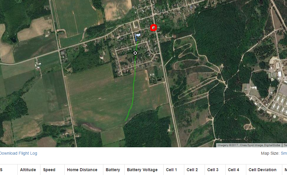

Hey Rod, I got two folders off the drone as you'll see in the attached photo and the .dat file is in the "flightlogs" folder and the one you can see on HD log is from the "flightrecords" folder.
That's the day it happened, I know it happened over a month ago but I'm now trying to figure it all out.

Hey Jimmers, I had been following your adventure on here yesterday and picked it up again today. I looked at your flight logs and wondered about your Post Office mystery. It appears the wind got hold of your bird and took it up and away. There have been all these questions about "Home Point". It looks like to me that is what the bird calls it when it gets to low battery and lands. In order to land it must tell itself the closest available spot is now the new "Home Point", set it, and then land.
There was a light head wind, I always fly into the wind that way if something does happen it will hopefully make its way to me. When I finally got it around 7:00pm it still had roughly 30% battery so it didn't land because of a low battery. Low battery RTH is set for 20% and land at 10%. The video filled the card and was 29:30 (uploading it when I get home).

I say the home point was not reset on the Phantom.
#1 Losing signal for 3 1/2 minutes, the software / log started new, and it was the home point for starting of this log.
#2 The apps log was reporting the distance from the take off point not the new home point. The total distance was still correct.
Something for all to take a note of...
6m 57s The apps log changed from Go Home to PGPS, which means the Phantom must have received the cancel of RTH, but 3 seconds later the app reports Cancel Return To Home Failed.
The Phantom received the Cancel RTH, but the app didn't get the verification back.
The log file is being sent to the app from the Phantom, it is not in RTH. It is still being pulled by the wind away from you.

It was drifting at 14 mph,
At 8m 25s signal was lost again and RTH started, then its speed was reduced to 11 mph, it was now trying to RTH again.
So, if you had not started receiving signal again, your start location of looking would have been 4000' to close.

Thought i would do one last flight for the day when all was going great until I was disconnected. I waited about 10 minutes for it to RTH but nothing, off I go for a walk to the last known location shown on the DJI app with RC in hopes it reconnects. Now I get worried as it's not where it said it was and no reconnect so I walk the path it was going, not to mention the sun is almost down and I have no flashlight. About an hour later I go home and try to figure something out. After an hour and a half of trying to figure out how to find it I get a call from a friend asking "did you lose your drone?". -ME- LOL YES, where did you see it? "It's on the front lawn at the post office!". Off I go to the post office and there it is, light flashing away in the dark. So my question is why would this have happened? Why did my P3S think this was it's home point? I didn't set it to here after it recorded it's own home point. Link to my flight record will be attached along with a screenshot of where my P3S landed. First time adding a flight log here so hopefully it works lol. Phantom Log Viewer - PhantomHelp.com
