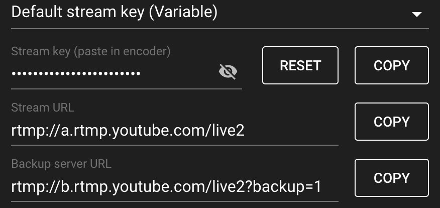

Can you tell me how you got youtube to work, Im just producing a video on the subject and cant get it to work
Will do that for you later. Just out and about at the min.
Just as a heads up, this is where most people go wrong so give it a try. Once you have created the stream in YT, go to the stream settings as shown above. When you enter these details into your DJI GO4 app, select RTMP server. When you enter the details it needs to be the stream url, followed by a forward slash, then followed by the stream key. If this doesn't work let me know.
GO4 and GO dont give you the option to enter the stream key,just the RTMP server address, Ive tried this on IOS and Android.

where are you (if you are) entering the stream key ? My app doesn’t ask for it
In the Go4 app, you tap on the 3 dots on the upper righthand corner.
scroll down to "Choose live Streaming Platform" tap on it and you will see Icons for FBLive/Youtube/RTMP
Use the RTMP and enter in the info "Skytech" posted along with your own Youtube ID info.

I know that, but as I’ve said 2 times the app doesn’t

And again, the app just asks for RTMP details it does not ask for stream key

Does it ask for the streaming key in the next screen after you enter RTMP details?

No it doesn’t ask for the stream key and yes i have 2k subs on my channel

Ive done a video showing the testing, maybe someone has an idea what if anything im doing wrong
Watched your video and you are still not doing what I suggested in #6 post!!!!!!!! It seems you are only entering the stream URL. You need to follow that with Stream key. Just follow my post #6.
the video clearly shows and I state several times that the app does not ask for the stream key or give you an option to enter one unless you enter after the stream URL maybe ?
When it says 'Create Custom Live Broadcast', after rtmp://a.rtmp.youtube.com/live2 you need add (to this line... not the next page!) add a forward slash / followed by the 'stream key' as given on your youtube stream setup. So it would look something like this........ rtmp://a.rtmp.youtube.com/live2/9zap-fg0a-bj46-bla bla bla. THEN click next ?
