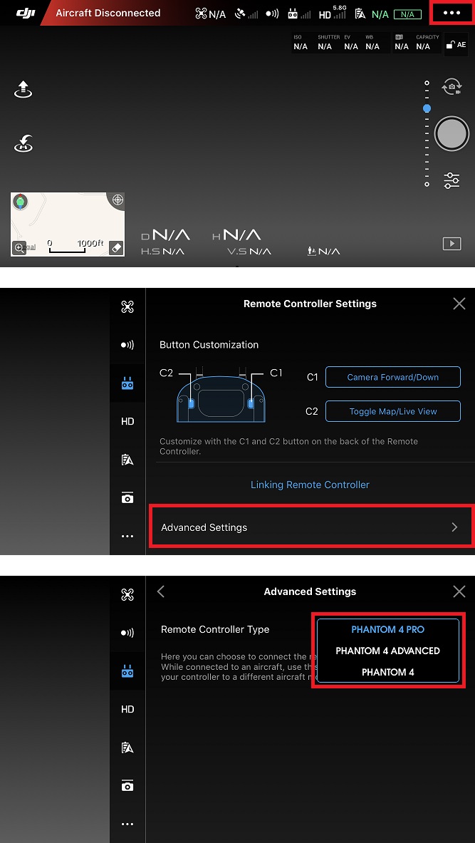

You need to connect the remote controller to DJI GO and change the following setting to "PHANTOM 4" before attempting to link the remote controller to the Phantom.
