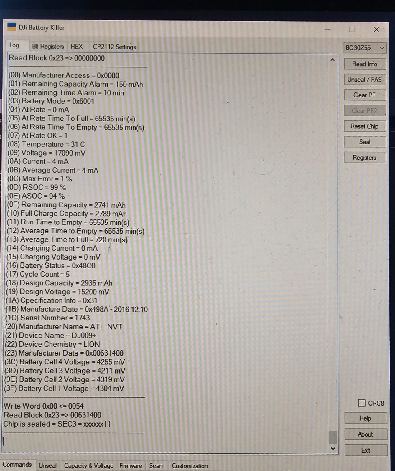

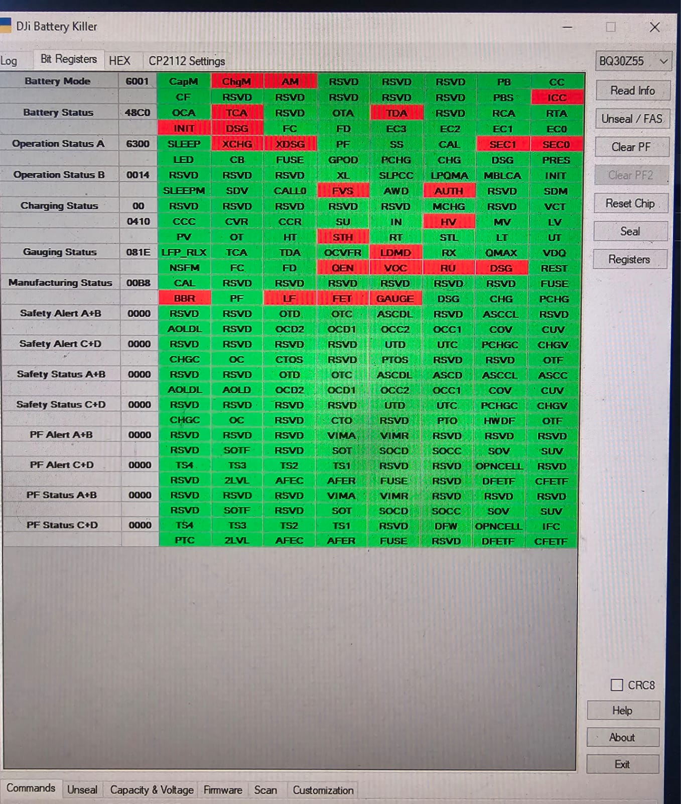

Hello everyone,
I recently recharged my dead ph4 battery using a balance charger, and the battery holds voltage perfectly fine(around 3.9 for all 4 cells). After that using cp2112 to connect the board to DJI battery killer software I was able to reset and remove PF flags but never able to remove these flags (XCHG, XDSG, SEC1, SEC2) also after hitting the read info button on log value (0C)Max Error = 1%
Shown.
Also, I plugged the original Dji charger into the battery, and the battery charged normally but after plug into the drone, the drone did not start (no beeping, no sounds nothing) also battery shut off around 5s (after plugging into the drone and start battery). Please help!
Chip - BQ30Z55
Phantom 4 Battery

I figured out what happened and now the battery is connecting and also drone starting normally but cannot take off (shows battery authentication error)

Hello everyone,
Shown.
Chip - BQ30Z55
Phantom 4 Battery

We could do with screen shots showing what the issue is, ive fixed p3 batteries and spark bats with the BK board and software, however i have tried mini 2 and air 2 batteries that simply refused to repair
Hi, not sure if resolved. The only time you will get an (shows battery authentication error), is if battery has not been sealed. If you are using TRB or Battery Killer, after clearing pf, u must click seal. Otherwise it will give authentication issues
