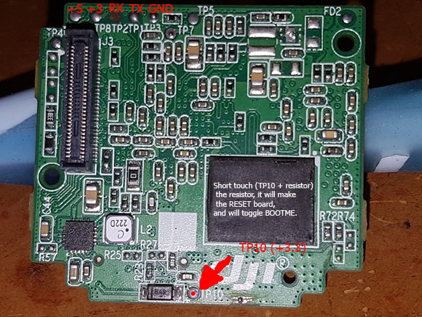

@gaucho The process works well with the Ground Station but errors out on the Air Module. Do you have any input on a solution to the above? It looks like a number of folks are experiencing the same issue.
Also on the Air Unit, is there any other pads that are equivalent to the 3V3 and BSEL?
Thanks,

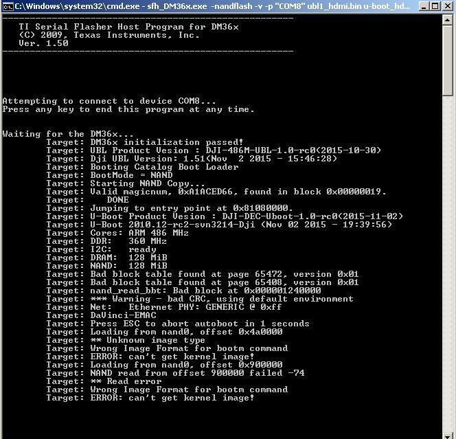

another one bites the dust. When connected to usb on 3 different pcs no version info was displayed, tried several cables, nothing. After flashing the ground unit only, there everything was fine, I get boot loop. Anybody has any similar issues?

ok.so that would be usb controller.that explains no connection at all.but also on the air unit there is no info on any firmware.but they link fine, both leds on air unit go to green, here is the 5th usb cable on 3rd pc :(
that was weird. I tried 5-6 USB cables, none worked on lightbridge, but worked just fine on other stuff. I think 7th cable worked, only on rear USB port of the motherboard. Quite sensitive to USB cables :((

Unfortunately, the Rx pad came off of my ground unit. I tried using the second set of Rx/Tx/GND pads down by the antenna, but the flashing process (which had worked in the past) just repeatedly says "Target:". Can the second set of Rx/Tx/GND pads be used for this process?
Also, I'm connecting the Tx pin on the FT232RL to the Tx pin on the LB -- can someone please confirm that this is correct?

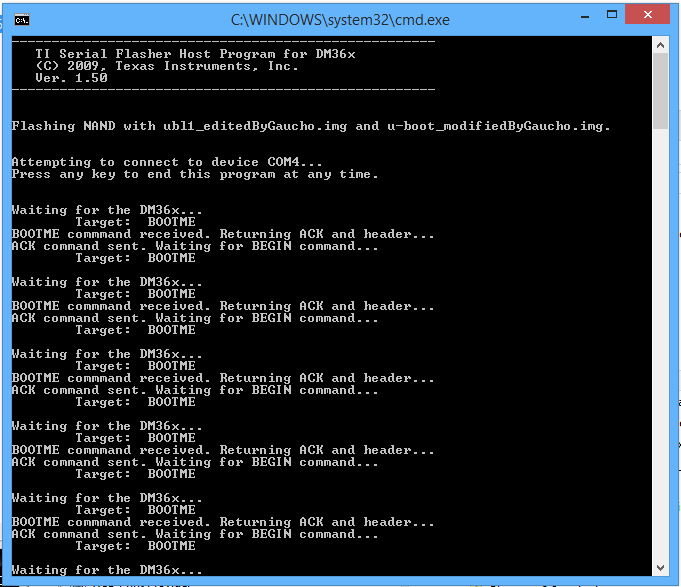

Hi guys, Lightbridge 1 Air Unit issue here
when trying to run according to steps on page #1 we get this.. (there is mentioned a line containing Target: CORRUPT - what can this mean??)
Code:
  TI Serial Flasher Host Program for DM36x
  (C) 2009, Texas Instruments, Inc.
  Ver. 1.50
Flashing NAND with ubl1_editedByGaucho.img and u-boot_modifiedByGaucho.img.
Attempting to connect to device COM2...
Press any key to end this program at any time.
Waiting for the DM36x...
       Target:
       Target:
       Target:  BOOTME
BOOTME commmand received. Returning ACK and header...
ACK command sent. Waiting for BEGIN command...
       Target:   BEGIN
BEGIN commmand received. Sending CRC table...
100% [                                                              ]
                          CRC table sent....
Waiting for DONE...
       Target: CORRUPT
       Target:  BOOTME
       Target:  BOOTME
       Target:  BOOTME
       Target:  BOOTME
       Target:  BOOTME
       Target:  BOOTME
       Target:  BOOTME
       Target:  BOOTME
       Target:  BOOTME
       Target:  BOOTME
       Target:  BOOTME
       Target:  BOOTME
       Target:  BOOTME
       Target:  BOOTME
       Target:  BOOTME
       Target:  BOOTME
       Target:  BOOTME
When trying to run without bootpin it gives us this. Appears like the NAND is empty.. what can we try to do?
