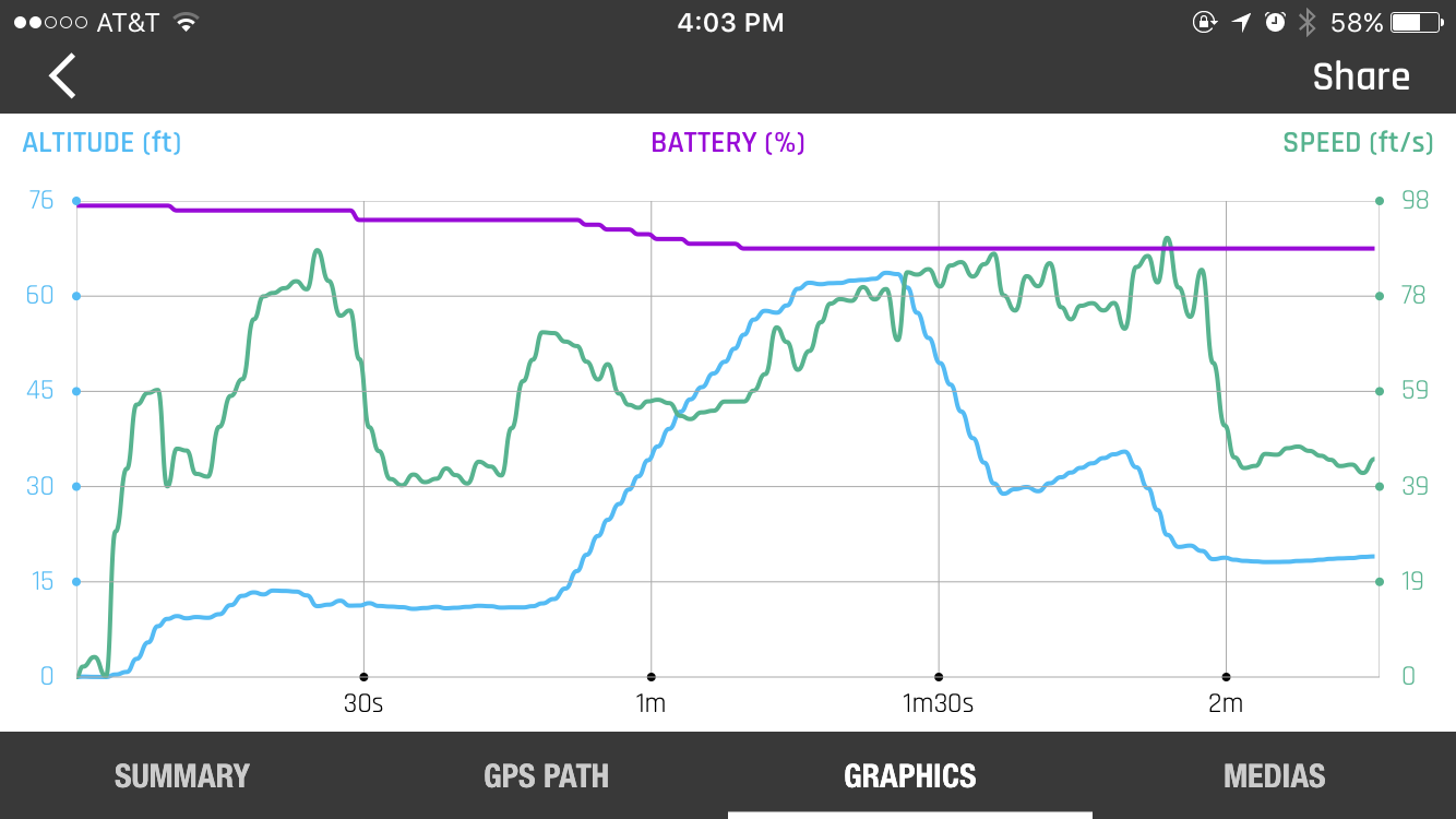

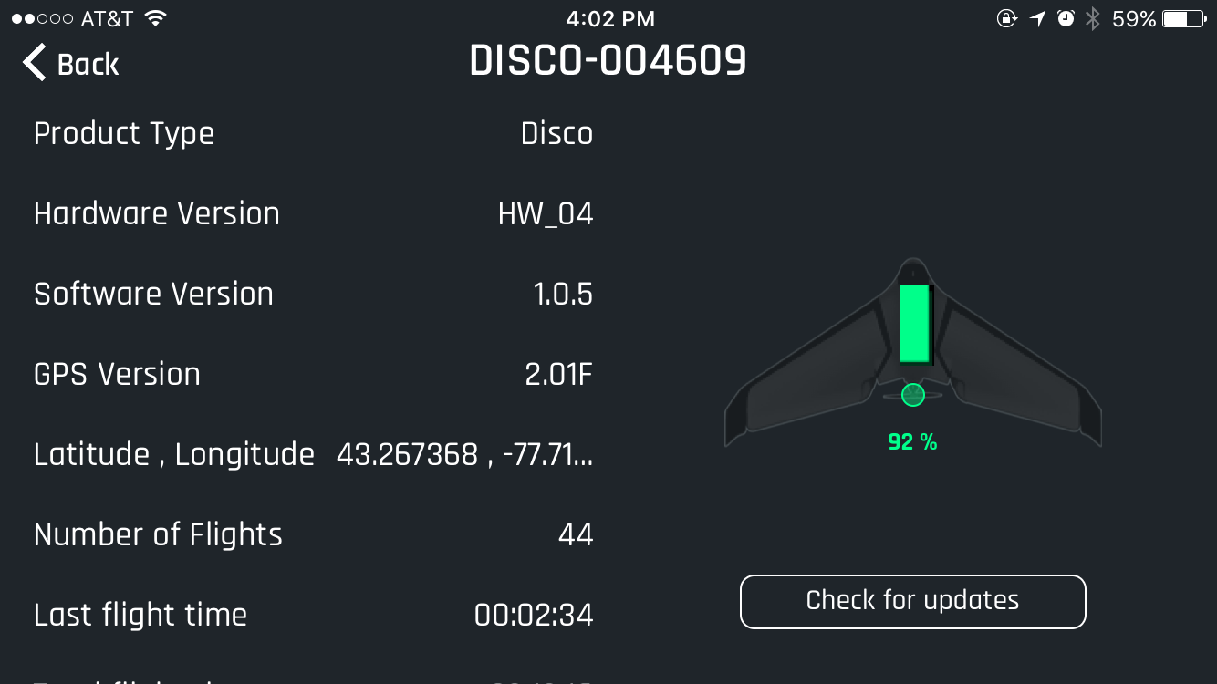

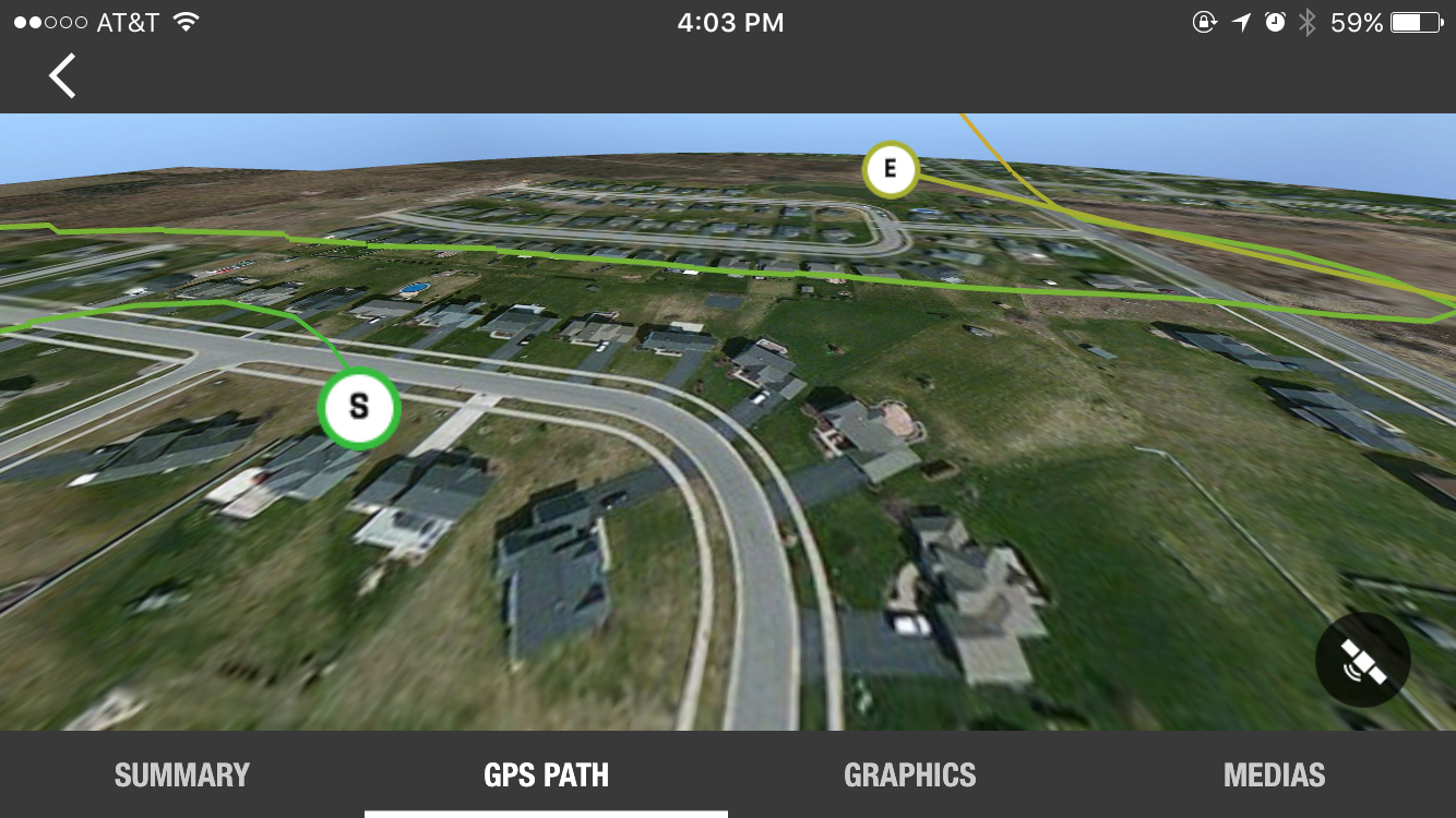

The controller had a full disconnect from the bird. Thats what happened. I have attached images of the onboard computer and its readings for the entire flight duration. Here they are again. IMG_6064 2.PNG IMG_6066 2.PNG IMG_6065 2.PNG S is the start of the flight. On the ground and E is the end of the flight, That is in the air............ The E should be on the ground even if it crashed.

Right, looking at that, I would say that at the 'end' the aircraft climbed sharply (ie the yellow line at the end) speed over the ground (ie slightly less yellow and more greenish) slowed , stalled and then gravity took over. Hence the crash.
No indication of what the airspeed actually was.

The air speed was around 70-80 feet per second. This did not stall, it was a powered dive. The log on this is not like an normal log. Even after a crash the E ends up on the ground where the bird crashed. This is still in the air. It was a complete system failure. The FPV footage shows the bird flying at level and then stops.

Please post the FVP footage if you can.........I still think a deep full power stall caused the crash.
Did you initiate the steep climb or did the 'flight controller' do that?
IMG_6078.PNG More pictures and stuff. Please note two pictures showing the flight info. Notice how the one says "Crashed" that is triggered even if you set it down hard. Notice my last flight? The ill fated flight? No crash..... I think you are missing the point. There was a complete disconnect. Where it shows E in mid-flight? That is where I was no longer in control or had any communication with the plane. View attachment 66892 View attachment 66892 View attachment 66893 I will up load the video in a bit. The contrast is horrible so I will clean it up in final cut pro. You are saying something that I and two other witness's did not see and we were standing there. It was flying level and power dived. Dive under throttle is not a stall.

That was not a very steep climb. This thing is moving at 45-60 mph most of the time. The software limits the climb rate to whatever is best for the drone regardless of my input. It sort of removes the complete fun of the experience but still leaves enough to keep you wanting to fly it. It is like an autopilot that is very loose. It watches for movements and throttle pushes that could endanger the aircraft and it wont let you do them.

This is how far off the ground it was when everything just stopped functioning properly.
