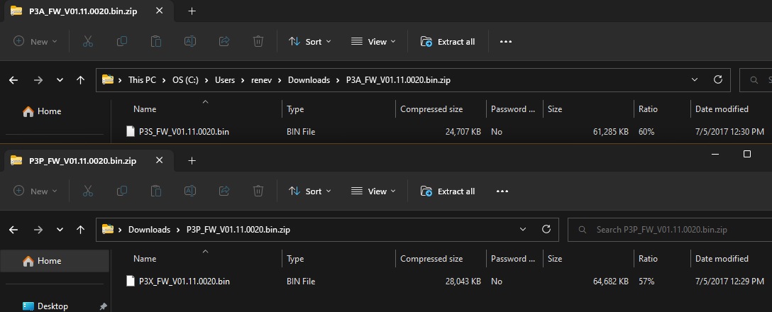

You're right, I did researched it. Exact same bin name and number with different size in it.
