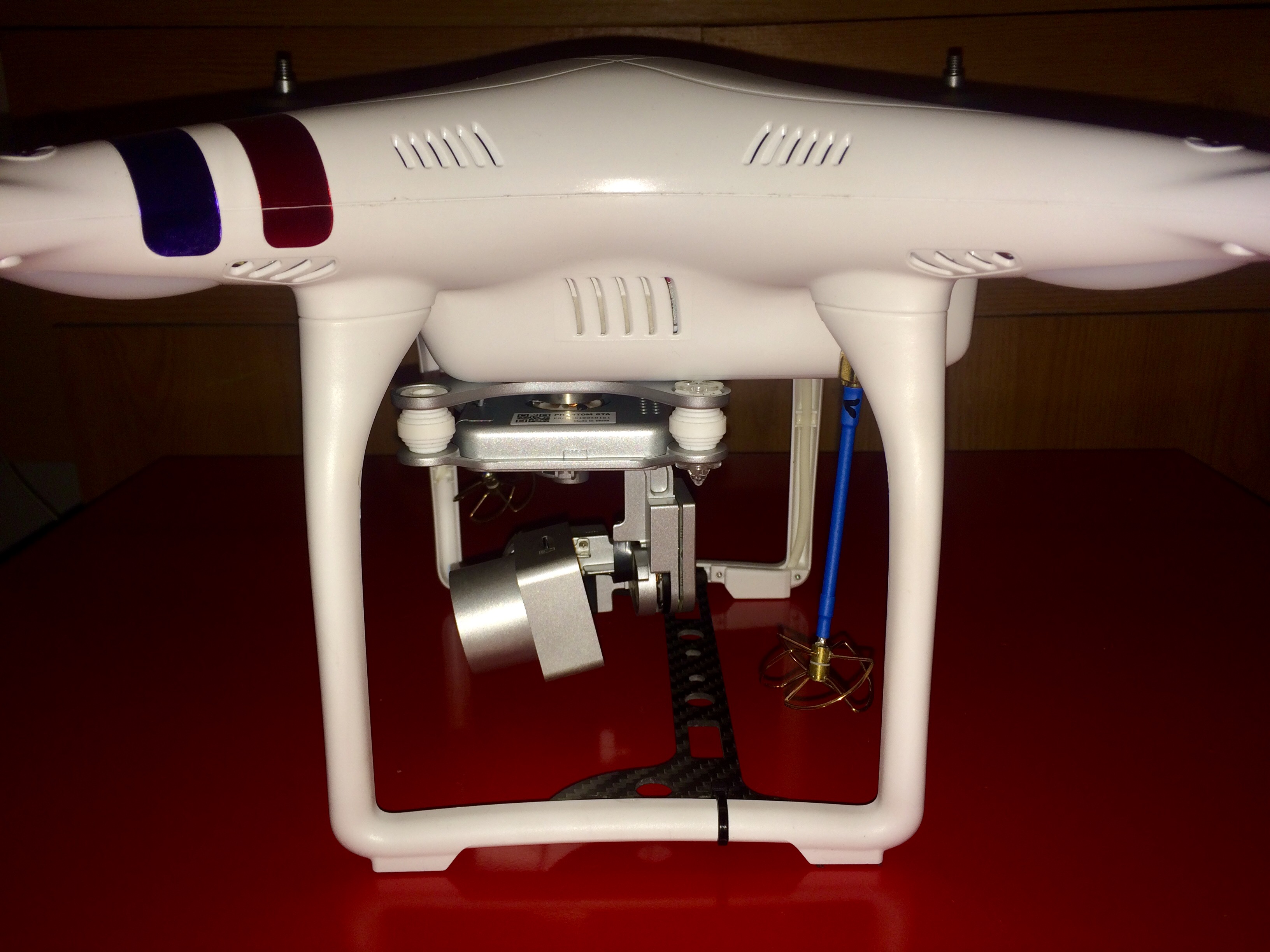

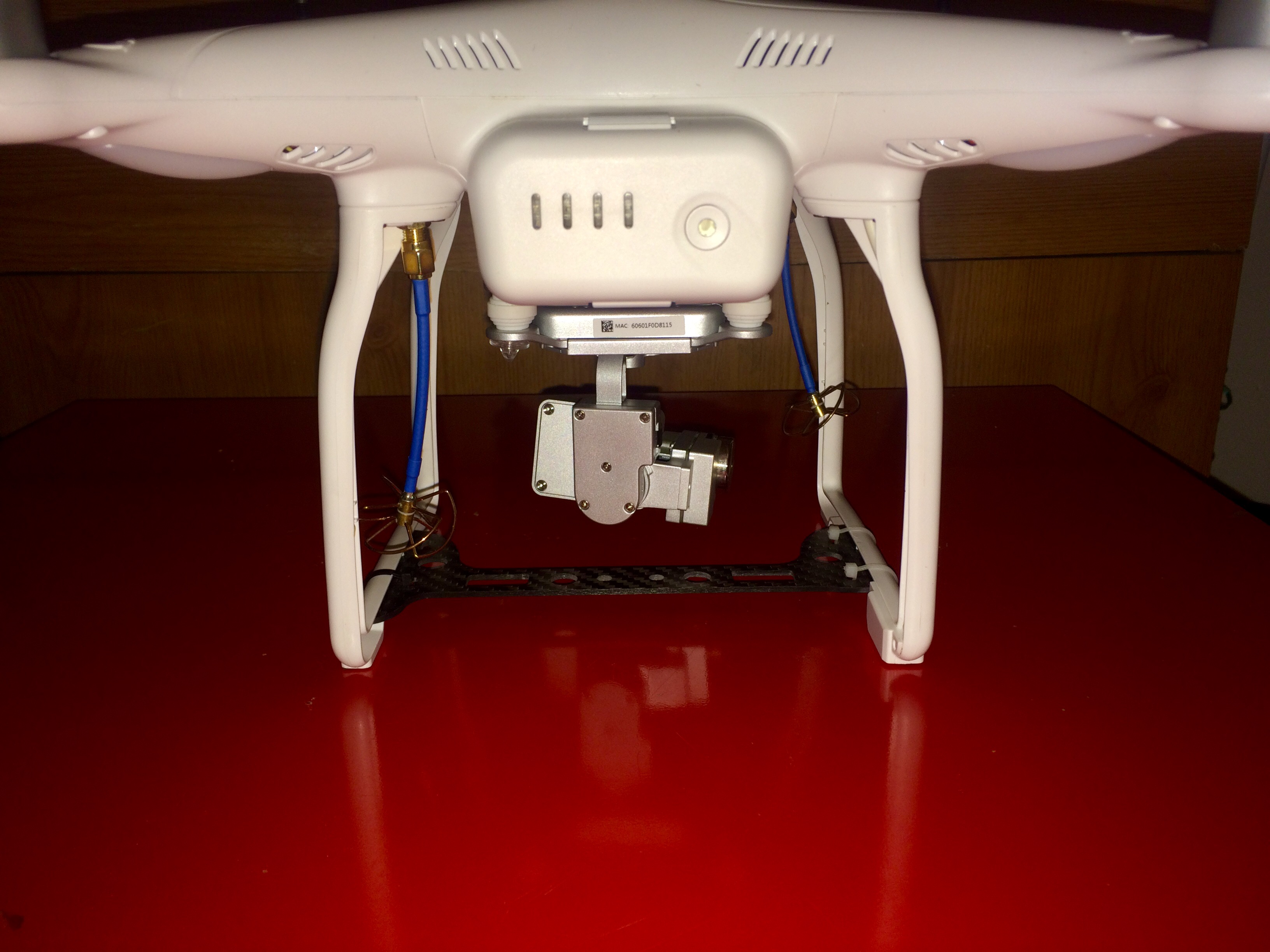

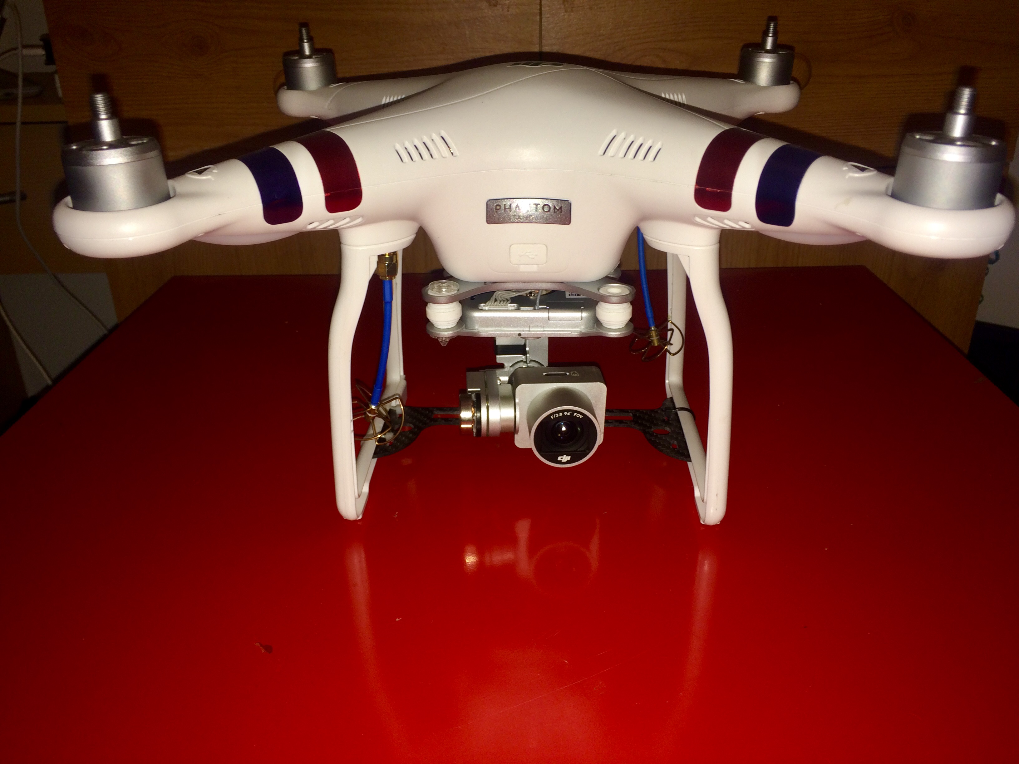

My very own 5.8 RX side antenna mod.

@longdog i believe dbs moved the 2.4 patches from his vision to the fron of the bird and it made a big difference. If you go to the dbs mods website he has info or vid on there about it. If you use microstrip/patch antennas on the tx side you should use dipoles on the birdside..if you use helicals on the tx then clovers on birdside. If you use helical make sure rh or lh match the birdside

@longdog, the dbs panel is a patch antenna (microstrip) and was made to work with the stock birside antennas. The difference using a dipole on the bird vs stock patch is radiation pattern and dbi..patches are more directional and dipoles are omnidirectional. There are a lot of great write ups out there and ill see if i can find a link for you. But if you currently have the dbs panel and want more range just get a couple amps!! Or you can make some antennas too. They are fairly easy to make. I just finished a few sets of dipoles

If I understand, it's really just copper wire. If I pick some up from lowes, I can make my own antenna to fit the underside of the bird sufficiently. My hope would be to make a strong signal that works in all directions so I am not having to fly sideways or something like that.
If you want to mod your bird I will be more than happy to let you borrow a set of my dipoles.
