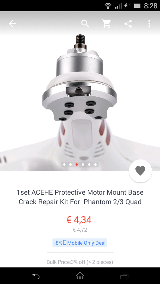

The Phantom design is prone to them regardless of when made ... old or new. I had cracks start to show on one arm only a couple of months after buying ... but being a dab hand with fixing models .. I made decision to fix it myself instead of sending to DJI / Seller to just get another that will likely do same again.
So I first eased the cracks a touch with a scalpel blade and put in some PU glue. That expands with moisture and fills every crack it finds. You have to be careful to not allow it to expand and push joint apart - so it needs to be clamped or taped. Once it had set - I then sanded it back flush and then fitted metal end plates bought of eBay to give some support and protection to all 4 arms.

Thanks solentlife for the advice. What metal end plates did you use? Thanks again
I use this
Reactions: TheAusDrone
There are plenty of sellers on eBay with end plates. Just make sure they also include the longer screws ..... the motor mount screws secure the plates and need to be slightly longer to compensate.
Note - never use these longer screws to mount motor if you remove the plates.
