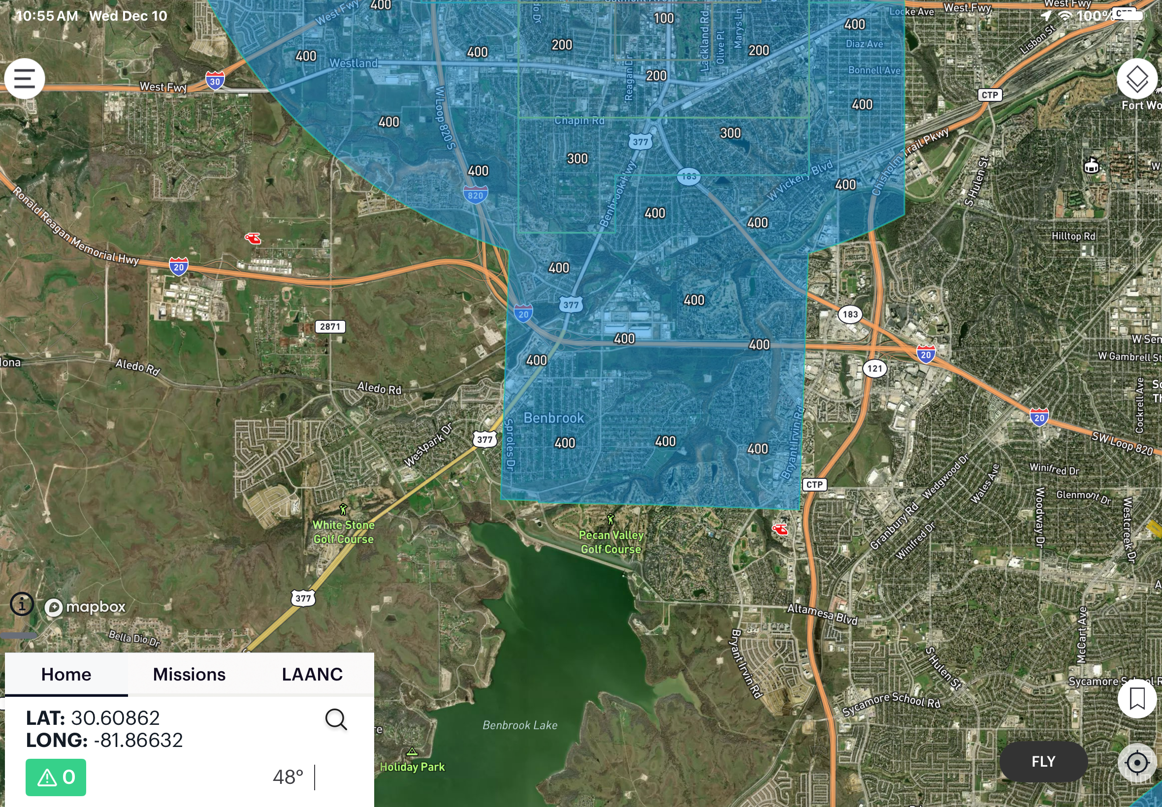

I don't see any airspace restriction in the Benbrook area, other than the normal 400' maximum altitude limit due to DFW class B airspace. (Blue)
(I use Aloft Flight Control for all my LAANC FAA clearances in restricted or controlled airspace.)
