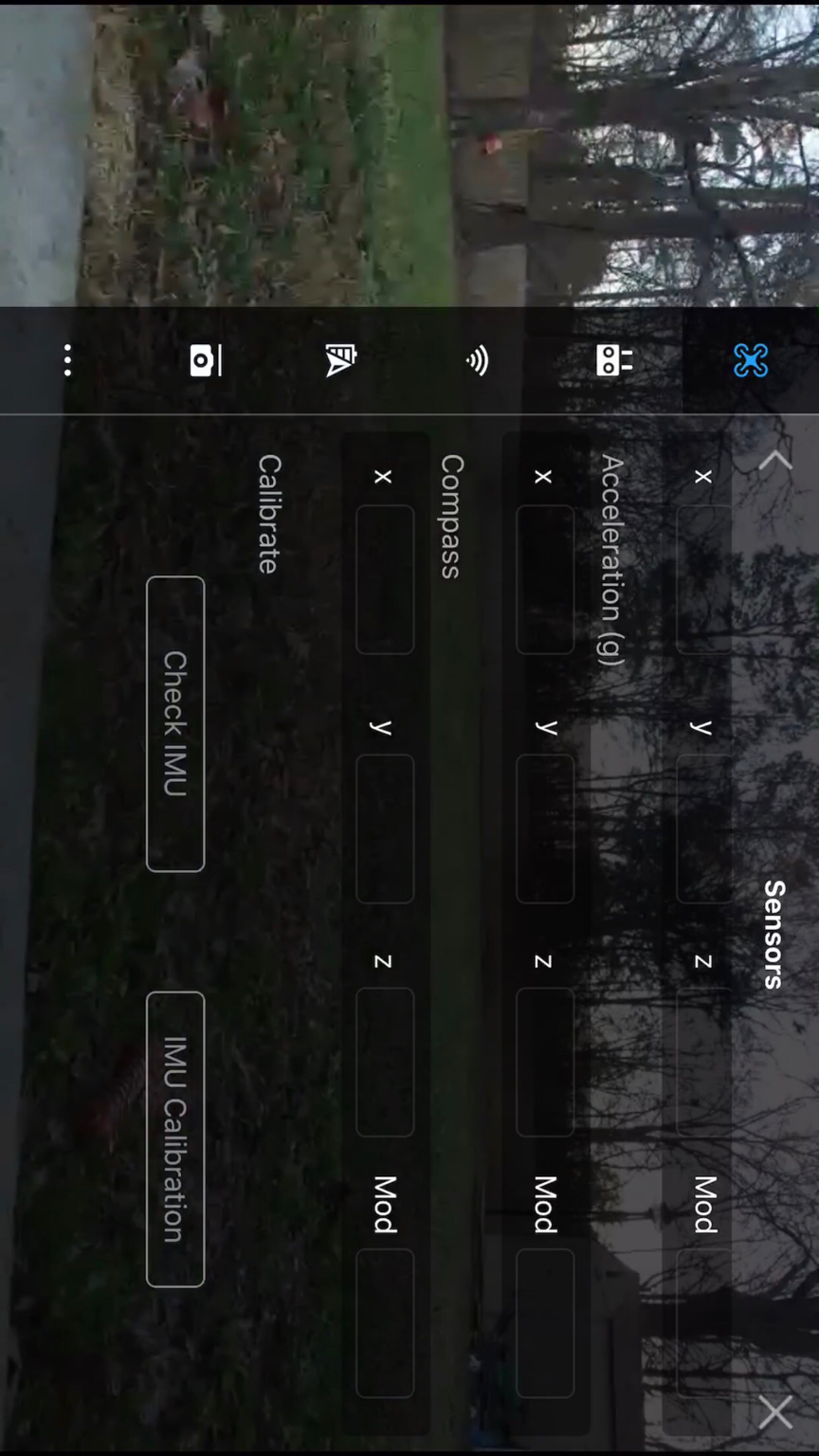

Please help. IMU error every time I turn drone on. Takes a while before it goes into flight ready mode. Unable to calibrate IMU. The button is grey and no response when I touch it

Please help. IMU error every time I turn drone on. Takes a while before it goes into flight ready mode. Unable to calibrate IMU. The button is grey and no response when I touch it View attachment 106673
Try reinstall app see if change,,,,yes be patient, just cause no reply don't mean it's not read by someone,,,I presume this p34k,,also give it a fresh relink,,,,,,no crashes, it's not just imu missing,where's compass

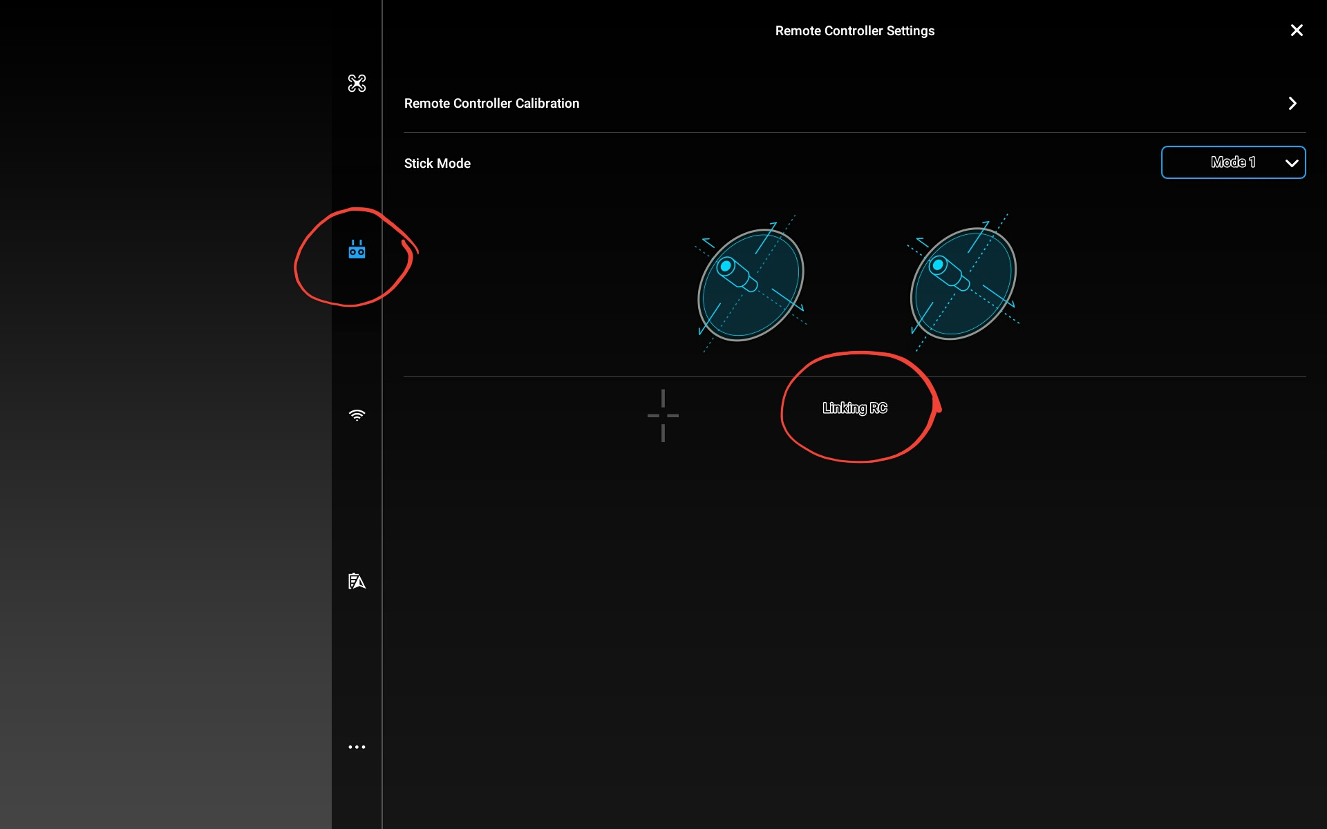

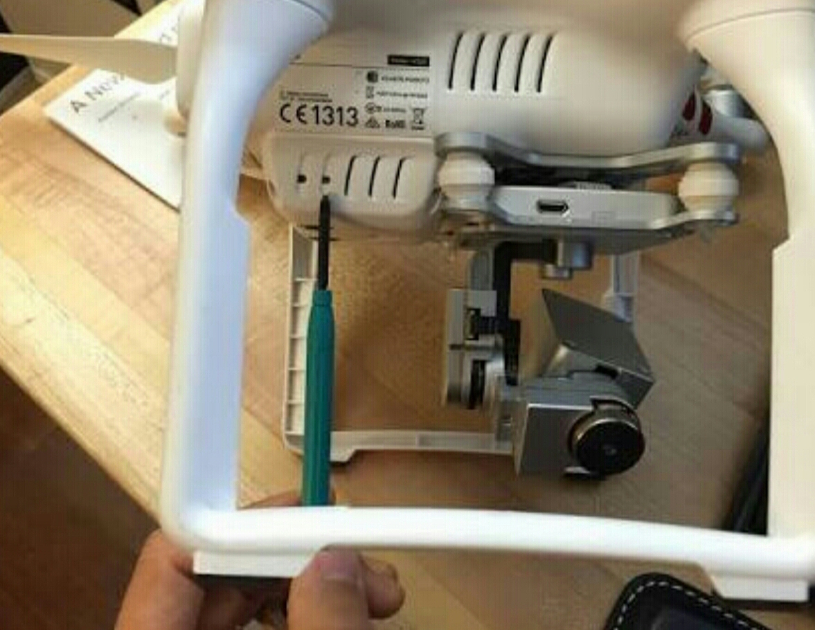

It will ask to confirm frequency when pressed just press ok and then press drone link button with pen or needle ,,,then it gives good pairing between drone and remote
It will ask to confirm frequency when pressed just press ok and then press drone link button with pen or needle ,,,then it gives good pairing between drone and remoteView attachment 106679View attachment 106678
