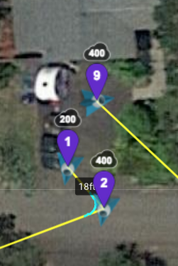

Sad day for me. I live in a natural oak forest in Oregon. I've been flying for about 2 weeks in the DJI go app. All fine and very much enjoyed it. Tried my first couple of missions in litchi. Went fine. Thought I knew what I was doing. Did a mission hub for a 7 minute mission around my home and the drone lost signal and never came back.

In case curious: my mission had 9 waypoints all at 400'. My idea was to avoid hitting any obstacles of unknown height-- there are definitely trees nearby at 250'. My home has a large enough open area for take-off and landing. The mission was a loop ending right above where I started.
My theory of where I went wrong (just a guess). First my mission had do-nothing (must be default because I didn't assign it) at end of mission. This likely not a problem on its own because mission end was over my home location. I had a good home point and good GPS 11+ satelites at launch. My controller said disconnected after a minute or so of 7 minute flight (expected). My thought is I must of accidentally tapped a up/down/right/left stick near the time the drone lost signal-- causing it to hover (don't know). Since RTH wasn't selected (error on my part) in the mission, it likely hovered until emergency landling.

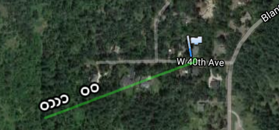

I don't really know what happened. I normally do lose video and later controller signal in my home area even in .5 mile area because of the tree canopy and terrain. Litchi shows a position for my drone. i tried to hike there tonight- very rough mountain terrain. Didn't make it.

- Is it likely last position Litchi had is accurate given that it lost signal? i.e. If I really hike/climb to that location do I have any reason to believe it accurate? My concern is that this may be last position it had signal and not real location.
- In general is here any methods to find? My mission had 9 waypoints forming a circle with the last point where I started (also the H - home position.) I thought when battery got low RTH would happen but it did not.

First point and this is neither here nor there really, but there is no RTH selection in a Litchi mission. End of mission is either, land or hover, that's it. There is really no way to know why the mission did not complete as programmed without taking a look at the flight logs as @Meta4 mentioned above. At the very least, you would be able to follow the flight profile to the last known location. You would also need to fully review your mission profile for any errors. Sorry for the loss.
End of Mission for Android Litchi Mission is called Finish Action and options are None, Go Home, Land, Back To First Waypoint or Reverse. The Go Home is basically RTH. Those settings are only for when the mission is completed at the last waypoint.
I updated my original post from yesterday with requested data. The mission was a loop-- but my mission final action was set incorrectly to "None" -- I'd of preferred RTH. If the loop had completed the final waypoint was very close to starting point.
I believe None was the correct setting. When None is set the aircraft will hover at the last waypoint until you take manual control or it runs out of battery and lands. Go Home will cause the aircraft to return to the Home Point after it reaches the last waypoint. On waypoint missions RTH will only initiate when the battery reaches 30%. This has nothing to do with Litchi Waypoint missions. I know this from experience.
End of Mission for Android Litchi Mission is called Finish Action and options are None, Go Home, Land, Back To First Waypoint or Reverse. The Go Home is basically RTH. Those settings are only for when the mission is completed.at the last waypoint. I noticed on the flight log at 1m 38.5s Downlink Restored. You possibly could have caused an error when you momentarily regained RC.

I'm convinced now I hit a tree or land as 400' absolute wasn't enough for my loop to complete as others have shown me.
I've hiked for miles and not found the drone. I wish I had put a 'tile' or similar on it. Lots of high grass, and brush where I live. i.e. I may of been within 20 feet of it and not known it-- just comes with the terrain.
