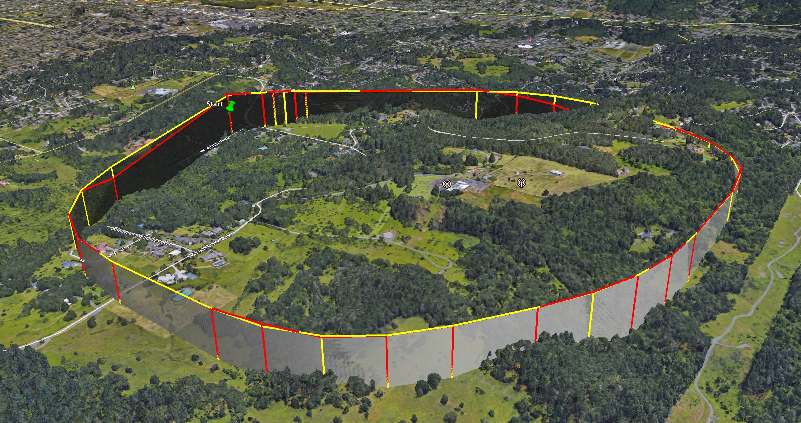

Also- Loved the posts with pictures in 3D 'fence' for my route. I'd gather this is google earth and would like to learn how to do this. Very cool.

It is from Google Earth, and it should be as simple as choosing "Export as 3D KML Path" from Mission Hub, but that does not always seem to work properly. Litchi creates a path relative to ground and assigns relative altitudes based on waypoint altitude, but gets it badly wrong at times, at least in relation to the DEM that Google Earth uses. For example, in the image below the red track is the exported Litchi kml path, which obviously does not maintain a constant 400 ft above the takeoff point. The yellow track is the same kml file, but modified to define the altitude absolutely MSL as the takeoff elevation plus 400 ft.
Dang is that cool. Nice work.

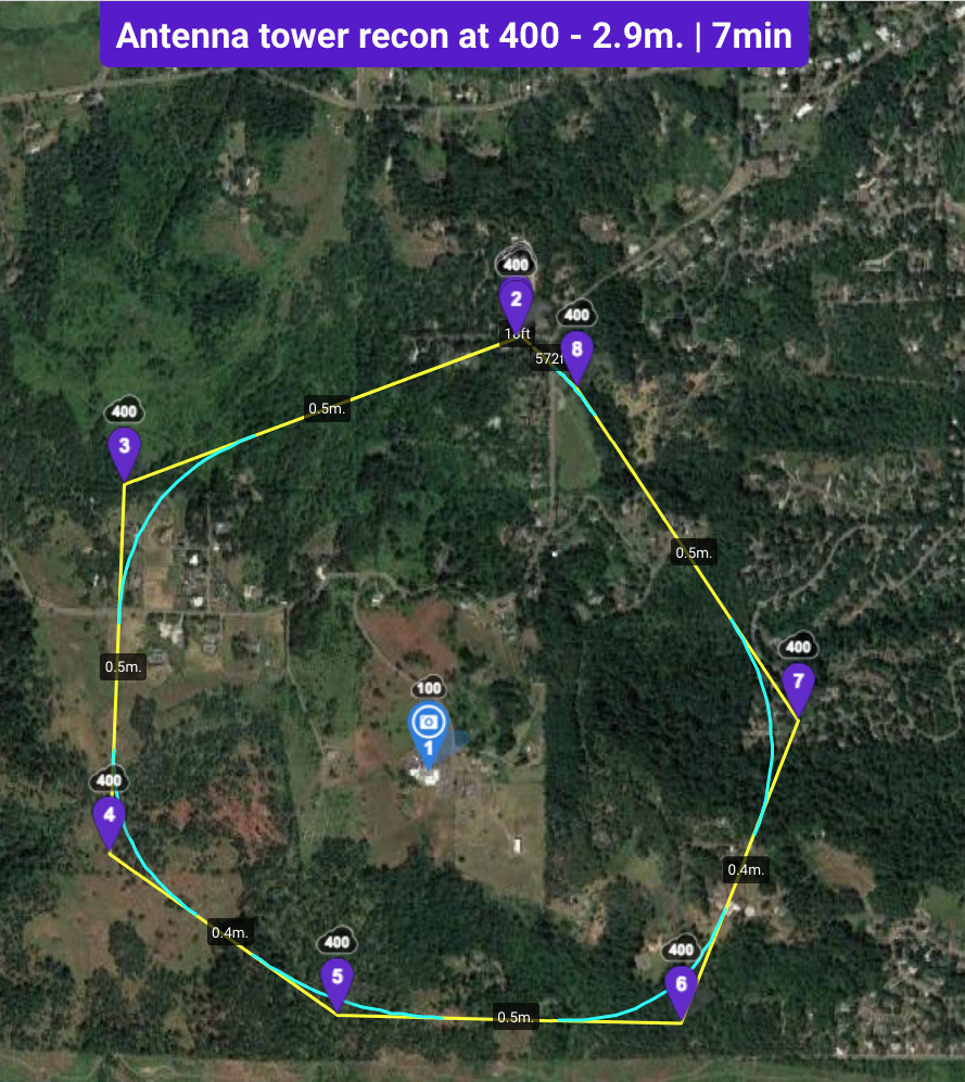

View attachment 91428 View attachment 91426 Hello folks-
Sad day for me. I live in a natural oak forest in Oregon. I've been flying for about 2 weeks in the DJI go app. All fine and very much enjoyed it. Tried my first couple of missions in litchi. Went fine. Thought I knew what I was doing. Did a mission hub for a 7 minute mission around my home and the drone lost signal and never came back.
So for the practical stuff:
- Is there any way to determine my drone's last position so I might be able to collect it?
In case curious: my mission had 9 waypoints all at 400'. My idea was to avoid hitting any obstacles of unknown height-- there are definitely trees nearby at 250'. My home has a large enough open area for take-off and landing. The mission was a loop ending right above where I started.
My theory of where I went wrong (just a guess). First my mission had do-nothing (must be default because I didn't assign it) at end of mission. This likely not a problem on its own because mission end was over my home location. I had a good home point and good GPS 11+ satelites at launch. My controller said disconnected after a minute or so of 7 minute flight (expected). My thought is I must of accidentally tapped a up/down/right/left stick near the time the drone lost signal-- causing it to hover (don't know). Since RTH wasn't selected (error on my part) in the mission, it likely hovered until emergency landling.
I don't really know what happened. I normally do lose video and later controller signal in my home area even in .5 mile area because of the tree canopy and terrain. Litchi shows a position for my drone. i tried to hike there tonight- very rough mountain terrain. Didn't make it.
So thoughts:
- Is it likely last position Litchi had is accurate given that it lost signal? i.e. If I really hike/climb to that location do I have any reason to believe it accurate? My concern is that this may be last position it had signal and not real location.
- In general is here any methods to find? My mission had 9 waypoints forming a circle with the last point where I started (also the H - home position.) I thought when battery got low RTH would happen but it did not.
Anyway, thoughts/advice welcome.
-Dan
PS: I'm running latest Litchi bought for black friday sale this weekend. Drone running one back firmware from 1.9. I had been alerted to 1.9 but was waiting a bit to see how people like.
And also FYI- I flew about 4pm today (11/26). It was daylight (mostly) when the craft was lost.View attachment 91427
Flight Log: DJI Flight Log Viewer - PhantomHelp.com
Here's a link to the mission: Mission Hub - Litchi
Same thing happened to me and according to the flight log it ended up exactly where the flight log said it would be. I was flying it lower than the tree line and the drone was laying at the bottom of the exact tree the flight log said it would be. Good luck in your search.
That's a good lesson for all of us. From that, we should always "Export as 3D KML Path" and cross check our altitudes against terrain elevation. We have the tools, so why not learn to use them?

OK, updated this post since yesterday with more data. I sincerely appreciate the help understanding where I went wrong. This is a good and supportive community. -Dan (updated post from 11/26 -- now 11/27 6:25pm pacific)
So thoughts:
-Dan
