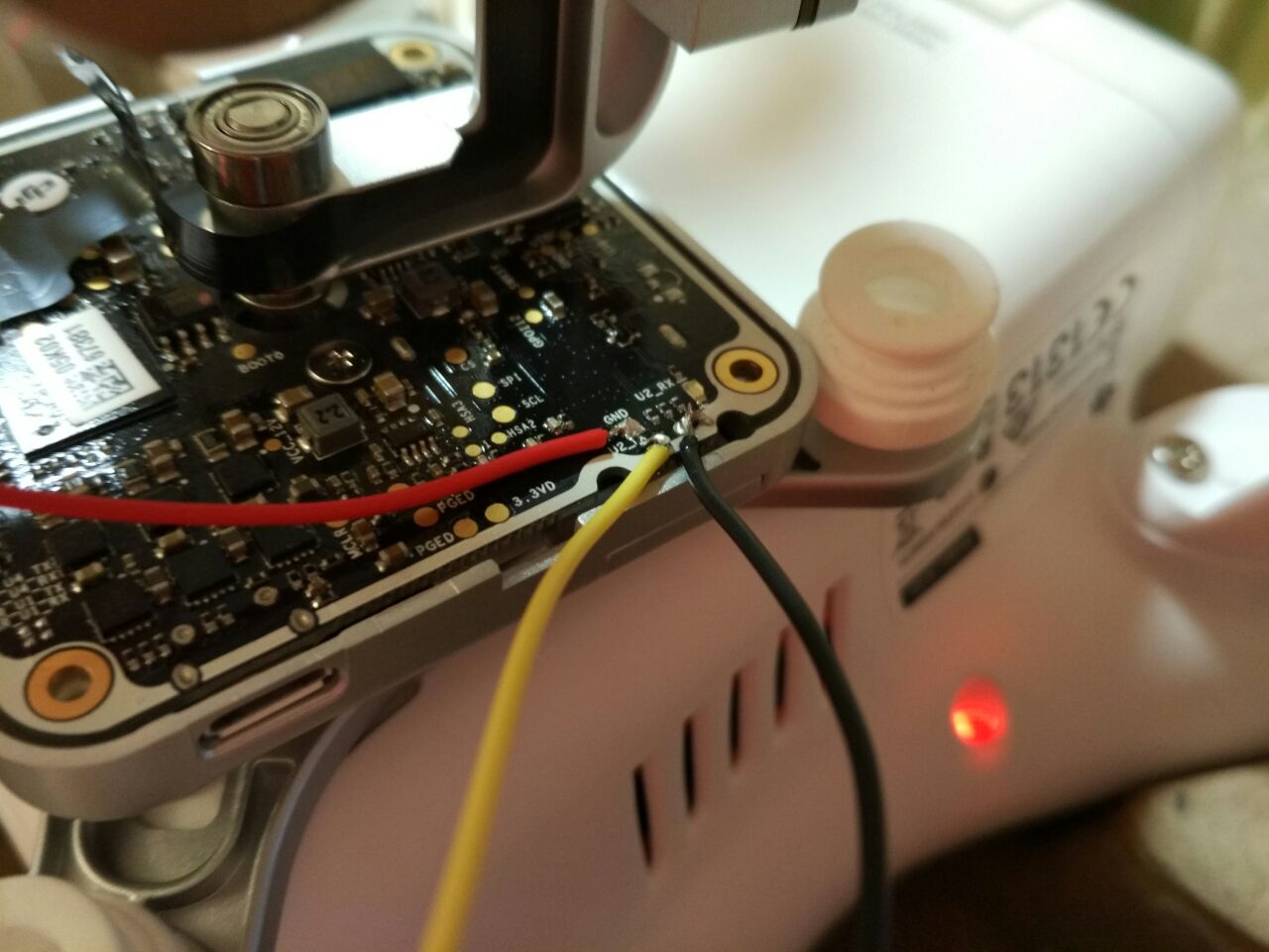

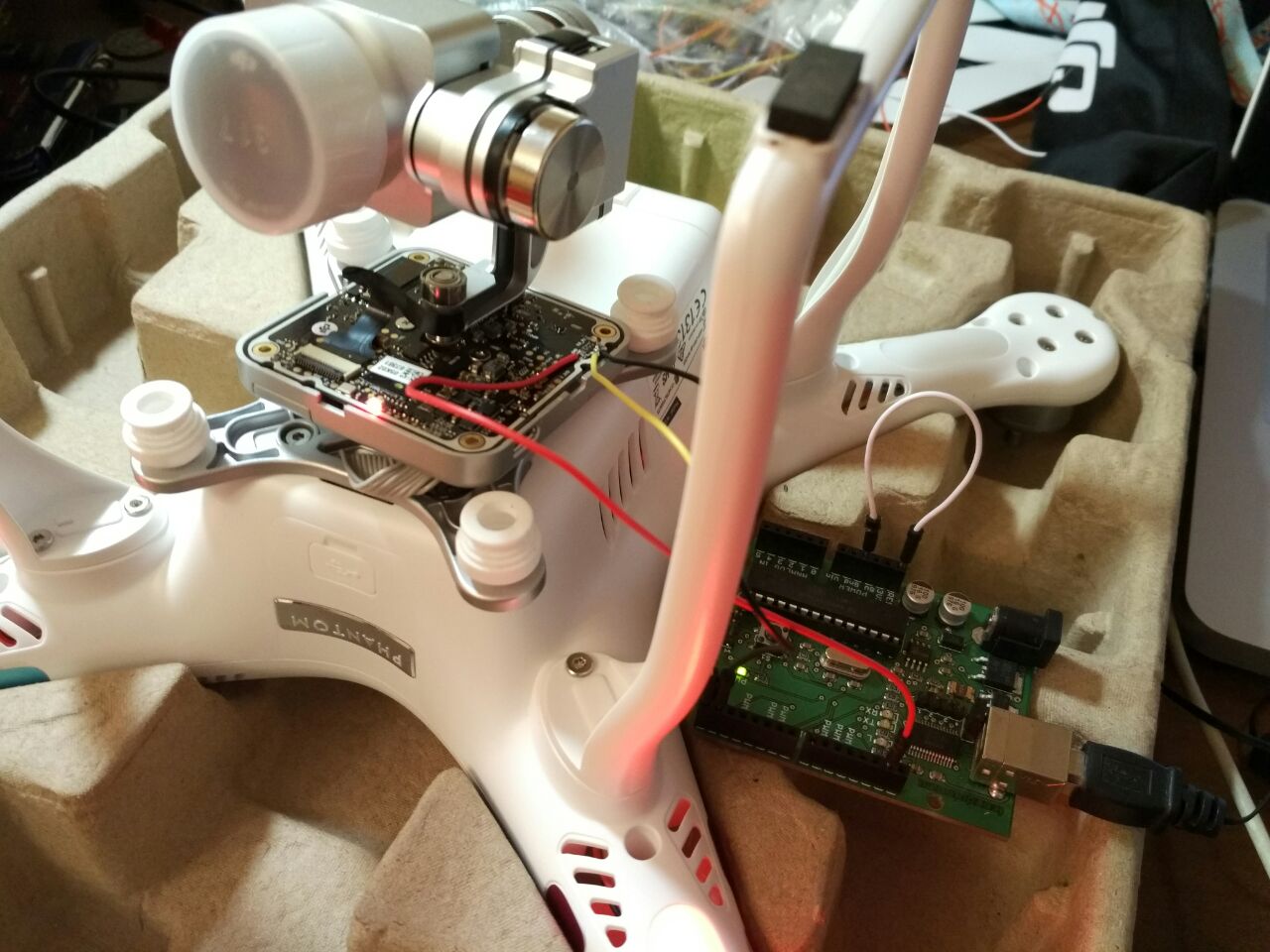

Guys, finally, the win! I've recovered both remote and drone. I found proper TX RX GND pins on gimbal board. It's definitely harder to disassemble but it was worth it. Here are the pictures of pins you need to connect with your UART adapter.
View attachment 57657 View attachment 57658 View attachment 57659
Other steps are completely the same as for remote controller, this steps you can read in the first post. Thanks everyone for this achievement!

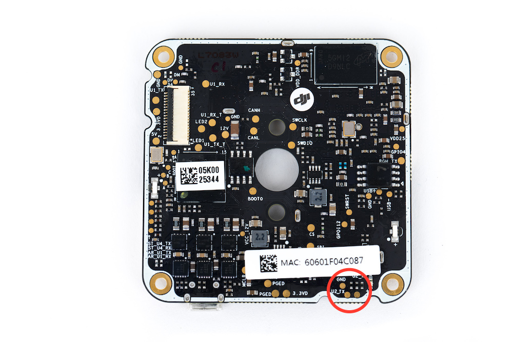

the solder point u2_rx torred off. it is not more on platine. I do not know how. Can I use instead U2 solder points the U1 solder points on upper left corner? When I use the u1 solder points PUTTY can read something but the characters are weird/strange, so i can not read. Look at the picture, that shows the terminal. It is an example. But the same appears to me when I connect to U1 solder points.
I believe it has connect u2 see beshanoe post
