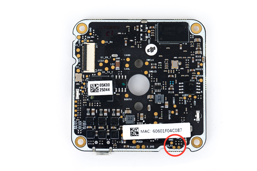

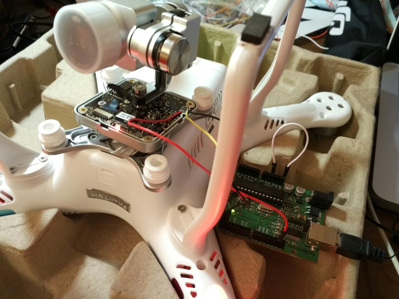

Guys, finally, the win! I've recovered both remote and drone. I found proper TX RX GND pins on gimbal board. It's definitely harder to disassemble but it was worth it. Here are the pictures of pins you need to connect with your UART adapter.
phantom3-standard-teardown-00661.jpg IMG_2016-06-20 22:05:11.jpg IMG_2016-06-20 22:05:05.jpg
Other steps are completely the same as for remote controller, this steps you can read in the first post. Thanks everyone for this achievement!
