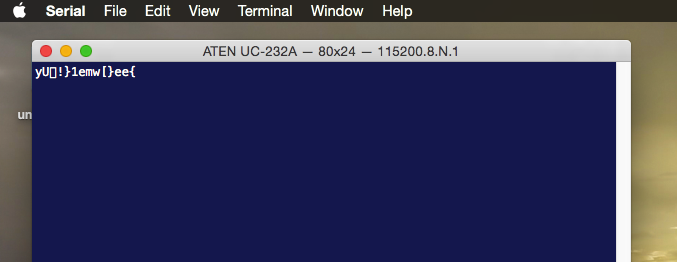

anything wrong?
speed 115200

tried different laptops, different USB TTL module CH340G and FT232RL. but same result.
Looks like you've got a damaged storage device. It's not the laptops or the USB TTL adapters, it's definitely the drone. I'll look into this more with some of my course mates (I study a degree in Electronic and Electrical Engineering) and get back to you as soon as possible!
This occurs when connected to a remote, not a drone. so there is no solution?
