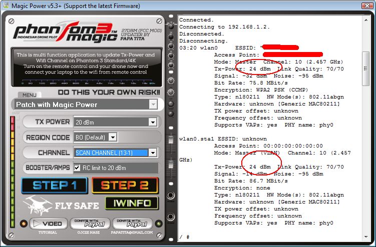

Just tried it with V5 on my 1.8+ FW on the P3S.
I set Power to 20db, nonetheles it seems to be always at 24db, anyone expereienced similair issues?
Great find and very nice implementation with the Magic Mod.
Yes. Mine is at 24db and jumps to 27db when the AC is powered on. How does channel 10 work for you?
What is the purpose of choosing TX power then?
I was wondering the same. When I did the update I didn't even choose and it was automatic at 24db. Once I connected to the AC and checked again with Telnet it was at 27db.

FInally I did change TX Power to 20dbm. As the value set from the dropdown menu had no effect I simply edited the watchlog files replacing the 2400 and 2700 values to the desired ones. Pay attenttion that the files are being automatically edited each time you make any changes to the config options in the tool. Therefore I'd suggest to select your desired options and then to edit the file just before hitting "STEP 2".
