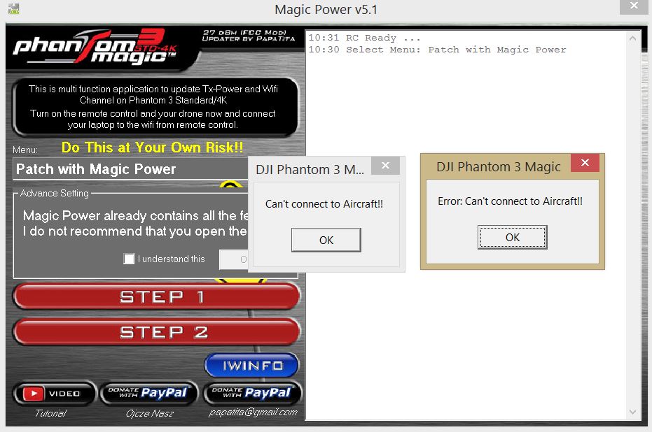

I actually don't have a LOG file I think. At least there is no log file in the folder where the program is in. I only get these messages in the program when I click step 1. Help is appreciated :).
Prior to this TX update attempt, were both AC and RC working just fine?
Have you tried to re-Link both of them? Or may be reset all wifi settings to default?
Sorry if i can't lead you precisely on the issue, since i am only guessing what could be wrong and what was really happened behind that error message....
Based on the LOG you posted above, this app just trying to test the connection to both RC and AC. While RC test was succeded, but AC test was not. That's why i'm asking you was everything working fine prior this TX update attempt.
Hope we find the answers soon...

The AC and RC are both working fine. I can connect my phone and run the DJI Go App, which just shows the camera view like normal. I tried the program on another PC, but I got the same error message. When I tried iwinfo it gave back 10060 (instead of 10061) (maybe because that pc was slow and it timed out?). Thank you for helping!

Update, I downgraded the phantom to 1.5.70, because the DJI Go app said status: 'latest firmware!' (while I was on 1.6.80). However, it still doesn't work. I get the same error message.. really hoping someone knows the fix to this.

I found the fix to my problem!
I will try to explain. I am on Windows 8.1(I don't use english as a language for Windows so I hope I translated every option correctly), I tried checking if DHCP was enabled. It was already enabled, but in the 'Network and Sharing center' I saw an option connection:wifi (click on it) --> properties --> sharing tab --> allow other network users access to this computer (switch to ON)--> settings --> Telnet server. I switched that to on instead of off. That worked for me and the range mod is now completed. Hope it works for others as well.
wow.... thats new to me.
is it some kind of firewall allowing telnet service through the network or something... have you check iwinfo afterward? just to make sure the app done the mod completelly...

Not sure what it exactly did, I am not so experienced with network stuff so I just went through the settings and changed things that seemed relevant :D. I checked iwinfo with telnet android app, and it showed Tx power 24dBm etc. Before the mod, I couldn't even connect to the drone via telnet, so I guess everything went well.
