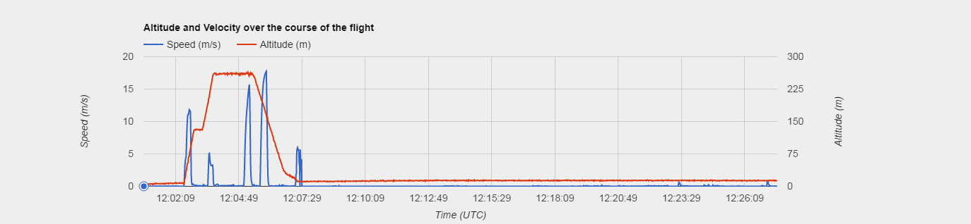

Yes. I think the aircraft dropped the GPS signal, and in the same time there was a disconnect from the DJI app. In a short period there was controller signal, and I press down the left stick. (No emer stop, only letdown), cause I dont want to fall down from a high altitude. So I manage to down to 10 m (but i didn't know the altitude). Then the aircraft tried to hover but there were a tree. I recover the dat file with maps made easy's tool.

Yes. I think the aircraft dropped the GPS signal, and in the same time there was a disconnect from the DJI app. In a short period there was controller signal, and I press down the left stick. (No emer stop, only letdown), cause I dont want to fall down from a high altitude. So I manage to down to 10 m (but i didn't know the altitude). Then the aircraft tried to hover but there were a tree. I recover the dat file with maps made easy's tool.View attachment 67674
i thought disconnected from dji.go app won't make any difference unless we're on F mode. so i think you were saying it was disconected from the RC. once it regained signal, you led it down as low as possible without having eyesight to the AC, and then it crashed to the tree.
anyway, the main issue is why it loose GPS while on the sky? this is very dangerous. . , .

Yup, you are right. I highlighted the disconnection from the DJI go app, cause I didn't have telemetry, so I don' t know anything about the AC. Yes, the GPS signal. Don't know but there were a miltitary base with a tarnsmission tower (or something like that). Maybe it's signal jammed, but I really don't know.
Today I made a test flight, everthing seemed to be ok.

owh. . . i see. . . everything seem clear now. . . you did the last test on the same area?

No, thanks, Once it was enough. :D The afternoon test was in the middle of nowhere without any problem. The transmission tower was more than 1km far.
But I saw the transmission tower and two antennas are directly towards my flight direction when the "accident" happened. So be careful!

that makes sense. . . so. . . they really have those jamming equipment which renders phantom's imu and gps fail. . .
i thought it only exists in the movie. . . [emoji16]
