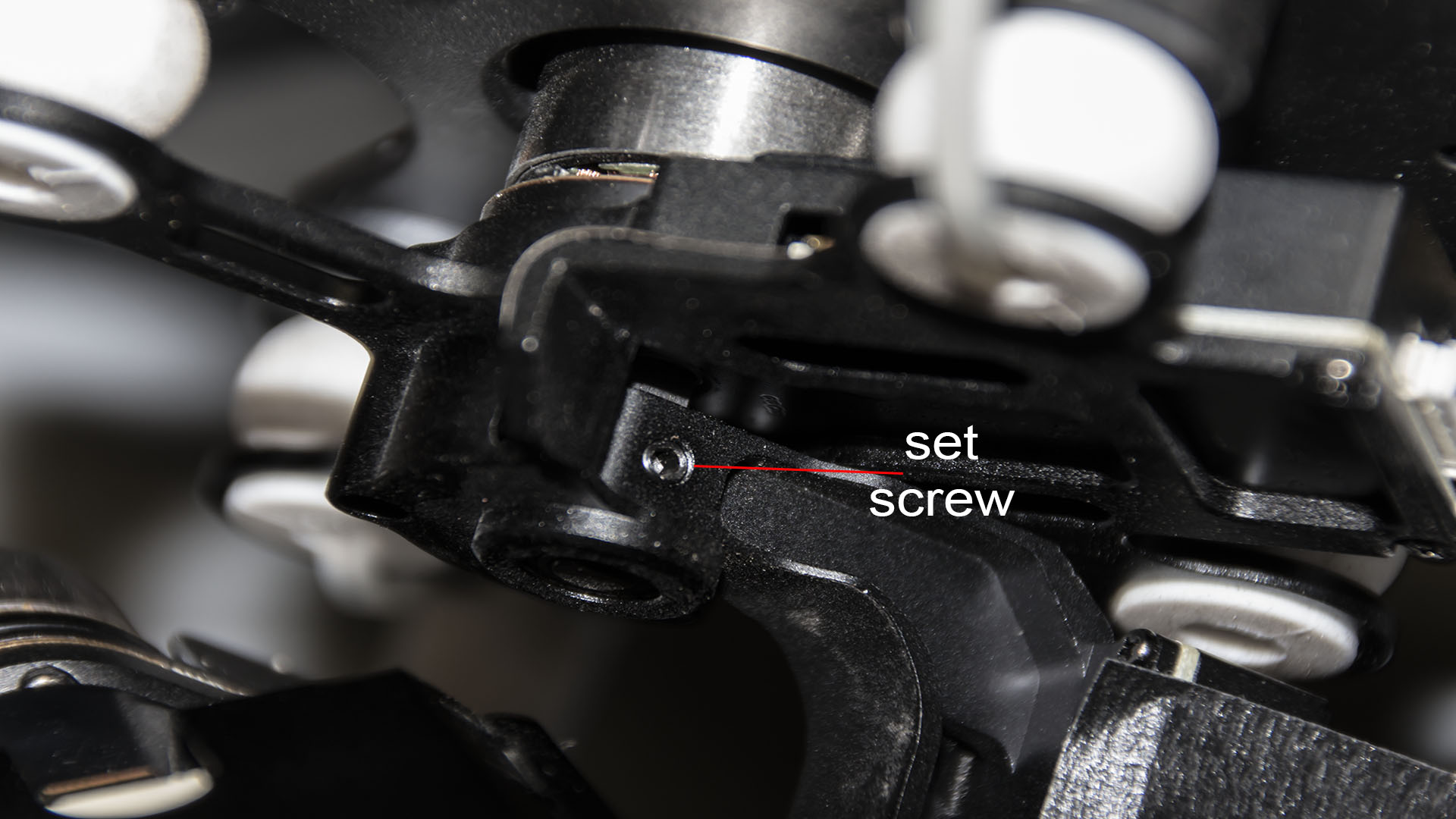

There is a set screw on the yaw arm that will cause problems if it is loose.
