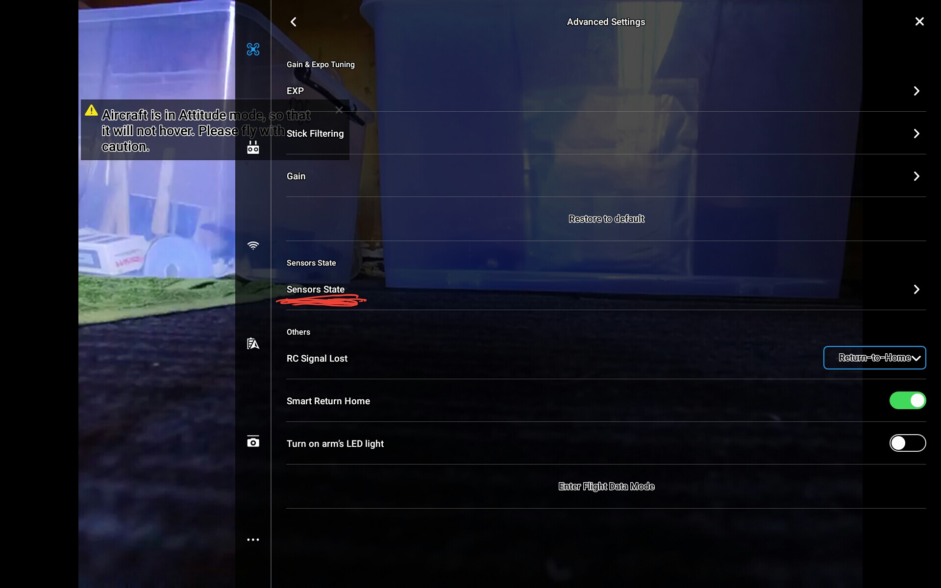

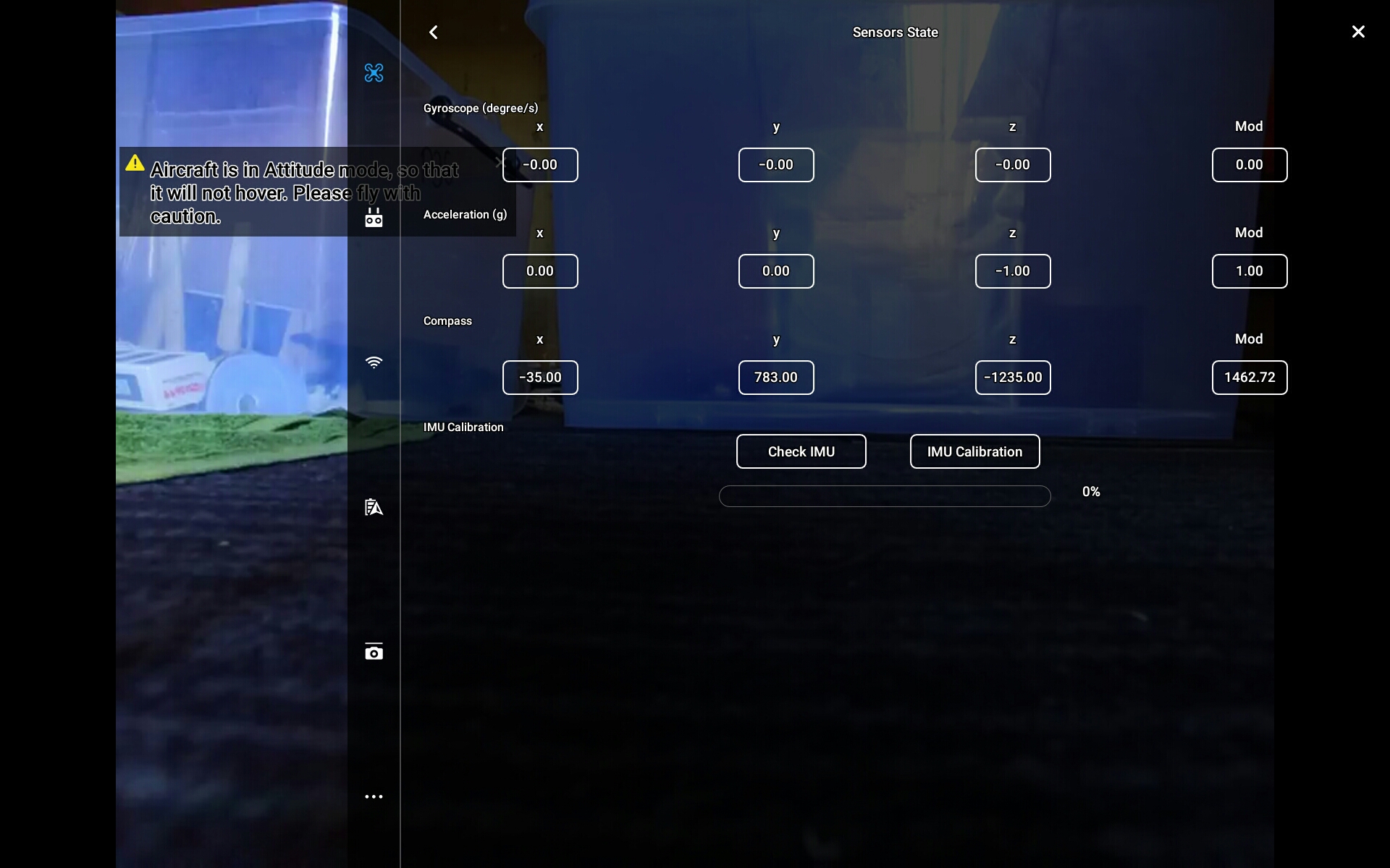

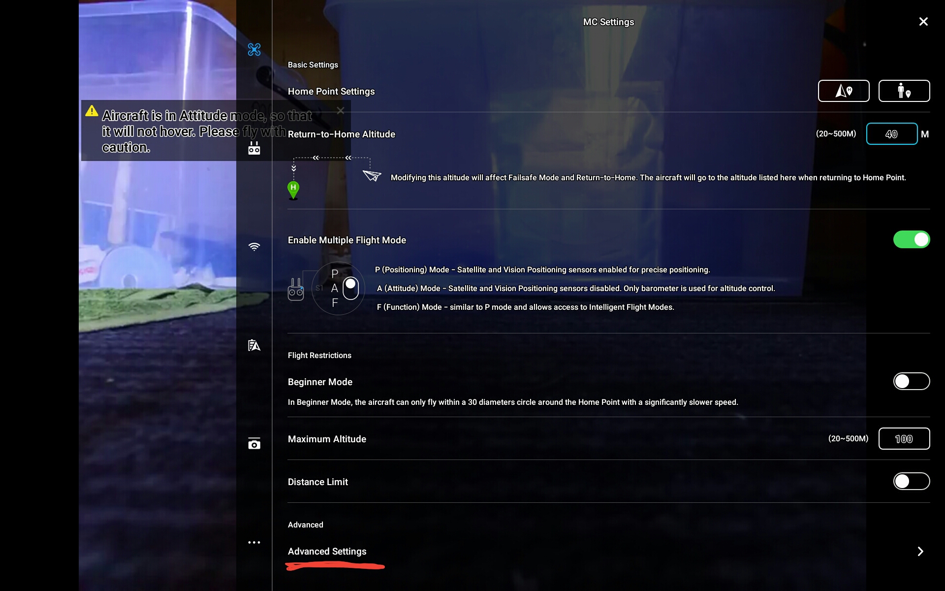

ok so I have never had any luck connecting my drone to my computer. Is this how to check the setting that you are referring to?
Screenshot_20180621-140847.jpg Screenshot_20180621-140911.jpg Screenshot_20180621-140929.jpg :)

I have all zeros I have looked at the wires in the legs they seem intact. How difficult is it to gain access to the motherboard?
