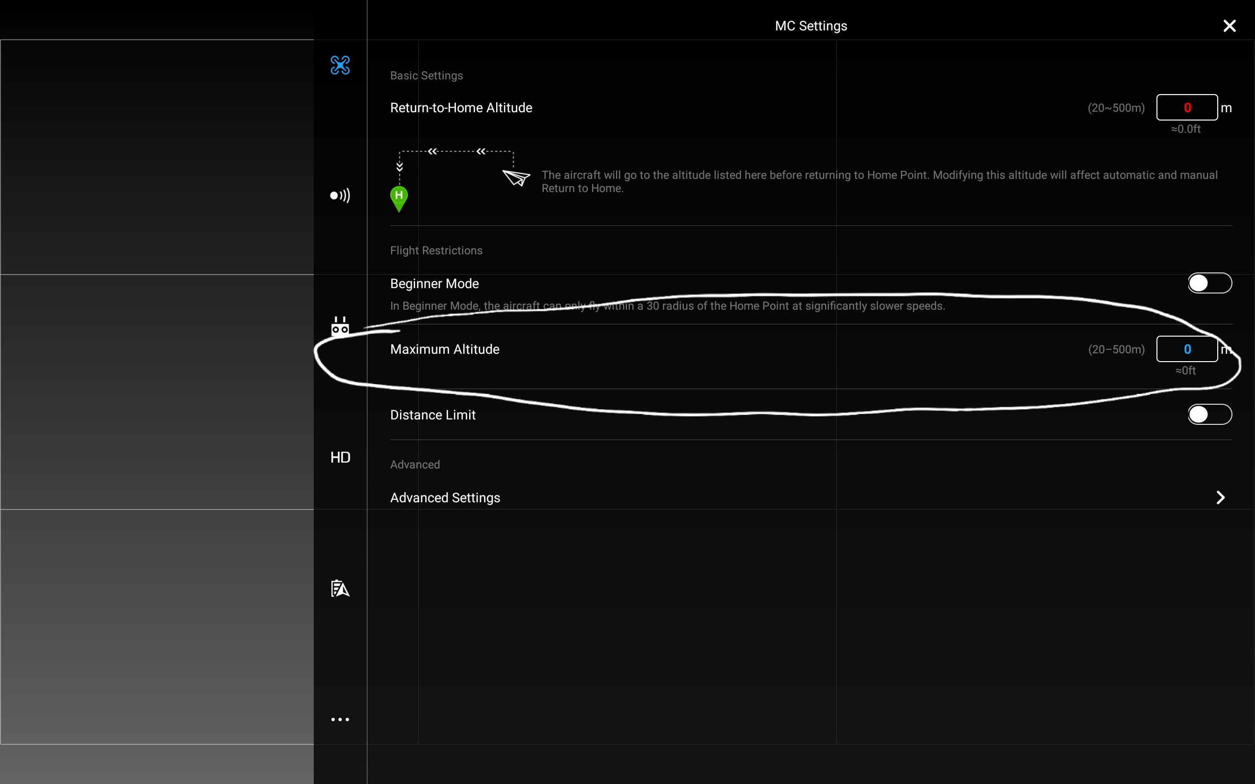

I just checked the settings and max height is set to 500M. When I start up the remote controller, it displays "Height Limited Zone (GPS)" and it alternates to "Altitude Limit 492ft".
Oso mentioned some settings being stored on the AC itself. When I connect, the RTH and Max Altitude read 0. I can change that to another number but when I tab off of the field, the numbers revert back to 0. Am I missing something or am I stuck with this hard coded limitation now?
When you set the max height to 500 m - was the aircraft connected at the time or were you just looking in the app?
It was connected wirelessly. When I connect it by wire and change it, the moment I tab off of the window, it returns to "0".
OK - it sounds like you are in one of the DJI altitude zones that restrict height as a function of distance from the thresholds of airport runways. Take a look at the DJI geo website for your location:

Great news that it was solved. Imagine how much sooner it would have been solved if we had known from the start that you were seeing the message "Height Limited Zone (GPS)". :)
Very true. My first post I was posting from memory. After I tried again, I has a screen shot of the message.
